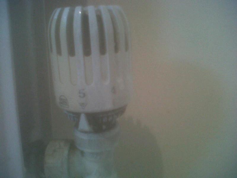

Help removing TRV cap !

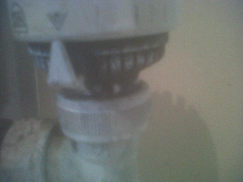

Just use water pump pliers or footies on the gland directly below the black plastic bit mate. anti-clockwise to remove............... ;)
Given the amount of paint on that valve, it may be time for a new TRV??
Cheers for the help !! I have taken it off now and the pin appears to be stuck, it doesn't seem to move at all. Any ideas on how to get it moving again?
Thanks again, Will
