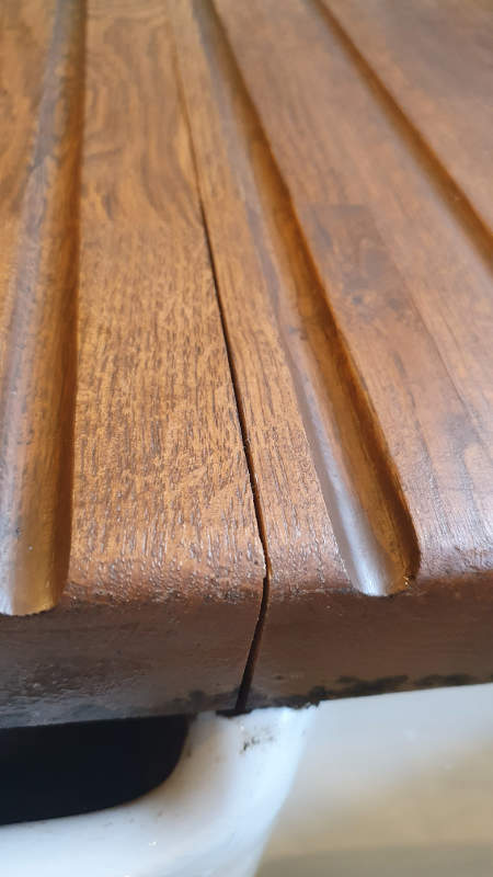

A crack in our solid oak kitchen worktop, fitted around five years ago has just developed. It extends back around 12 inches from the Belfast sink, and the first 6 inches or so looks quite deep, whilst the rest is superficial but looks like it could open up further. It isn't a failure of stave glue as it's in the middle of a stave. The worktop is carefully kept dry and oiled every couple of years with Osmo so it's rather disappointing and quite sudden.
Replacing the worktop or removing to glue and clamp it really isn't an option so what's the best compromise repair in terms of ease of use, preferably one that doesn't require sanding down the entire worktop again afterwards - I've sanded it down a couple of times in the past when reapplying Osmo and it knocks the kitchen out of use for days which isn't ideal just before Christmas. I also don't want to do anything that might make it worse, or make a subsequent repair more difficult if Plan A doesn't work out.

If you can't get underneath to insert some butterfly/bow tie ties, then one at the end may do.
Diagonal dowels from the top may be the another option, and flaunt the imperfection.
PVA if you can clamp it up, or PVA and saw dust if you can't. Or route a strip in.
Looks like a crack along the glue line to me
If you have a solid wall opposite, you might be able to use a length of say 100 x 50 timber, something to spread the load and a wedge to apply the pressure to close up the gap.
Dont forget to unscrew anything holding the worktop.
To repair use some glue, say PU or D4 pva - try and force as much into the crack as you can using the glue bottle, then blow hard with a straw or a new uncut nozzle from a sealant tube - to force it hard in.
If you can close up the gap by wedging from an opposite wall, I would open up the crack by banging a timber wedge in from the end, to get more glue in.
I guess if you have access you could fit a worktop bolt from below - they need a 35mm drill bit and something to cut a slot (a row of 12mm drill holes would do)

Like the other say, that is a glue line that has broken as the wood has dried out slowly. it is much too straight and vertical to be a shrinkage break within the wood.
It needs a sash cramp to pull the front and back together or it will always be loose and try to crack more.
indeed iffyou follow the crack back you can see unusually the staves join either side off the crack about 12mm different on each side
As the OP mentioned he cannot clamp it although there is a little used old fashioned method that is effective at this type of end grain situation and that is to use Pinch Dogs, readily available and i would definately pre-drill first as the last thing you want is to split it elsewhere. Get plenty of glue in the crack, mark the locations and then pre-drill for the dogs ( i would go with 3 or 4 inch versions so you are not anywhere near the split) and gently, very gently tap them in and keep an eye on it moving together. If it needs bigger pilot holes then drill them and just take it easy.

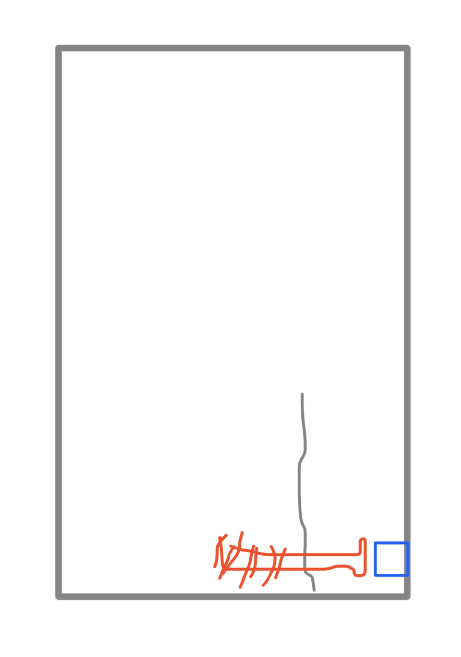

Depending on how far from the room facing edge the split is, you could certainly look to pre drill the worktop from edge face towards wall, and install a partly threaded screw that will pull the sides together as it tightens. If you drill a recess hole big enough to accommodate the head (and you can shave the head down if needed rather than making a massive hole in the edge face) and deep enough that you can install a plug of wood over the screw head then you won't see it, and if you can get a good grain match with the plug it will blend in well
Look up plug cutters (just need some scrap oak; try a local woodworking shop?), the rest is hopefully obvious
Blue is the plug covering the screw head which is pulling the sides together. Same idea as the other mentioned methods of pulling the sides together
