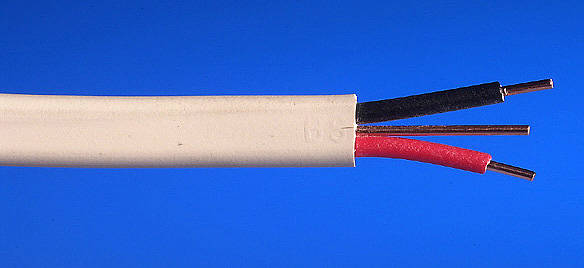

The bare core should be sleeved green/yellow.
The green core in the other cable - is it really 100% green? Has it been sleeved that colour by somebody or is it sleeved within the cable in the same way that the red & black are? Is the outer sheath grey or white PVC, or black rubber?

You have two twin & earth cables going to the switch - each one has a red, a black and an unsleeved earth.
