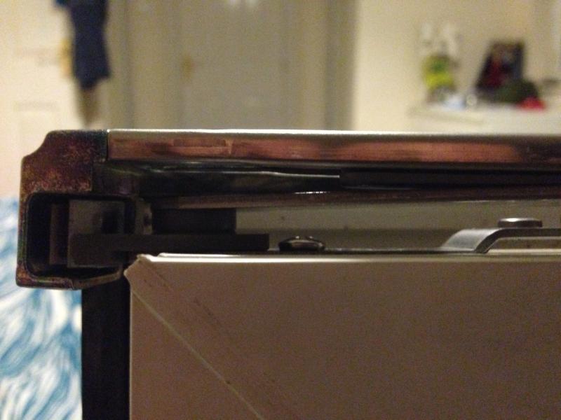

This is the hinge I have bought
http://www.toolstation.com/shop/Iro...re+Escape+Hinge+300+x+17mm/d170/sd3183/p11278
The bit that attaches to the frame fits snug into the side of the frame and all the holes line up ok.
I have attached the sash to the other bar using the first screw nearest the hinge pivot point only but am struggling to adjust it so the window closes. With an inch to go, the window gets stuck.
where should the bar that attaches to the sash be placed? (ignoring any holes from the previous hinge)
There is about 1cm of adjustment on the first screw location - If i pull the window closer to the hinge pivot it starts to hide the triangular locator - if I push it away from the pivot - the handle fouls the fixed window.

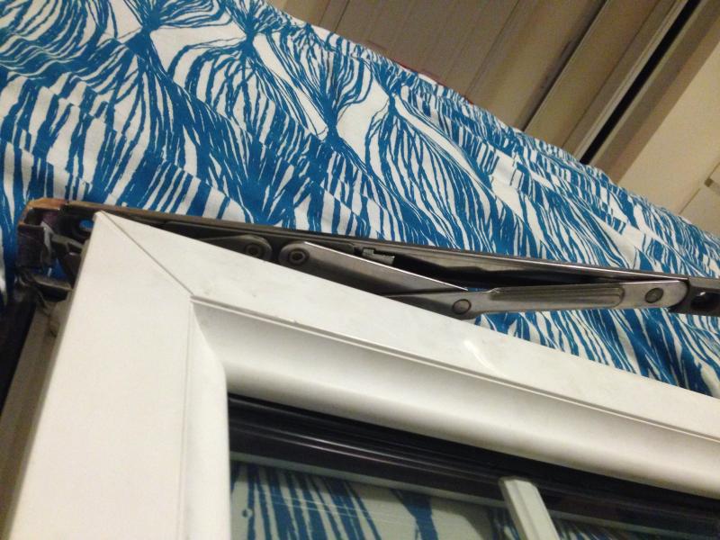

Even while out of the frame , the hinge won't close past the point in the image without a firm push. Doing this then splays the hinge open before it closes.
You can see in the picture of the locating block that the plastic is riding down the spring bit before seating itself on the marked patch where it rests, and is also bending the hinge. When the hinge is fixed to the frame it obviously can't bend - hence I have already broke the end piece clean of of the first set of hinges I bought.
Got to be the hinges - fitted the non egress ones I had for another window and closes first time!
DH
I first mounted the second set if new egress Hines the way you said to - turned out as pictures above.
Then fitted the standard hinges I bought for the downstairs window in the exact same way. When the locating bit touches there's a bit of resistance, but it pulls shut without excessive force and no feeling of things being ground together.
The new hinges must be faulty. It's like the plastic at the end of the hinge is blocking the travel of the hinge.
