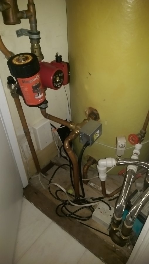

As above, I'd suspect a lot of air in the system. Possibly travelling round, then getting locked into the hot water cylinder coil from time to time. Bleed all air out of system, including coil. System off, start at lowest floor, bleed radiators, bleed cylinder coil. Start system, run for 30 minutes, repeat until quiet.
Incidentally, you mention the "bottom feed from copper cylinder". The hot water comes from the top. The bottom inlet (not coil) is the cold water going in and should always be cold.
And as a side note, a few years back, our 3port failed over Xmas! So, it failed but still allowing the boiler to heat the hot water cylinder. With no chance of getting the part for the failed valve I moved the manual leaver to the open and locked it in, then adjusted the balance valve on the hot water return ( almost shut). This did the trick of keeping the heating on and no need to mess with the hot water tank stat.
