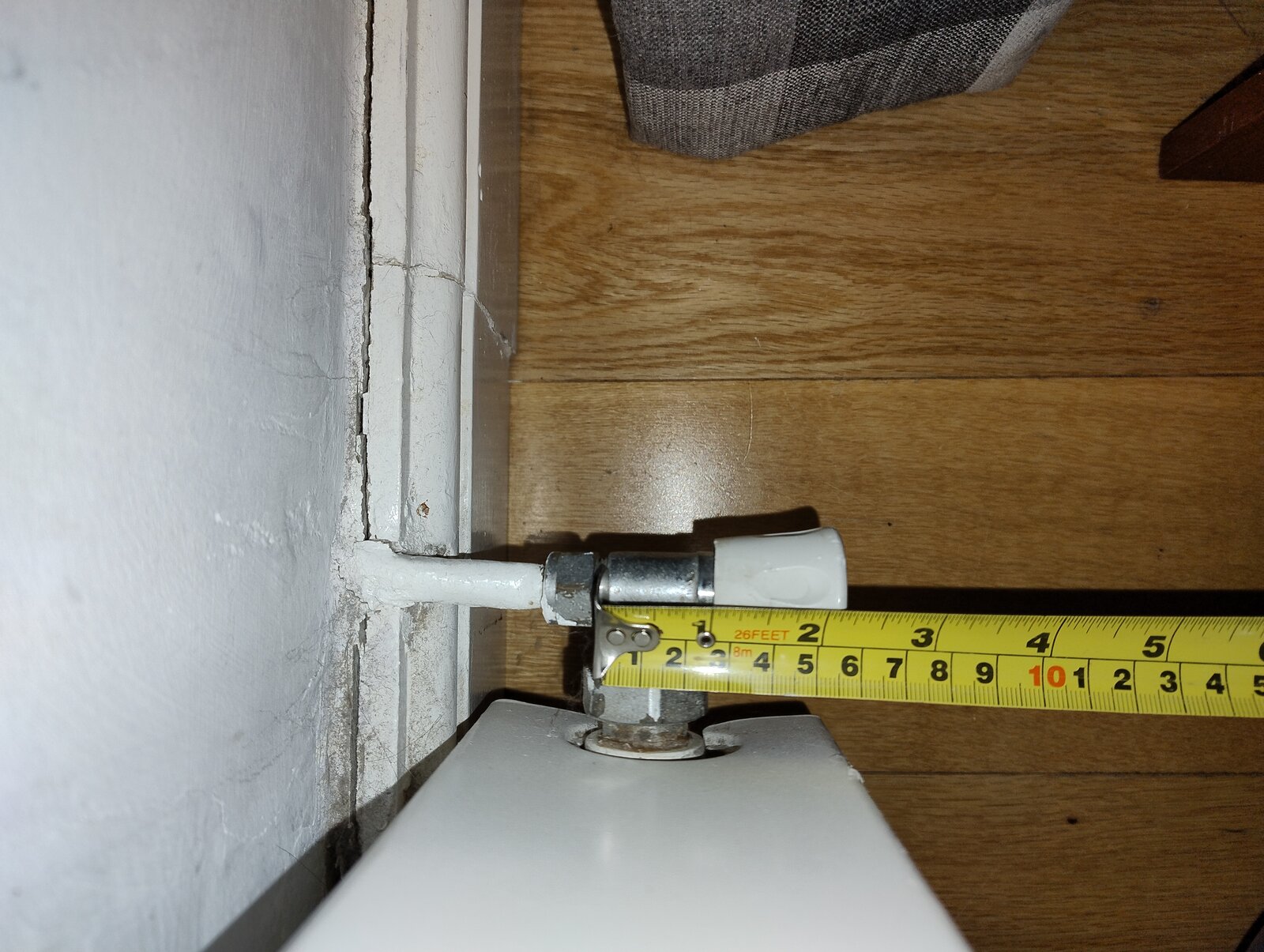

Hi all,
I am looking for a bit of advice please.

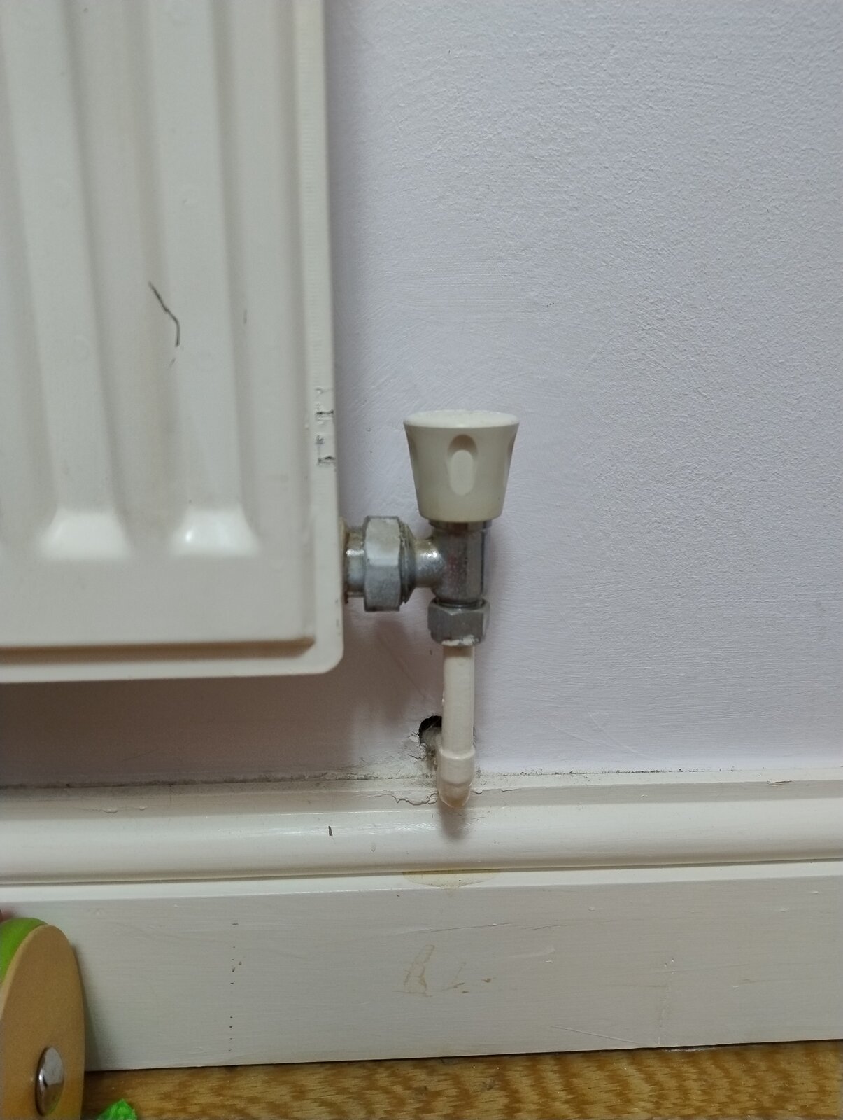

I recently moved into a late 90s built house and want to replace a radiator. The existing radiator was a bit of an odd length so the one I have purchased to replace it is approx 180mm shorter, so I am looking at needing 90mm extension each side to connect to the original valves.

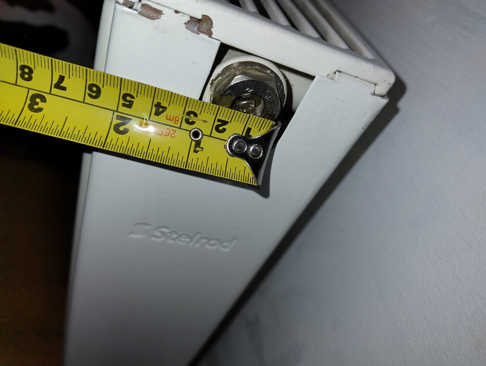

After examining my existing valves I'm a bit confused. I have microbore pipe from the CH system to the valve, but I was expecting 15mm connection from the valve into the rad. Obviously I can't see the pipe from the rad to the valve, but the nut looks much bigger than 15mm
I've done this exact job in my previously house, but that was simple as buying a 15mm extension from the rad as the TRVs I had were standard 15mm each side.
Can anyone explain what I am looking at here? What size pipe is that nut for? And can anyone point me in the right direction as to how I find a suitable extension?
I know I am now being particularly clear, so I have included some photos.
thank you

the connection on you new and existing rad are 1/2 inch the valve.are you replacing the valves or reusing the existing?
rad extension in lengths are available with 1/2 inch threads but will look odd

Are you saying that the existing connection in to the existing rad is definitely 1/2 inch? If yes, why is the nut so big?

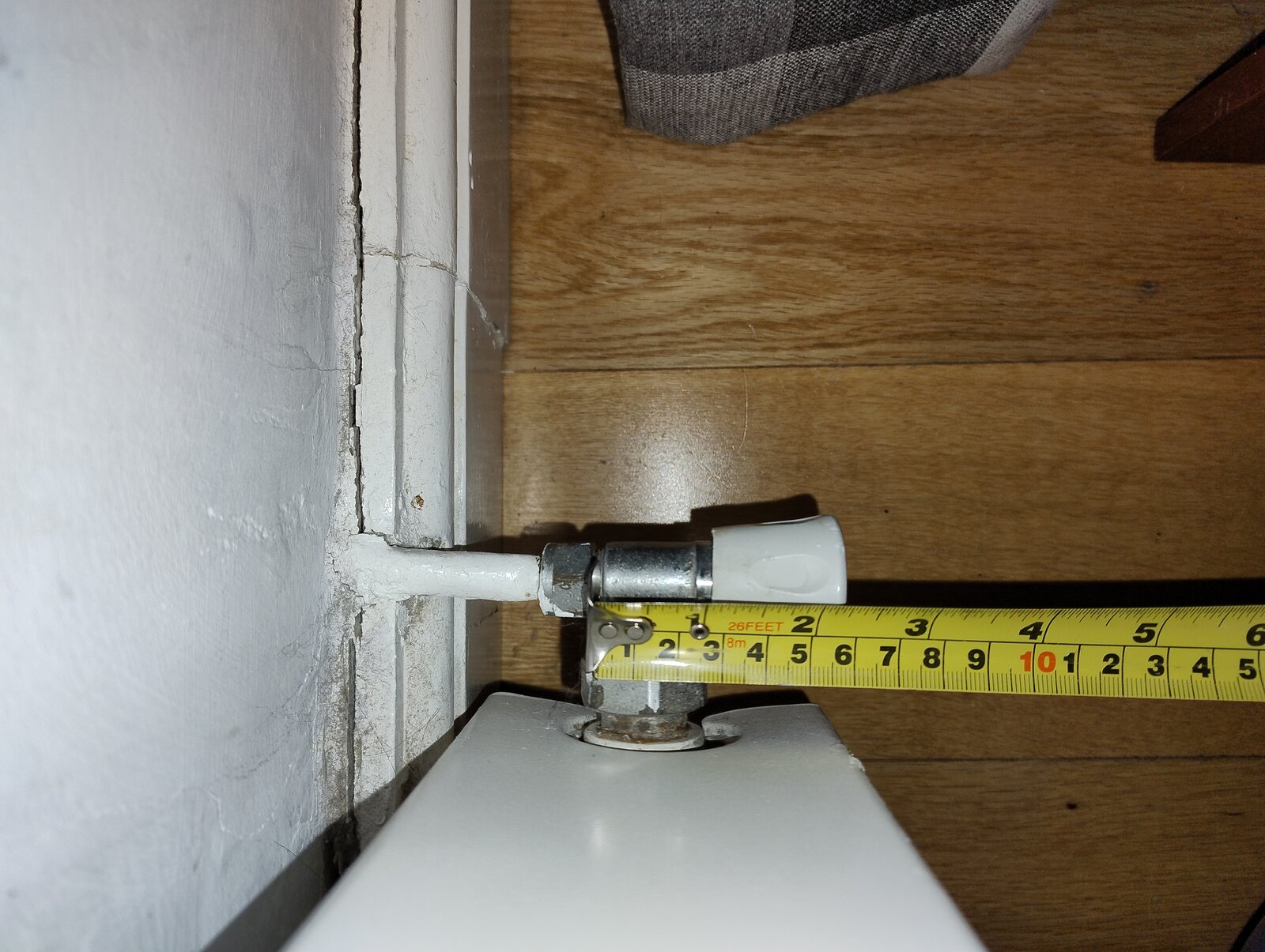

Take another pic of the radiator valve ,without the tape measure. It looks like the valve has a 3/4 inch union fitting to the tail.
Why didn't you buy a wider radiator, 180mm difference isn't going to look pretty ?
Please see another pic below.

What is the horizontal distance, centre to centre, of the existing pipes as they enter the valves?
The valve tail is definitely 1/2 inch
Quite right , the tail is ¹/² inch, but the tail to valve connection is 3/4 union.
As the OP wants to retain the existing valve and connect it to an extension, that will require the extension piece to be 1/2 inch male at one end, to connect to rad ,and 3/4 female union at the other end to connect to the existing valve.

Thank you, that's helpful. Do you know if there is an option to cut down an extension to my requirements?
Use a reducing insert on the rad and then pipe away as you need. You could use a straight through rad valve perhaps to make the overlength a bit more visually appealing.
Wouldn't bother with an extension. They are chromed and will look silly next to the duluxed piping.
