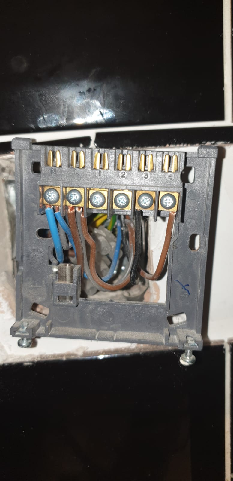

I have removed the programmer (FP/CP715-Si) from the wall and it shows the following wires (please see attached image)
3 x going into live (L)
3 x going into neutral (N)
1 x going into DHW ON (3)
1 x going into HTG ON (4)
I have a combi boiler on the ground floor with a hot water tank on the first floor.
I believe the 3 L and 3 N to go to the L and N on the Nest heat link. The DHW to 6 on the heat link and HTG to 3. However, the 3 L wires and 3 N wires dont fit into the same port.

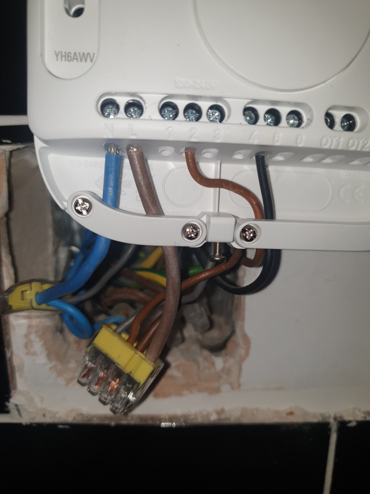

join the 3 wires into a terminal strip connector and take a single wire out of the other end to the hive
Thank you, ive done that and it lights up but it doesn't seem to control the heating
So the first picture is what my heating system looked like before hand and the second shows what has been done to get it to turn on. I've connected the 3 live into a 4 port push in connector and then I've rang a wire from the 4th port into the nest heat link, I've done the same with neutral and then HTG to port 2 (didn't work in port 3) and DHW is in port 5 (didn't work in port 6).
The heat link lights came on and I connected it to the thermostat but no heating. When you turn the manual button on it doesn't turn the heating on at the boiler.

Move HTG back to 3 and DHW back to 6 - that's where they're supposed to be. You need to put links in between L, 2, & 5
