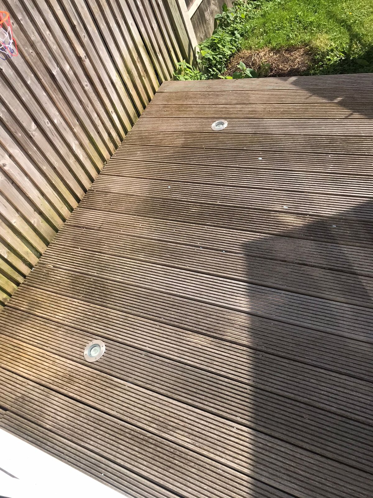

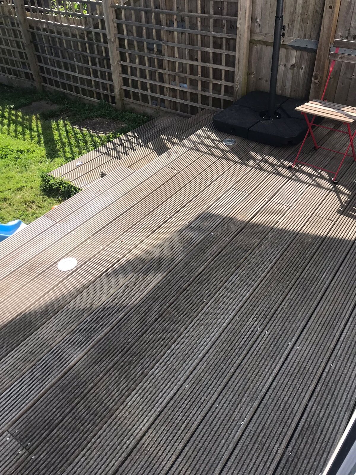

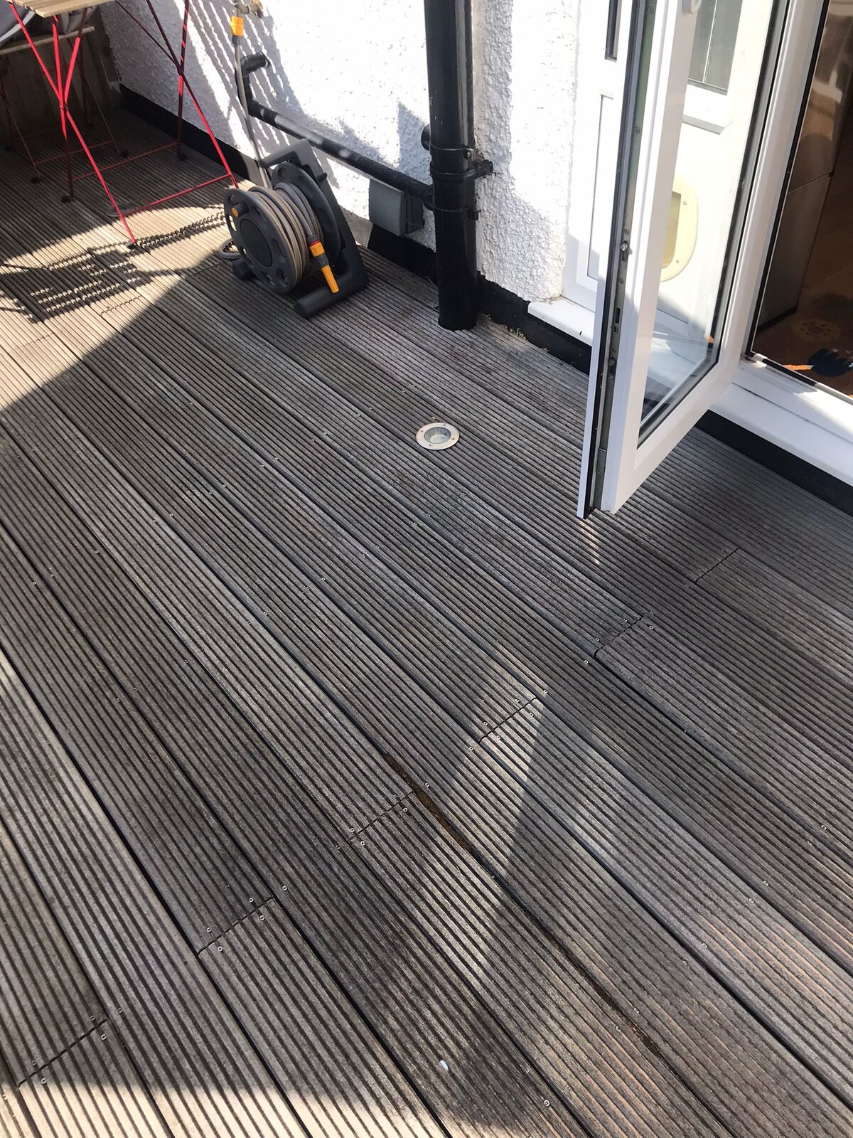

Hello,
Recently bought a house and a neighbour told me that my patio needs to be repainted/reoiled. I am new to DIY and have no idea what kind of wood patio/decking I have teak, cedar, oak, pine or other types? Please could someone have a look at the attached pictures and help to identify the type of the wood?
Also I want to clean it first with pressure washer and then apply oil or paint (UV lights and moisture protective) What is better oil or paint and what brand should I look for?
Thank you very much in advance
Pav

It will more than likely be tanalised pine, but can you get a picture of the end grain so we can be more sure. very very unlikely it is a hard wood
if it is what I guess then lightly scrub the surface with a well diluted 'thin' bleach to remove any greeness then re-oil with any decking oil. (I wouldn't pressure wash wood you will damage the surface, esp if you have a decent power washer)

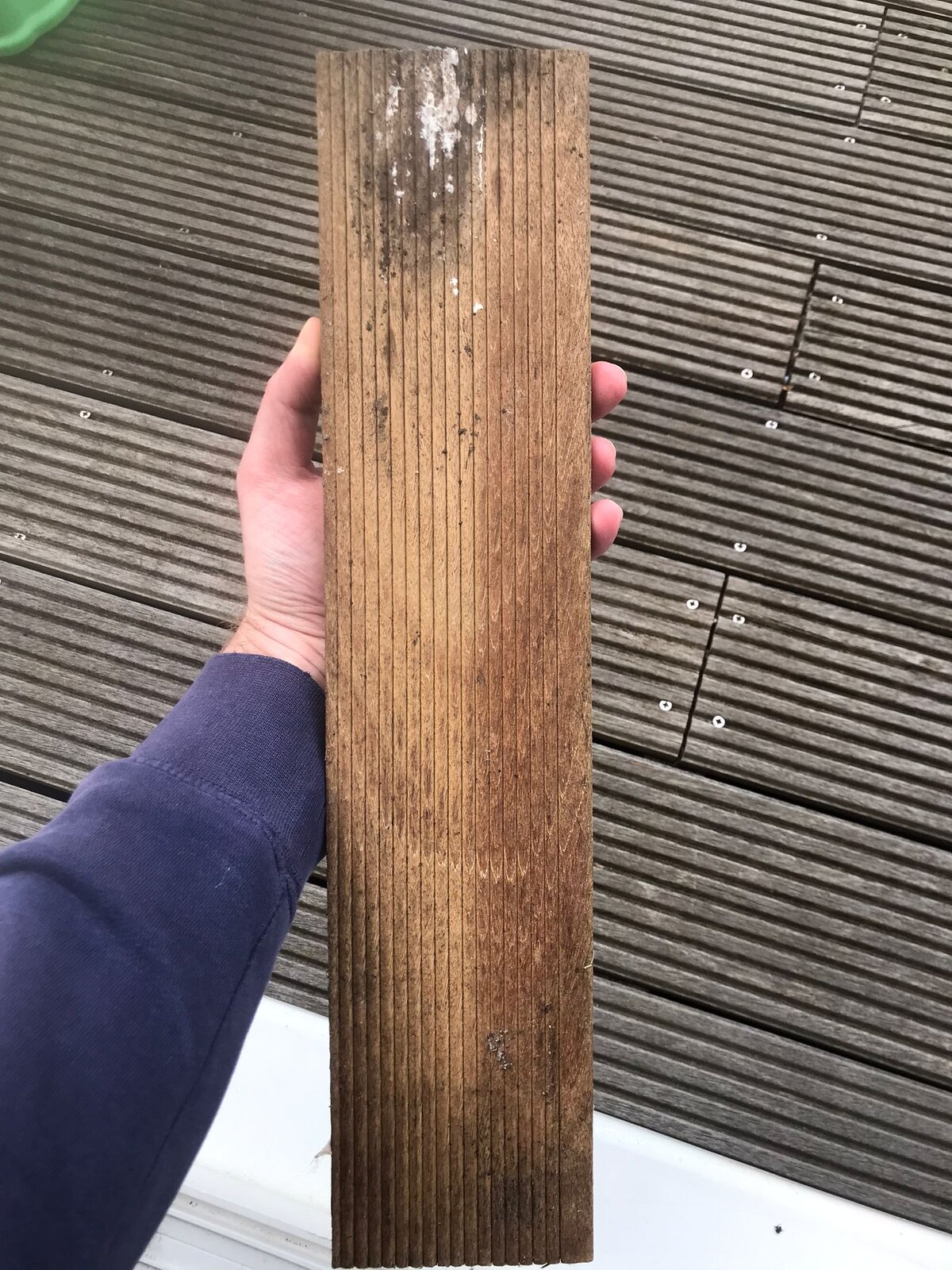

Thank you very much Eric, I had some parts of the decking that are not screwed and lifter them (please see short video attached) not sure if they are good or bad. Anyway i will treat the decking then but how long the wooden decking will last i guess no one knows as it can get rotten fast i believe.

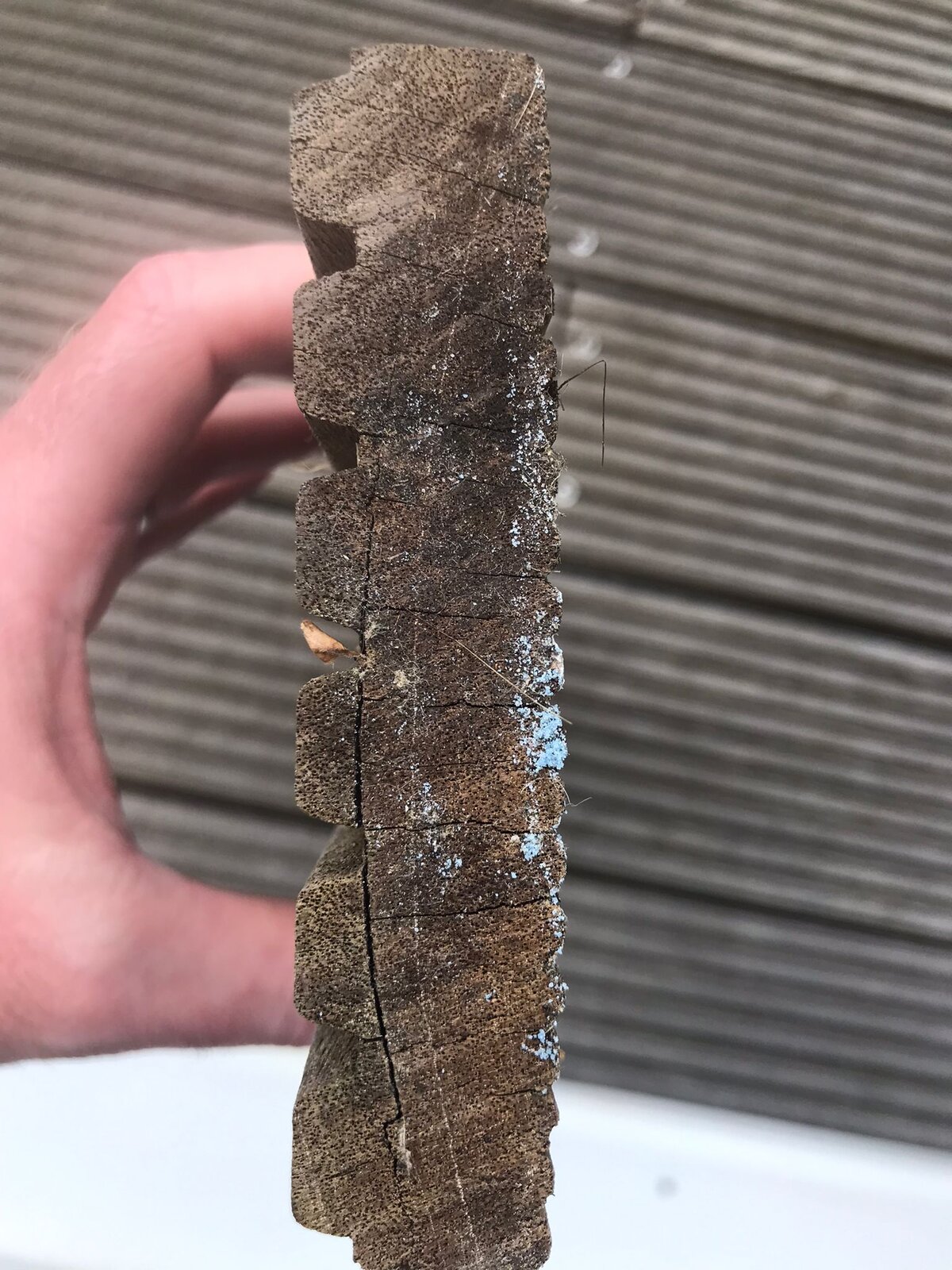

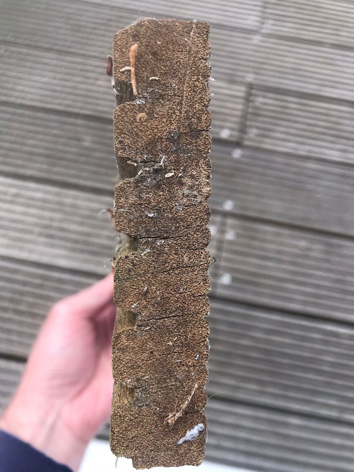

Thank you very much Munroast, yeah i've had some parts unscrewed please see attached pictures of the end grain. Ok understood i will use a well diluted "thin" bleach but diluted with water right? and will use any decking oil. Yes pressure washer is Karcher K4 - 130 bar. Maybe i'll try on a small part and see what happens.

difficult to be sure what type of wood that is, you would need to cut and sand so we could see the end grain - doesnt matter, it will almost be certainly treated softwood, and if it is tanalised and just subject to rain water (not stood in permanent dampness) then it will last decades.
Oiling them just gives them a nicer appearance and possibly slows down the slippy green stuff that likes to make decking dangerously slippy.
I just use thin bleach (mixed may be 20 or 50 to 1 (I just slosh some in a bucket and then fill it with water) dampen the decking first then brush in the diluted bleach into the wood. do it on a damp but not raining day to gave the bleach time to kill all the green stuff before it dries. May be rinse it off with a hose the next day.
VERY IMPORTANT - don't mix bleach with soap, it can gave off chlorine gas which is the same chemical gas used a weapon in WW1 on the trenches.
