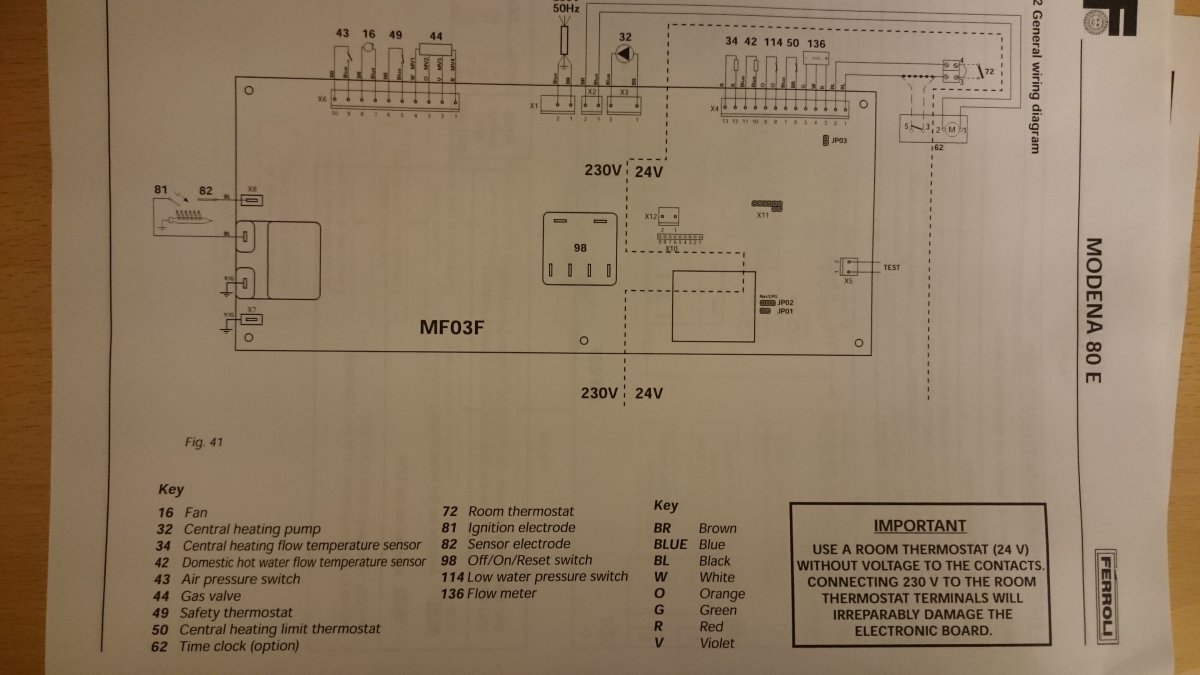

I want to replace my T6360 with a CMT927. The T6360 has only 2 wires connected - Terminal 1 and Terminal 3.
How I understand need to rewired the system. Can someone help me to explain from where I get L and N?
I attached the boiler diagram maybe this help.
