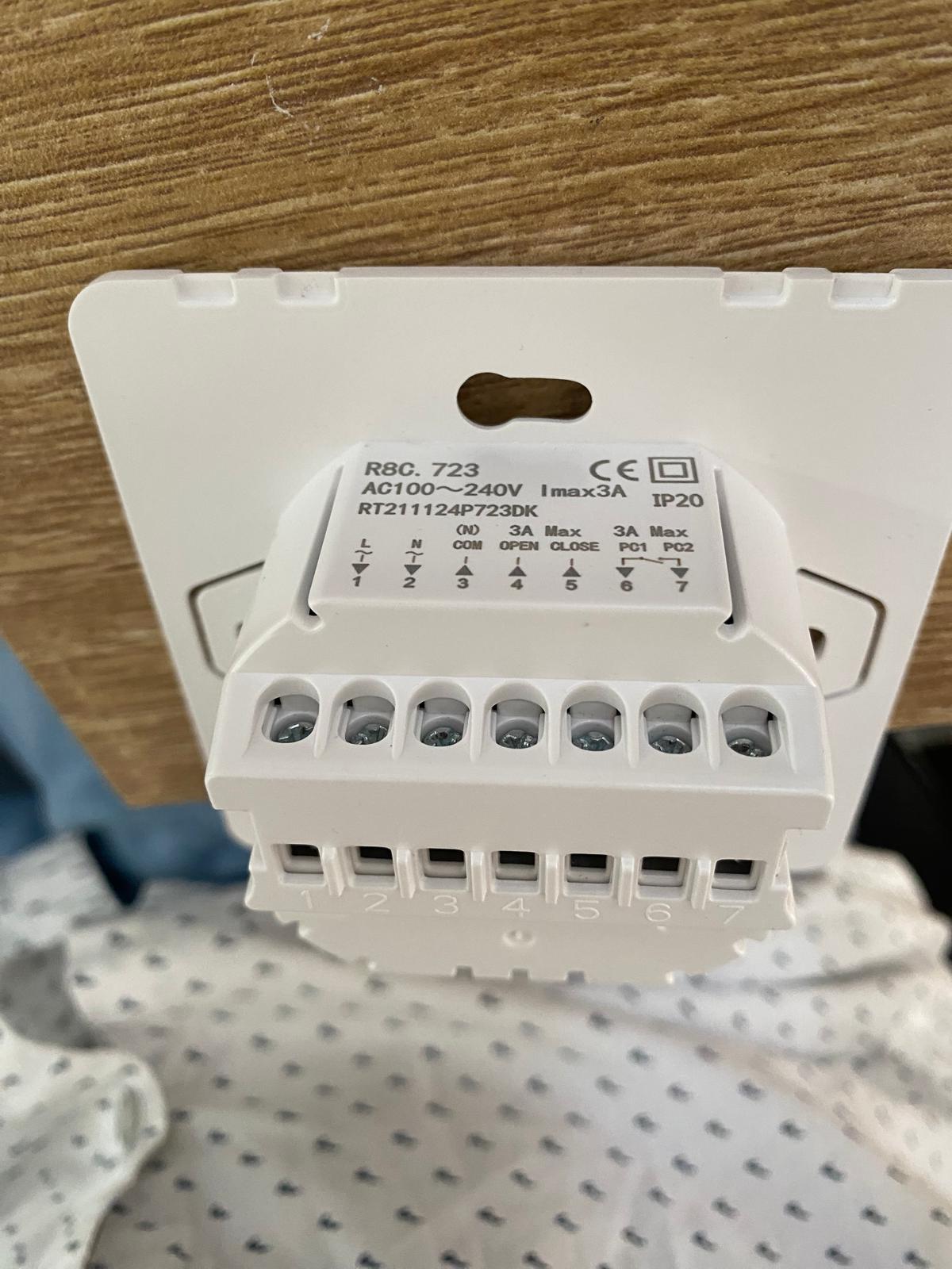

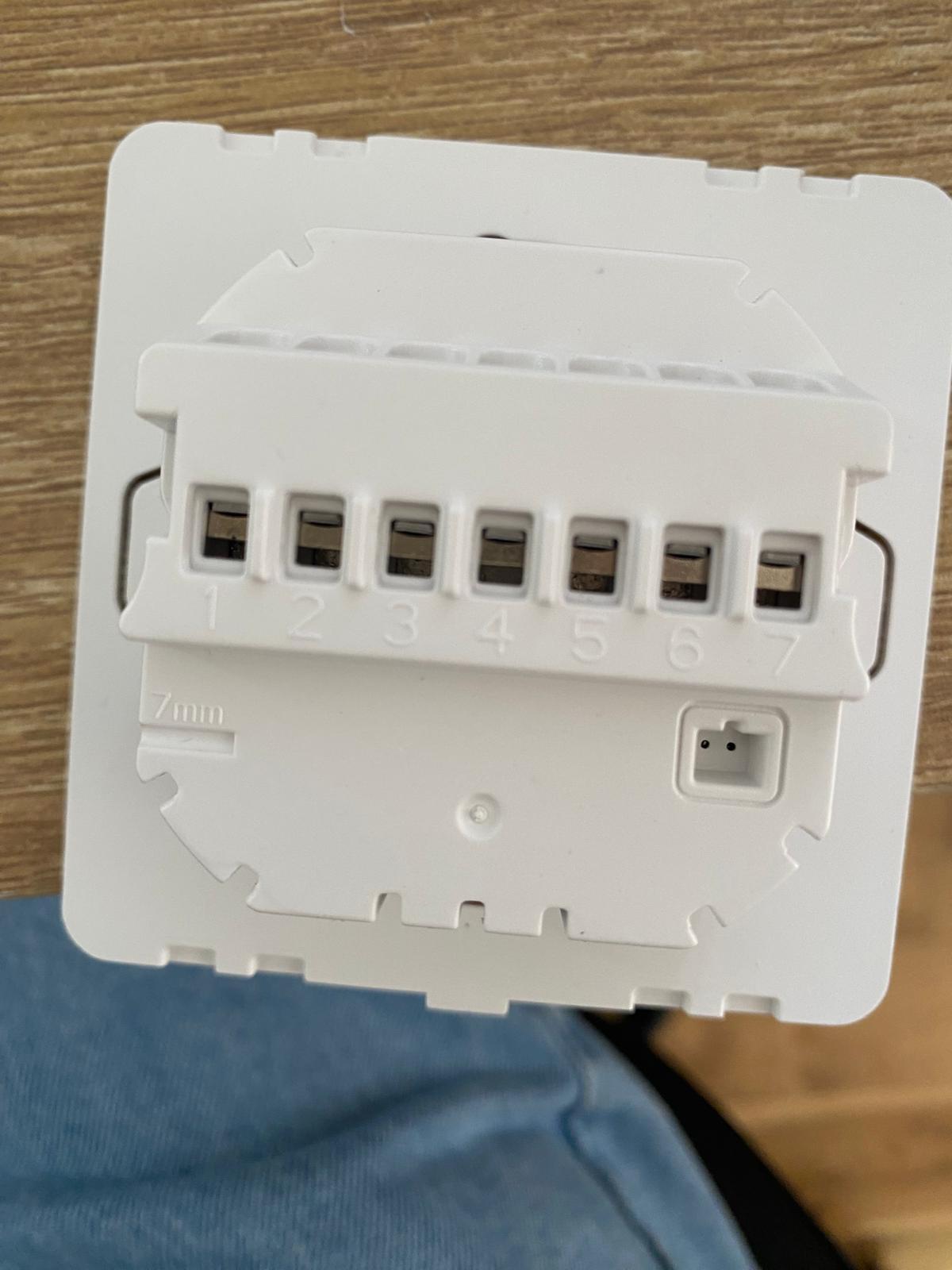

Help! Tuya thermostat wiring for a combi gas boiler - changing from honeywell thermostat to Tuya Thermostat 723 - photos attached
21 Jul 2024

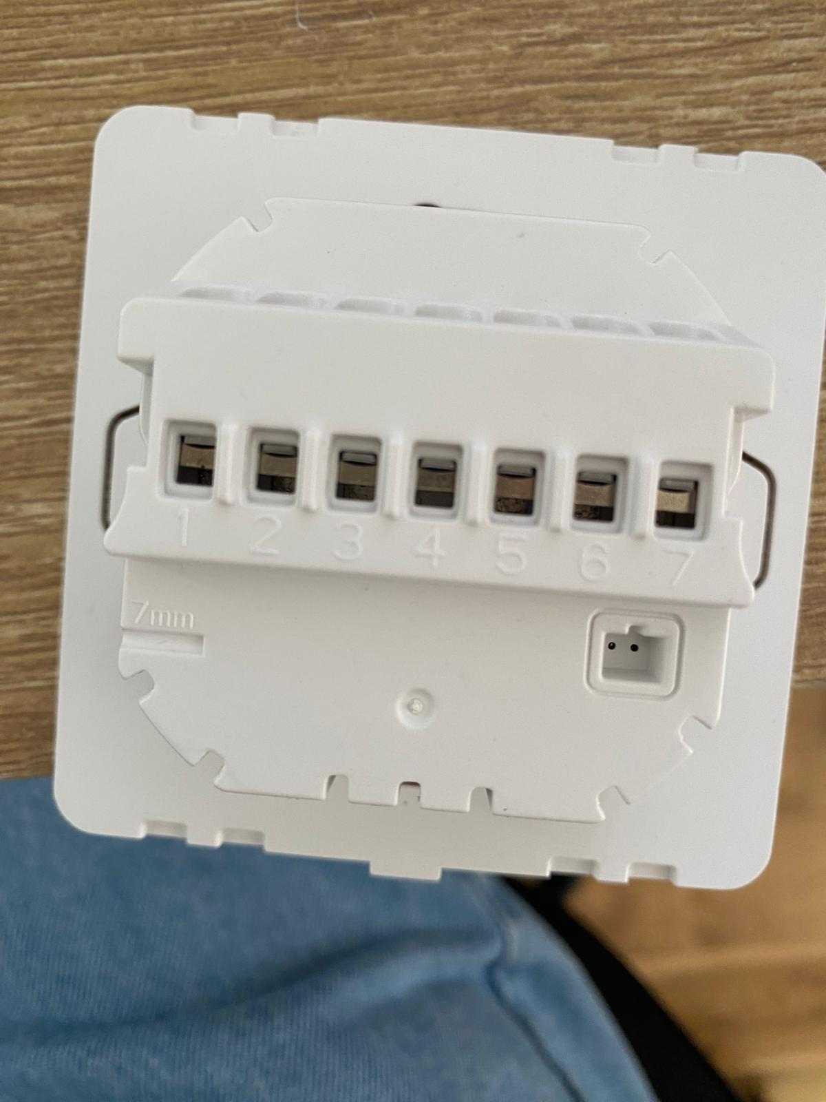

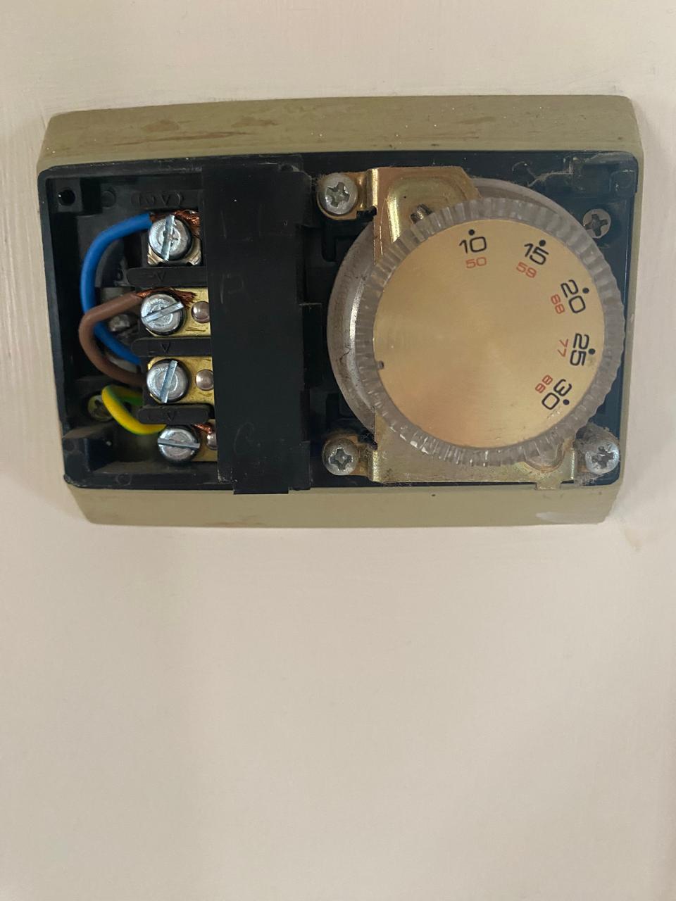

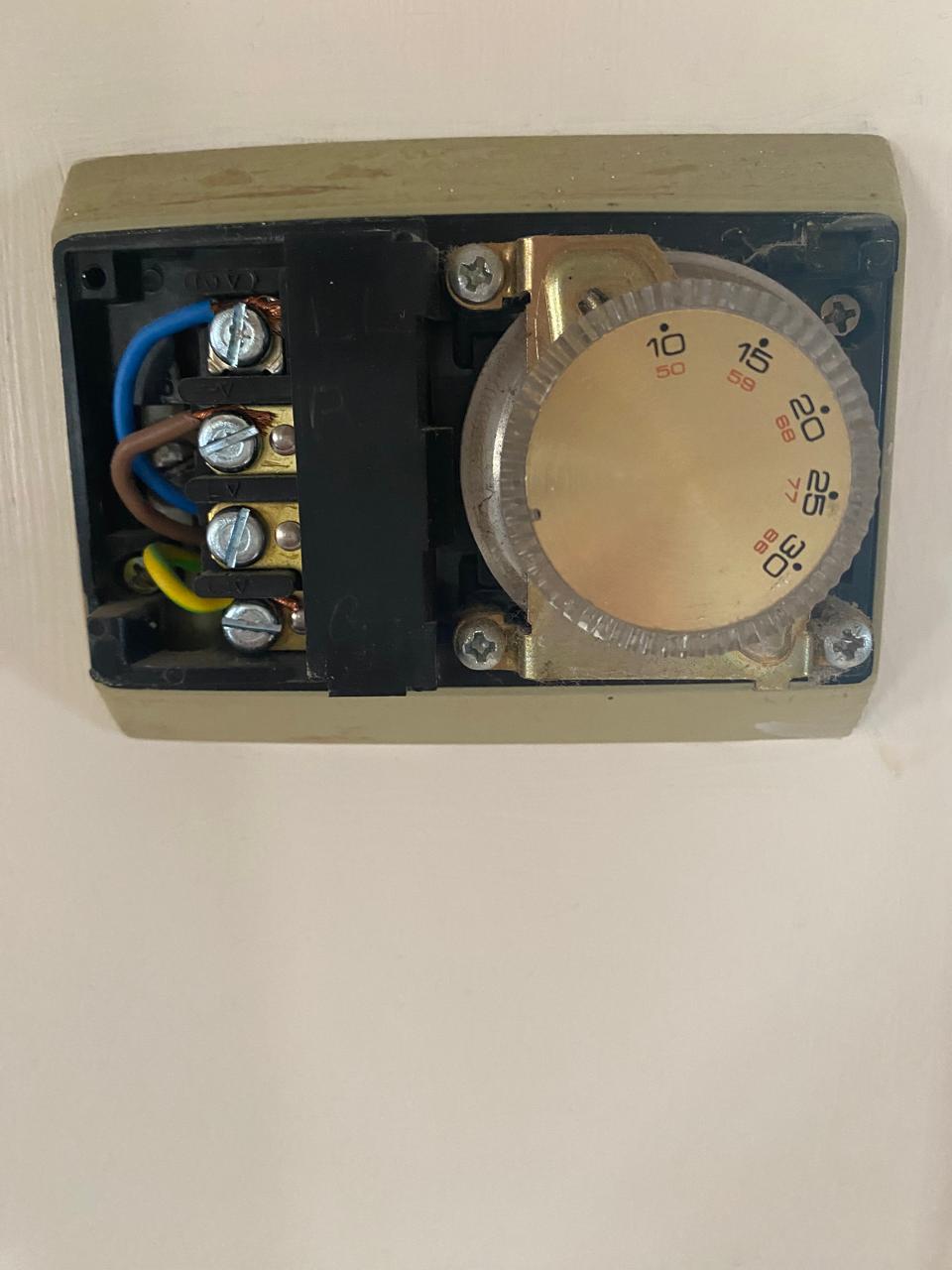

I know simply ther live wire being brown will go to L and Blue wire from the honeywell will go to the Tuya N (neutral) point. However i am confused where to connect the ground wiring for the tuya thermostat. Safety's most important i assume in electronics/electrical. Help please thank you!

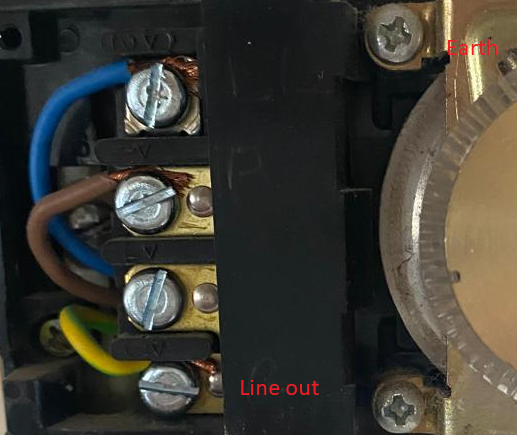

It is class II so does not need an earth.
The green and yellow wire is not earth, it is line out, rather naughty, this has not been permitted for my lifetime, and I am 72, if it were me, I would also be very naughty and wrap it in brown tape or sleeve and put it in terminal 4 and link 1 and 3, but that is not how it should be done.
You would need to run a new 4 core cable to replace the 3 core, and the rules say
A circuit protective conductor shall be run to and terminated at each point in wiring and at each accessory except a lampholder having no exposed-conductive-parts and suspended from such a point.
which since there is no terminal to terminate the earth to, is a bit of a problem, I suppose if a metal back-box then that will have a terminal? The original installer should be taken to court and made an example of, however the courts would be overwhelmed with plumbers.
Now this Tuya thermostat has already caused confusion...
Be careful here Eric, that would cause a big bang!

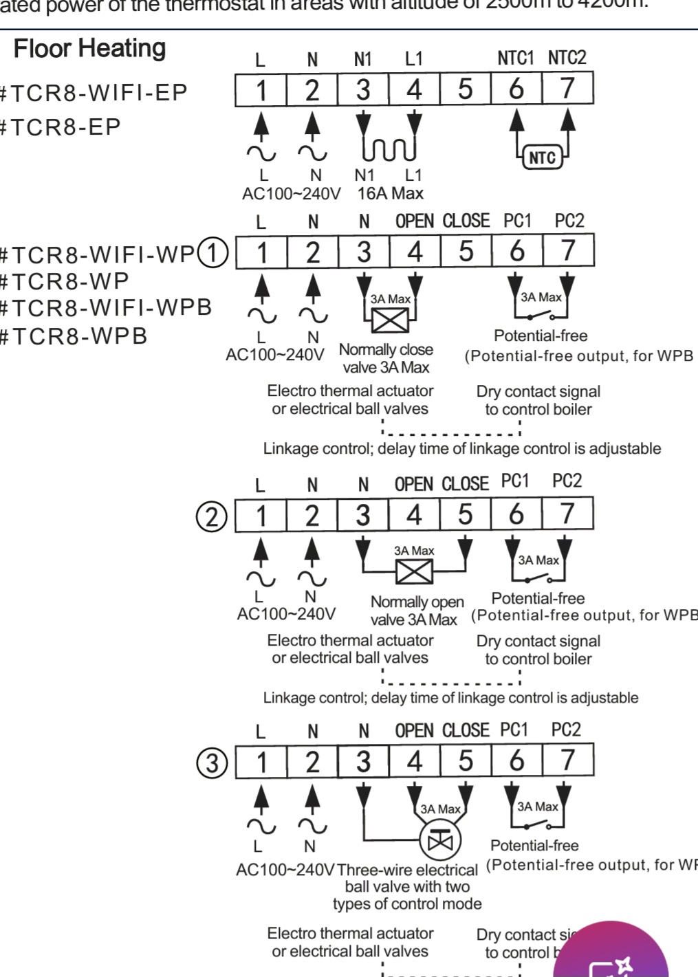

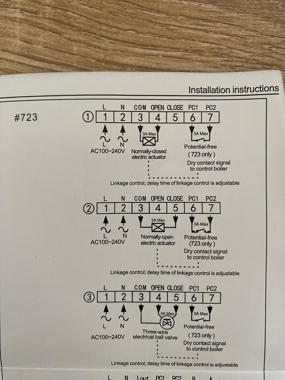

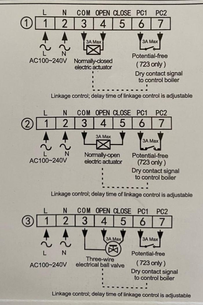

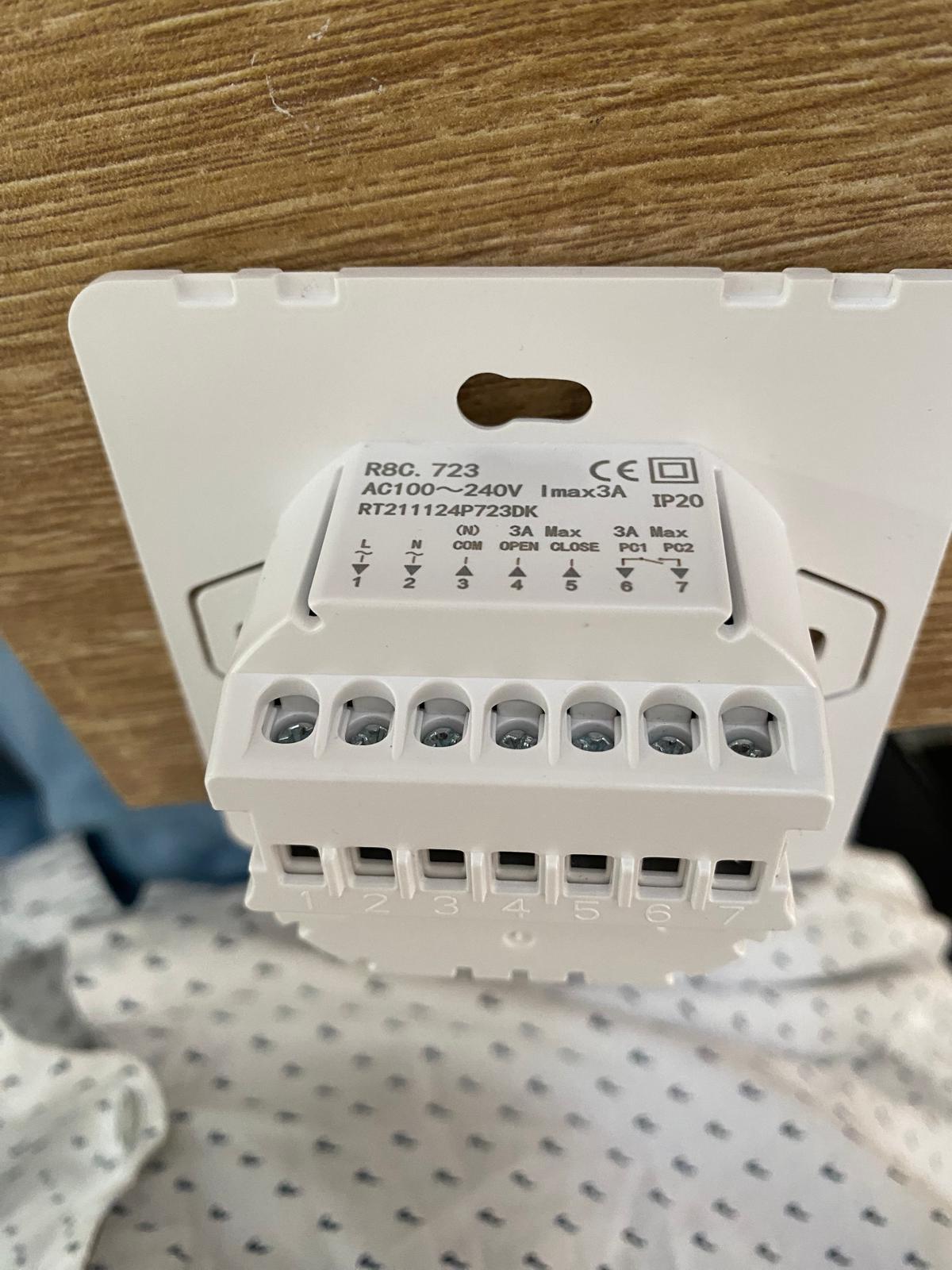

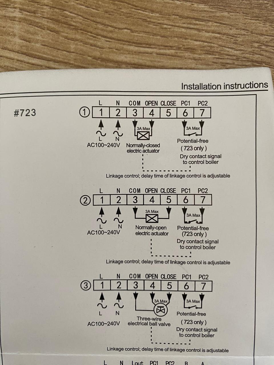

Terminal 3 on the Tuya might be labeled COM, but it is also labelled (N) - it is a Neutral out to power actuators.
The terminals to use are the potential-free contacts 6 and 7.

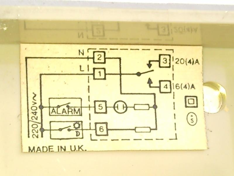

Do you have a wiring diagram on the rear of the Honeywell cover - something like?...
Thank-you, I had not realised this, I had just used the picture shown. cymru am byth
