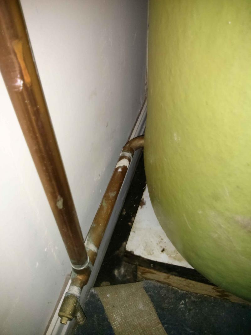

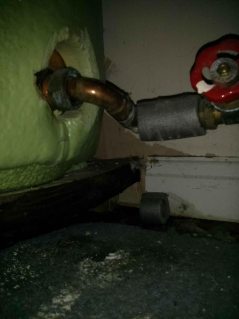

Hi,
Total newbie ! My hot water tank seems to be leaking but very slowly, it doesn't seem to be leaking from any visible joints that I can see.
I say slowly, because been doing this for a long time, and I only noticed when a towel happen to fall down to the base of the water tank and got soaked.
There are no visible signs of water leaking anywhere, the tank is mounted on a bit of wood, and that is constantly wet.
I was just wondered if anyone could suggest a possible cause and solution?

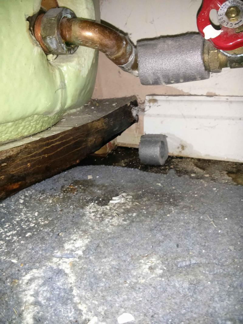

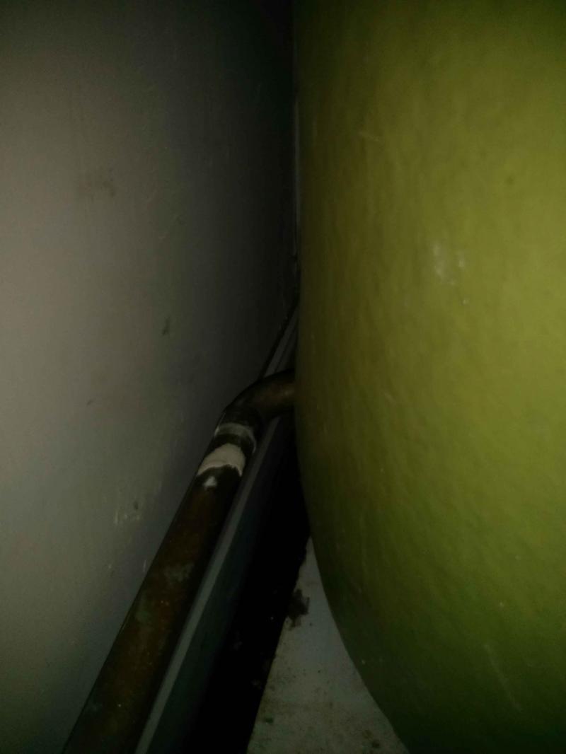

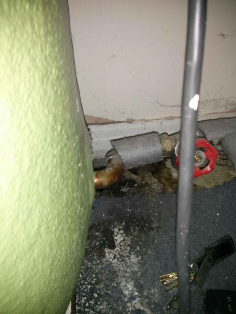

Hi John, from from the pictures, and feeling the cold water inlet, it doesn't seem to be wet, but also from the pictures, it does seem to have leaked though!

Cut some of the foam away from under the cold inlet and see if its wet there.
Same at heating coil connections as well next.
But probably going to be the Base area corroded and leaking.

None of the joints or pipes of the cold inlet are wet, same for the other side as well.
I think that they mostly likely solutions seems to be that the base has corroded! and is leaking

Just looking at that base....is it a piece of worktop? It looks to be in a bad way and the tank needs to sit on something dead flat and smooth.
