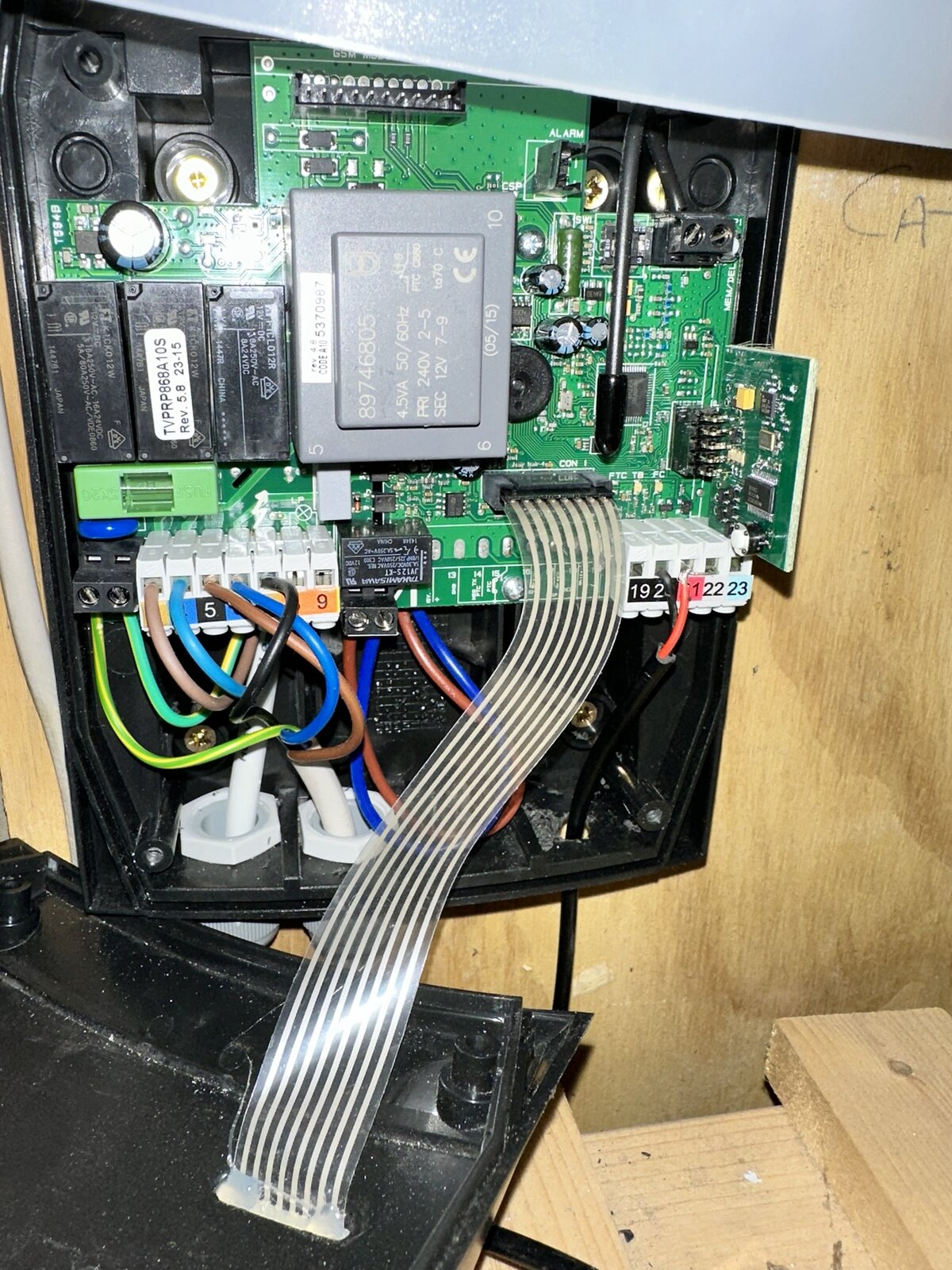

I have a Seceuroglide Roller door which seems to use a Teleco C10 as the radio control box but I am unsure which pins to use on it to open and close.
Here is the box:
I used to have the cables hooked to terminal 20 & 21 which worked fine, but now it is no longer working with the new module.

Looks to me that the contacts should be connected to 19&20.
21&22 for obstruction detection switch.

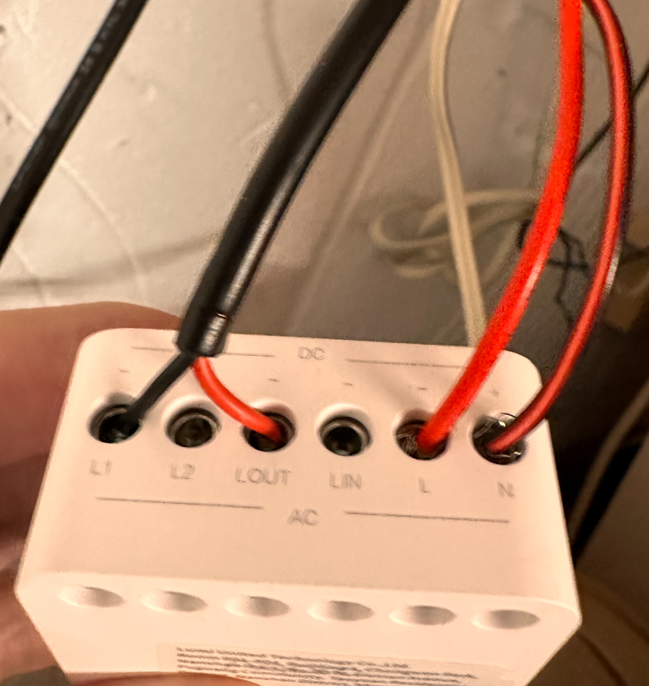

OK, I went for the Aqara T2 - LINK
I have connected a wire to 20-21 on the garage door board and then connected those to the Aqara T2 as follows:
I have control of the door but annoyingly it is reported weirdly in the app. I hit the button which shows 'On' and the door opens. I have to then turn it 'Off' to then turn it 'On' again to close it. Is this anything to do with the way I have wired it?

Is there a pulse setting?
