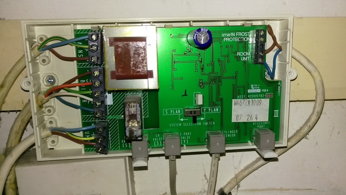

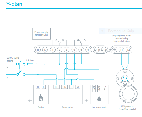

Hi, seen some good help with installing Nests on here so hoping someone can help me too. I'm trying to replace a honeywell Smartfit thermostat with a Nest to control my Glowworm Ultracom Hxi boiler.
I've thought to wire up the heatlink in to the existing wiring centre for the smartfit then detach the thermostat leads and repurpose them for the T1 and T2 connections to put the Nest in place of the existing thermostat. Happy with that bit, got L, H and E across to the heatlink easy enough too and trying to follow the Y plan wiring instructions to get this set up but just not entirely confident with how what I'm seeing matches up with the instructions.
I've attached pictures of the wiring centre I'm hooking up to and the Y plan wiring diagram from the Nest instructions. So far, I have L and N from the mains supply across to the Heat Link. I've jumpered live across to 2 and 5. The wiring diagram seems to refer to colour coded cabling that doesn't match what I have though and, not being an electrician, liberal use of the word "common" is throwing me a bit too so I'd really appreciate some advice on what I need to put to 3, 4 and 6 in the nest. I'm thinking one from the Boiler grouping (White to 3?) and one from the Pump group to 6, then it appears something common to both to 4. I'm just not sure so would really appreciate any help anyone can offer. Even if that is "Stop you idiot, you don't know what you're doing". My assumptions are based on what wiring I can actually see to work with, but I'm also wondering that perhaps it should be the 3 port valve, rather than the pump, that I should be hooking up to the heatlink, which it comes in via the RJ11 port at the bottom of the wiring centre.
Any help would be greatly appreciated and if there is any more information I need to provide, then please just let me know.
Many thanks

Sorry to be the bearer of bad news but the nest is not compatable with honeywell smartfit systems.

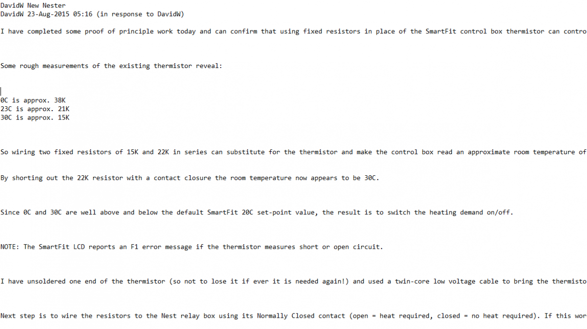

There is a workaround if your reasonable with electronics, there is a thermistor in the Honeywell room stat/programmer that you can fool using a couple of resistors and a relay controlled by the nest, there is a blog somewhere on the nest site but I cant find it at the moment.
That sounds interesting, thanks, I'll have a look for that myself too.
Hello again. Other projects meant this took a back seat but I'm hoping to revisit it. Unfortunately, couldn't find anything on the thermistor hack mentioned by picasso.
Would really appreciate if anyone has any pointers on that, or any other practical suggestions as to how to best go about this.
Failing that, thinking to possibly ditch the smartfit altogether and replace with more bog standard wiring centre, 3 port valve and cylinder stat.
