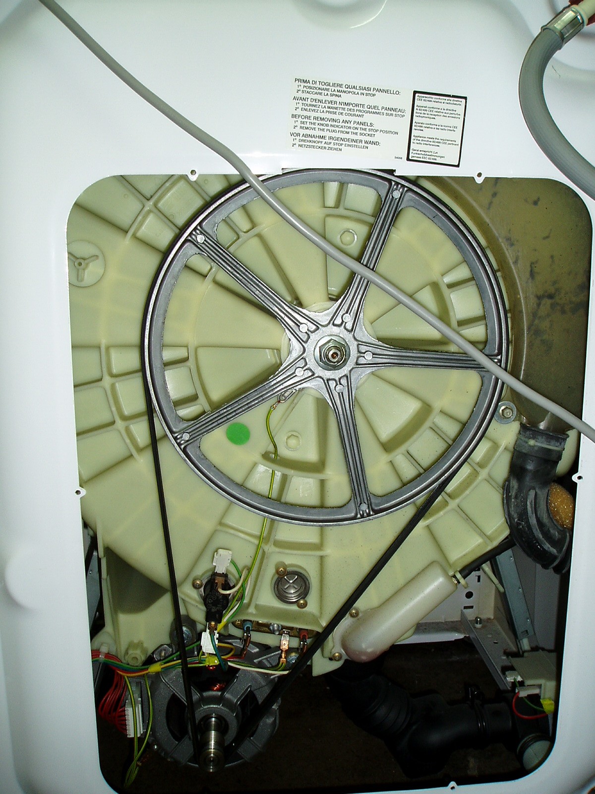

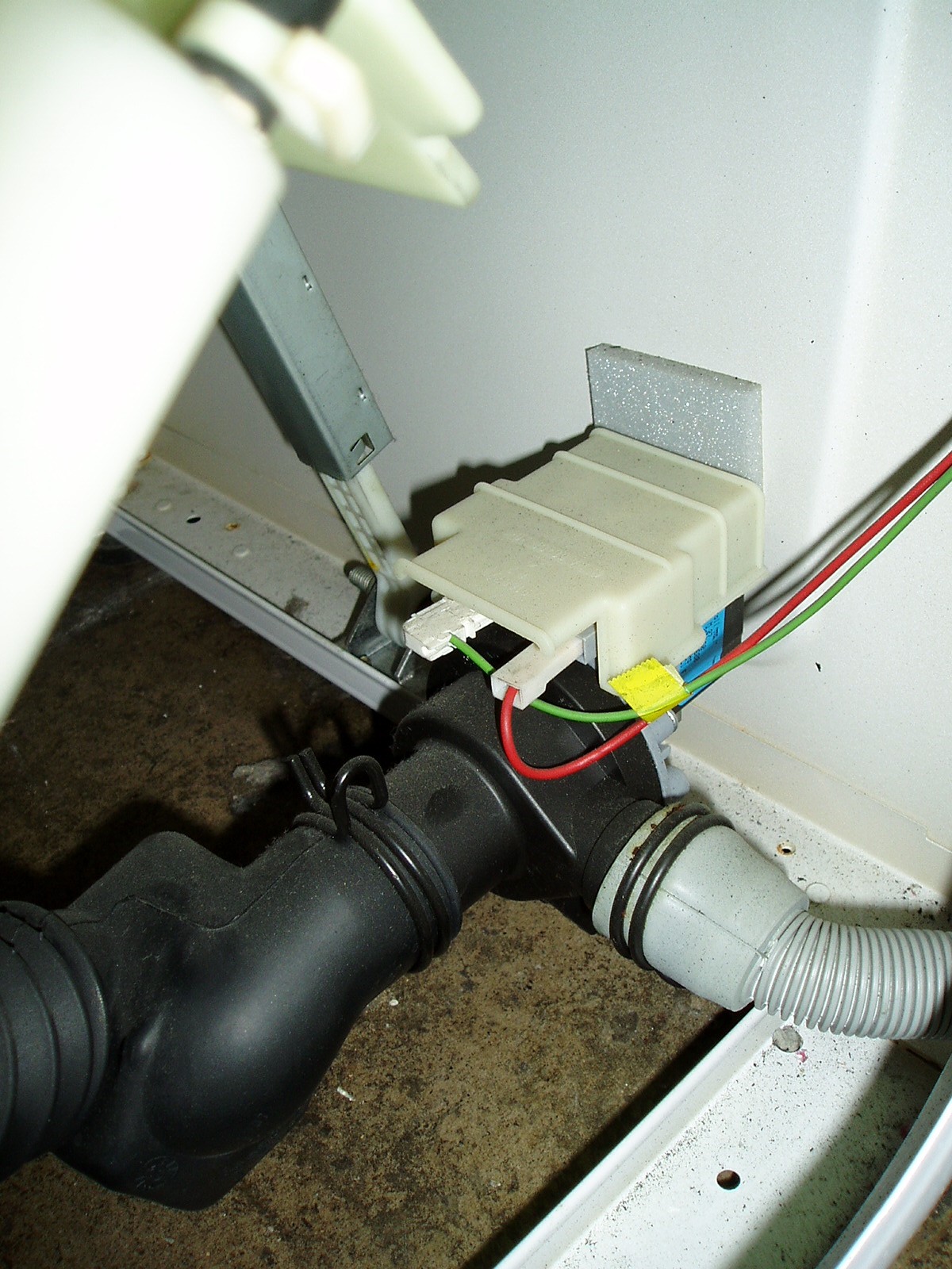

My 2005-vintage Hoover Performa 1100 washer dryer* (used once per week) has always worked well but last week it became unable to pump its water out completely. It therefore will not spin either. After some online research, it seems likely that the pump is either clogged or broken.
On this machine there is NO filter access at the front or side, so (having switched it off and disconnected it) I got it out and took the backplate off. But the inside of my machine looks nothing like any of the online sketches / photos - see attached.
If it has a filter, I cannot see it. Neither can I identify the pump. The hose that drains the drum is soft, flexible rubber with a 'gravity trap' that (given a squeeze) appears to be empty. This hose is held onto a small black component by a giant spring clip - certainly not something that the user is intended to remove and clean. After that the water goes to drain via a hose (and second spring clip) .
What do you reckon needs doing? Can the user do it themselves? I am quite willing to clean the pump myself providing special tools are not needed. I might even be able to replace it if I know where to get hold of a new one.

I think it's a good move to at least inspect the internals of the pump, in the first picture.
To release those clips, use a large pair of pliers to squeeze the lugs of the clip together, and slide them out of the way. The hoses then slip off.
You should be able to spin the pump impeller with a finger, and you'll probably get one from espares if you suspect it's gone AWOL.

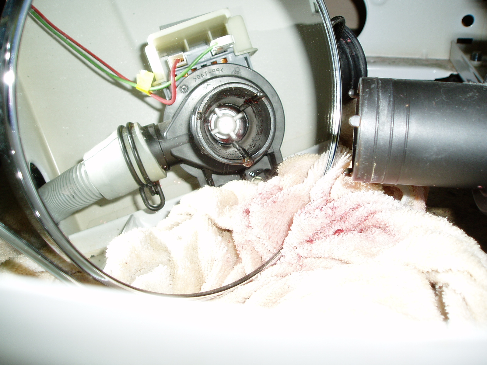

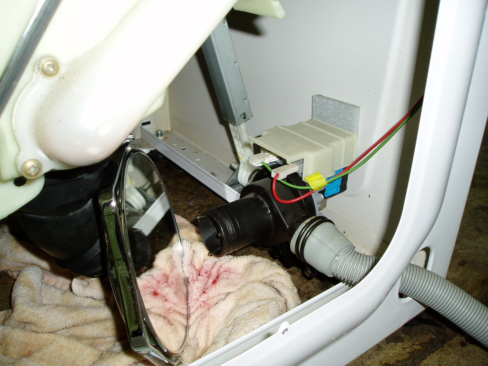

Thanks, Burnerman. Well, I managed to get the flexible 'gravity trap' hose off the pump and have a look inside. Pictures attached. The pump blades can be seen via my bathroom mirror. They appear to be clear and can be rotated fairly easily with a finger tip. Each blade feels slightly stiff but if you push a bit harder it flops round. Same with all 4 blades. Should they spin freely or be a bit stiff? It's clearly not seized but I don't know how it should move. There were no foreign bodies in there; just small pieces of wet lint.
The other clip is impossible to remove because it faces the floor, so you cannot get your hand into position to apply the pliers. The only way to access it would be to turn the machine on its side. But there's probably no need as it seems the pump is free.

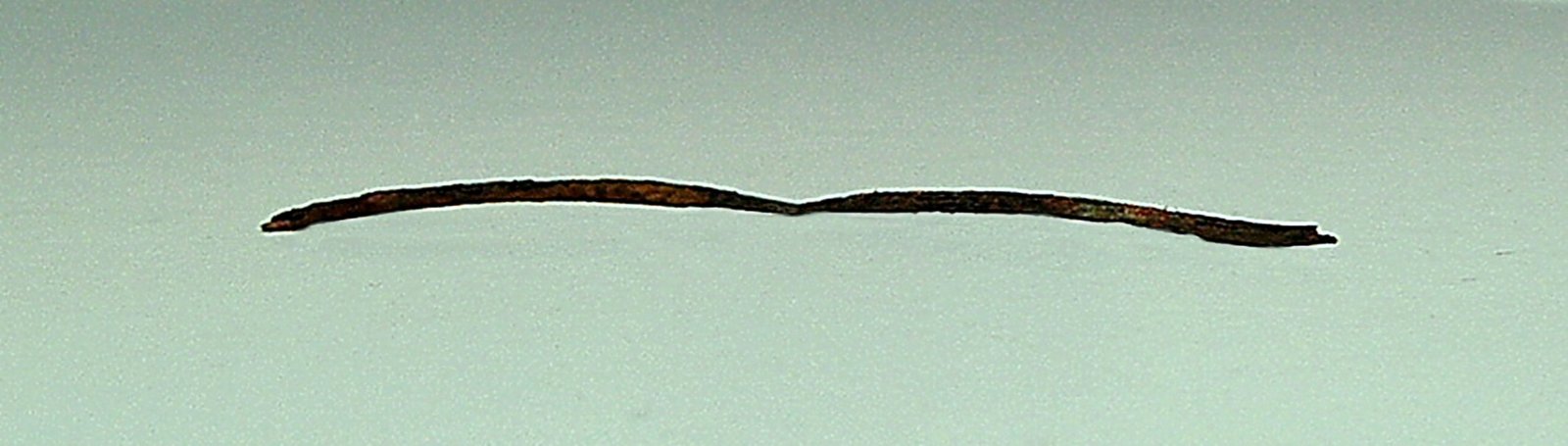

Insdie the 'gravity trap' was a small, thin piece of slightly corroded metal (60mm x 2mm; see pic. I have absolutely no idea where this has come from but could it be significant? Part of something that's failed?

These water pumps always have a 'step' feel as you rotate it with your finger.....whether this is over stiff in yours is impossible to say. The stiffness comes from the ' no metal contact' with the pump motor, and the only real way to test it is to compare it with another one, or disconnect it from the machine, couple it up to a mains supply and see how it spins.
The rogue piece of metal could be anything that has been in the drum.....paper clip from a pocket - goodness knows what but chuck it away!
