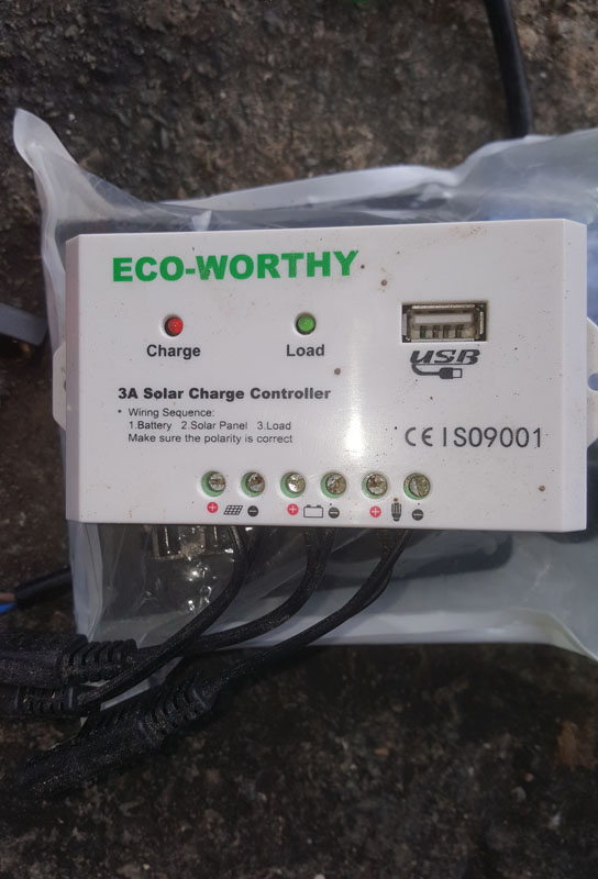

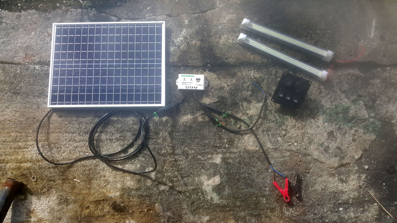

My brother bought me a 'simple' solar kit for lighting my small shed but no instructions came with any of the parts. As pictured here there is a panel, an 'ecoworthy' solar charge controller, a 3 gang switch panel, two LED strip lights and a bunch of spade connectors:
Everything is relatively self-explanatory to me as the solar charge controller shows where the connections go:

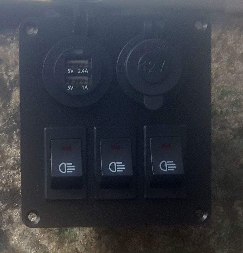

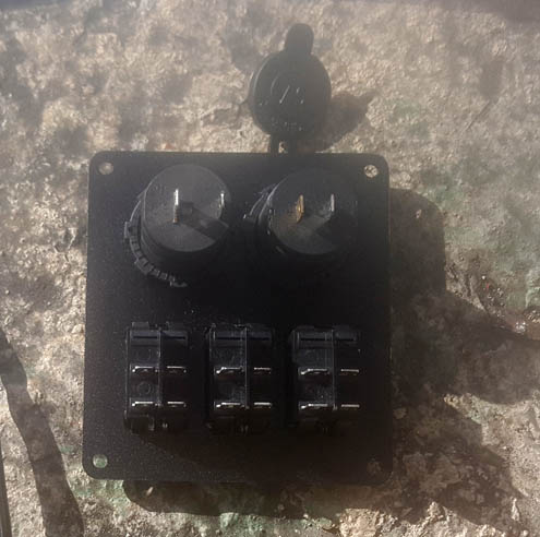

However, the 3 gang switch panel has royally confused me as I haven't worked with DC electrics before and pictures of similar panels look like a bunch of spaghetti! The front looks like this:
and the rear looks like this:
In my mind there is positive and negative going from the 'load' connection of the solar controller to the panel. However, what specifically are they connecting to on the back of the panel?

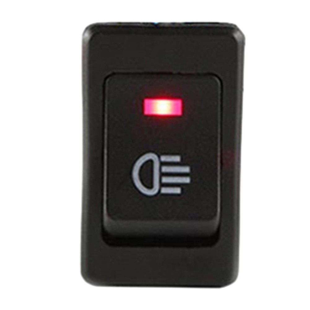

The cigarette lighter and USB have clearly marked positive/negative connections. Each of the three switches have four connections but not marked with anything. I'm presuming one half of the switch connectors will be inputs from the other connectors in some daisy chain fashion (from images of similar yet not exactly the same panels!) and the other half will be postive/negative going to the two LED lights i.e. two of the switches. No markings means I don't know where to start :(
Can anyone help with how the panel should be wired, or at least the methodology I should be following? The other thing I'm seeing whilst googling is fuses (which are missing from this kit)...should I have them for this particular two led strip light setup and whereabouts would they go?

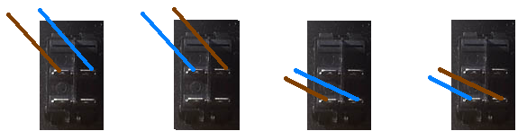

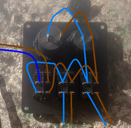

I can't see you + & - signs so you will have to ensure you get that right but this is the general arrangement:
I've shown supply at the top and 3 loads at the bottom. It looks like the switches have red lights so it is possible I have top and bottom rows mixed and possibly left/right polarity too.
I suggest you start with testing one switch with these 4 combinations of 12 volt supply with it switched off to see when the light is on:
That will be your load/output
You could also use one switch as a master:
Again checking the switches for correct polarity etc.
Start with checking a switch and feel free to ask more questions.

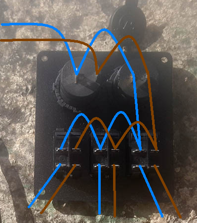

@SUNRAY wiring diagram is excellent but I would protect the usb and the 12v with an inline fuse either before each of the positive terminals, 5 amp for the usb, max 10 amp for the lighter port and I would wire these separately from the lights. If you wire a fuse in before the lighter socket and chain to the usb then whatever the rating of that fuse will be the rating for both sockets. ie 5 amps. You can power a surprising number of things from a 10 amp 12v lighter socket, 120 watts easily does a kettle.
Again the lights need a fuse which need a fuse either before the first terminal in the daisy chain or separately from the switch to the light. If put a fuse on each of the lines out you could use a different rating, say use one of the switches for a fan.

It wasn't an eco-worthy kit per se, I think this is an assembly of things to make a kit. Either way, the panel itself is non-branded and the ones I see on Amazon/Ebay, that sometimes show a wiring example, seem to have 6 terminals per switch which foxed me.

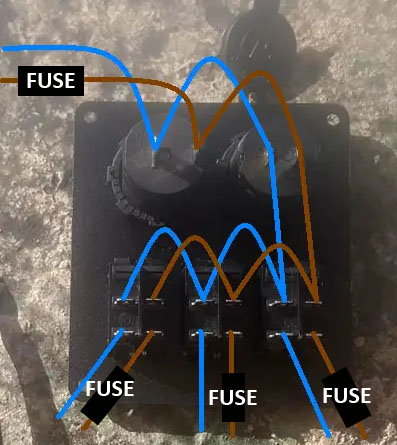

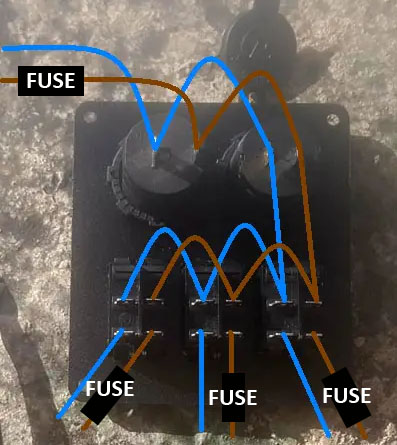

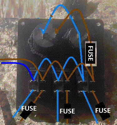

I don't seem to be able to post an image tonight. If you do wish to add multible fuses, I'd aim for putting the supply on the row of switches and from there to the USB & socket, also probable neater to fit the fuses before the switches and not after.
View attachment 296868I don't seem to be able to post an image tonight. If you do wish to add multible fuses, I'd aim for putting the supply on the row of switches and from there to the USB & socket, also probable neater to fit the fuses before the switches and not after.
Thanks, so if the fuses are before the switches that must mean the fuse sits between each positive lead between them e.g.
supply + ---> fuse ---> switch 1 + ---> fuse ---> switch 2 + ---> fuse ---> switch 3 + ---> lighter + ---> usb +
Dan
Ideally there would be a fuse from the supply to & before every device, just the same as a home consumer unit.
IE; 12V supply from charge controller, then:
fuse to switch to light
fuse to USB
fuse to socket
However the version in my grotty GIF is equally acceptable as is a single fuse feeding the whole panel.
