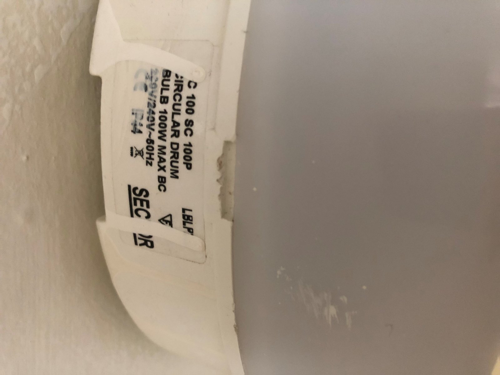

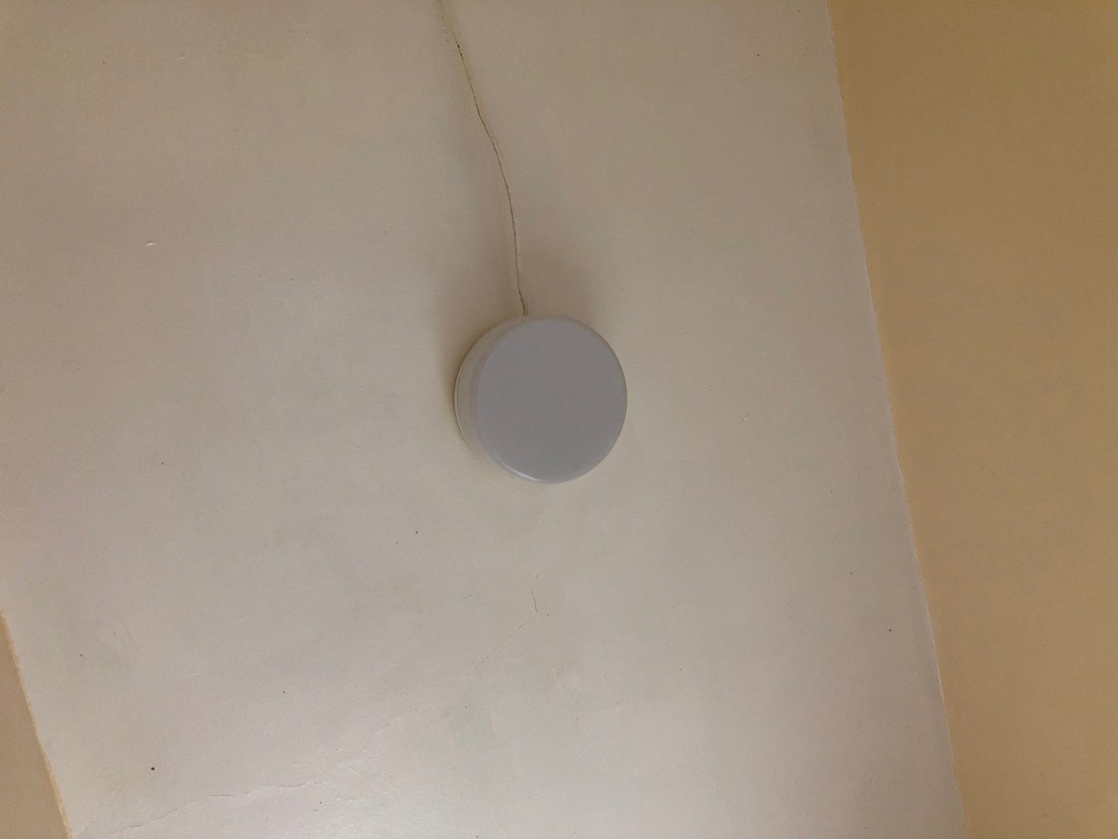

Pics below are of light fitting in a rented flat that my daughter is using at uni, several hundred miles from me. The lamp needs replacing but she can't remove the cover/diffuser.
It looks to me as though it just clips on and can be released by a tool/lever in the slot pictured, which she has tried but maybe not with enough force. Can anyone confirm or suggest a better technique?
TIA
50p coin in the slot and twist.
If it's been on there for years, significant effort will be required.
Maybe try the 50p gripped in pliers, a bit of gentle tapping round the rim might help
