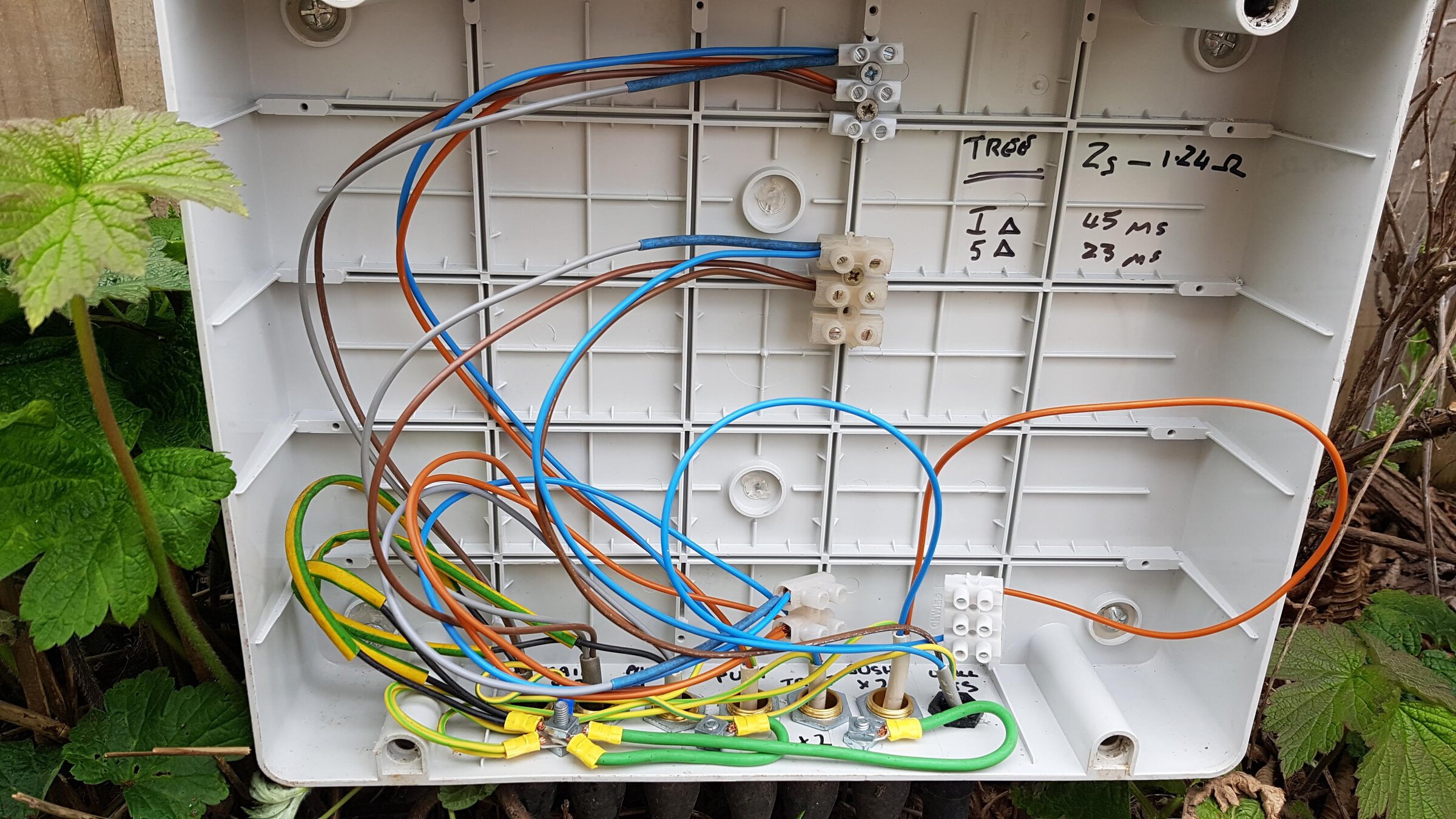

So, in the end I purchased a BG IP66 Weatherproof outdoor switched socket, and have fixed this to the side of the existing wiring box. I also purchased a couple of plastic BG 1-1.5mm flat cable glands and used some standard 1.5mm grey PVC cable to connect the new socket to the existing wiring box, using the glands to waterproof the connections.
I wasn't too sure about using standard PVC cable outside, but it is a very short run and I noticed all the wall mounted floodlights around the house use this cable. I understand that standard PVC cable is not UV resistant and can become brittle over the years.
It then occurred to me that I have some 1.5mm SWA left over from when the landscaping was done and the garden lights installed, so I am considering replacing the short run of PVC flat cable with a short length of SWA. It is probably overkill and I will also need to order some metal glands to fit it. As I've never used SWA before I did some Googling and watched some videos, and "earthing" the steel armour is obviously a big issue. The SWA I have, and that was used in our garden, is 3-core 1.5mm and I can see within the wiring box that one of the core is used for earth, however, it would appear that NONE of the armoured cables have had their armour earthed.
Should I be worried? This was installed by a qualified electrician, so is a bit of a surprised based on what I have read, given that all the existing SWA cable is buried around the garden; some under the patio, some under flower beds and some under the lawn.
I was thinking that the very short run of SWA that I was planning to fit wouldn't need the steel armour to be earthed as it isn't running under the ground and because it is so short, would be unlikely to be damaged. Besides, it wouldn't be any different to the wiring up of the PVC cable, but would be fully weatherproof and much more protective!
Here's what the original wiring looks like:
As you can see there are no earthing tags to earth the steel armour, only to the core being used for earth.
Ah, I've just realised the earthing tags are actually underneath the wiring box, rather than inside it. I noticed there are two screws inside the box with a single earth leading to them, which didn't make sense, but now I realise on the underside of the box is where the steel armour is connected to these screws.
So, happy with the existing wiring and I guess the question is should I also earth the new SWA cable given is runs from a new connection at the base of the box to the new weatherproof switch fixed to the side of the box i.e. very short run, above ground and therefore unlikely to be damaged!
Yes you should.
