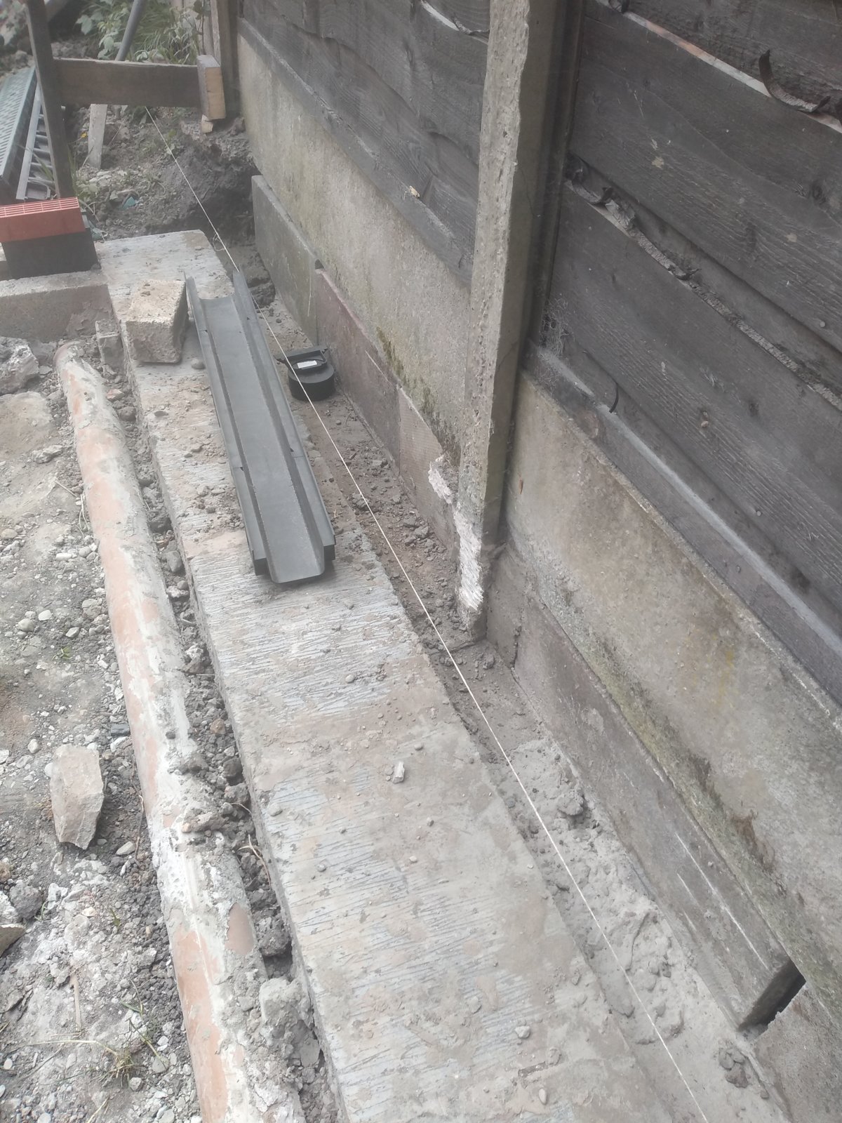

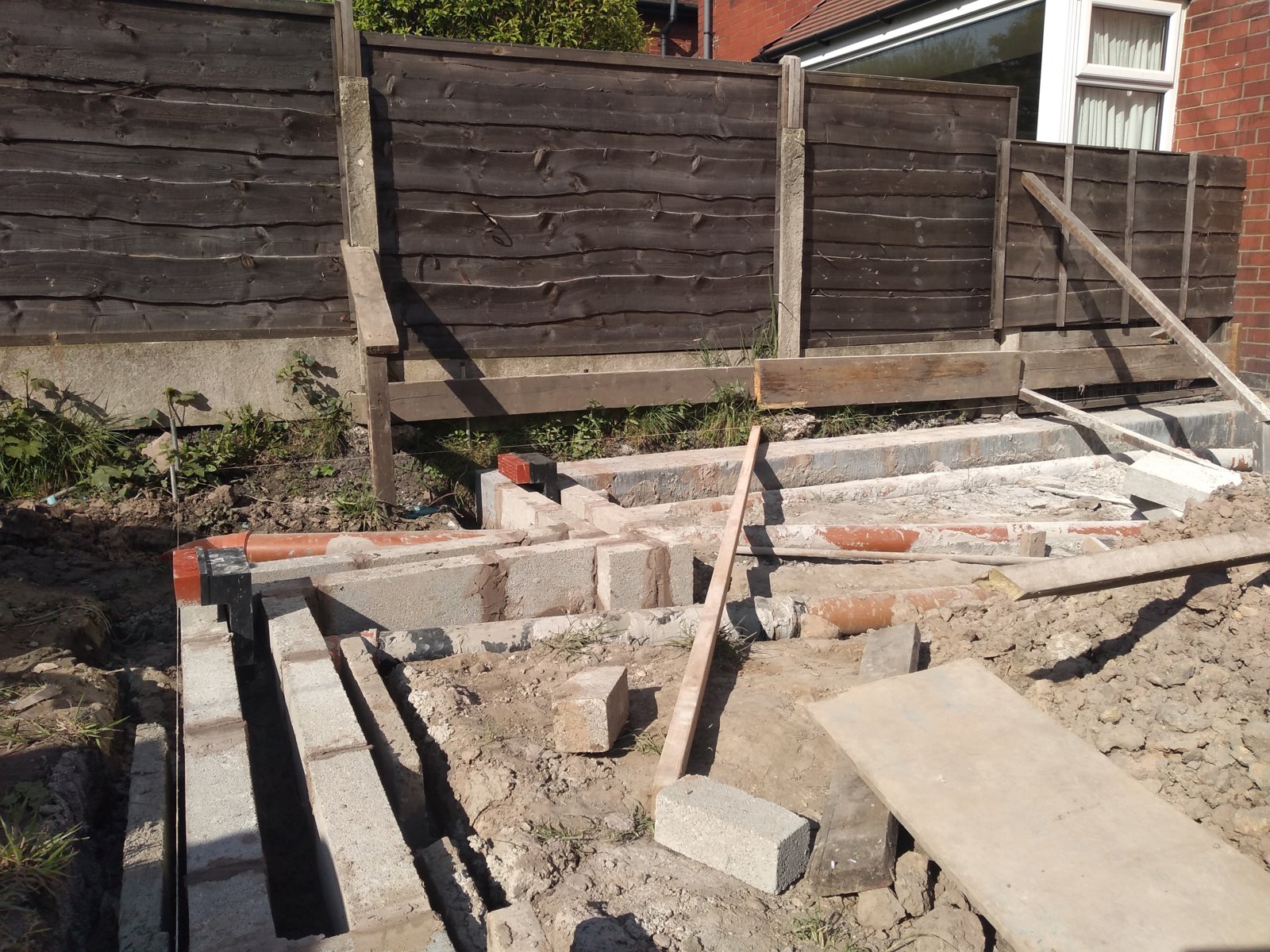

My extension is coming up to floor level and I need to deal with the high ground level along the boundary:

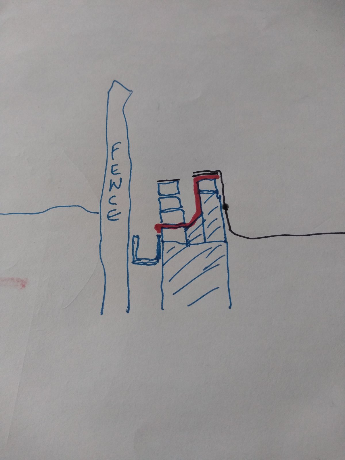

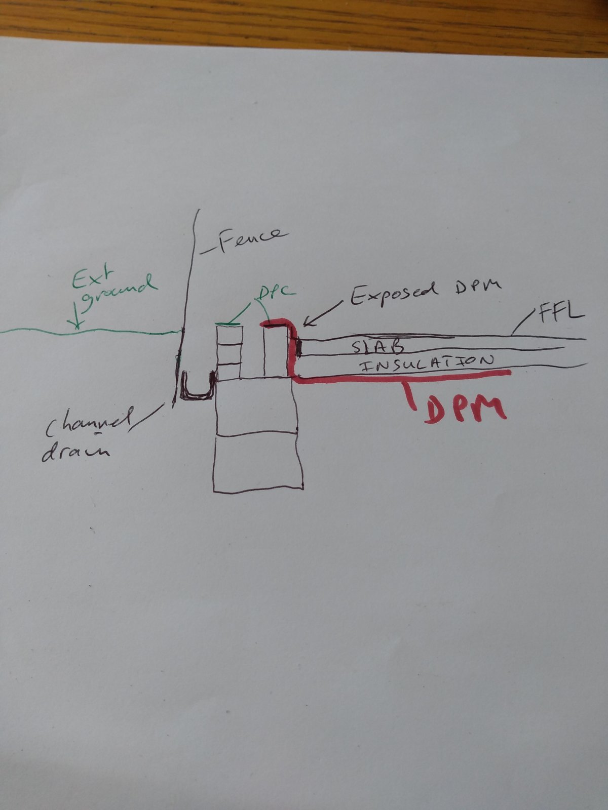

I've drawn what I think is the usual way to do it:
I'm just wondering if there's anything else I can/need to do to avoid water penetration? The height of the channel drain is fixed - halfway up the first brick (as it has to clear a pipe further round). Would it be better to put the dpc on the fourth course then (if necessary) I could put a cavity tray and weep holes to drain into the channel while maintaining the 225mm clear cavity.
Also, how do I protect/cover the dpm internally where it rises above the floor slab, is it just a matter of being careful till it gets covered by the dot and dab?
Any suggestions appreciated.
