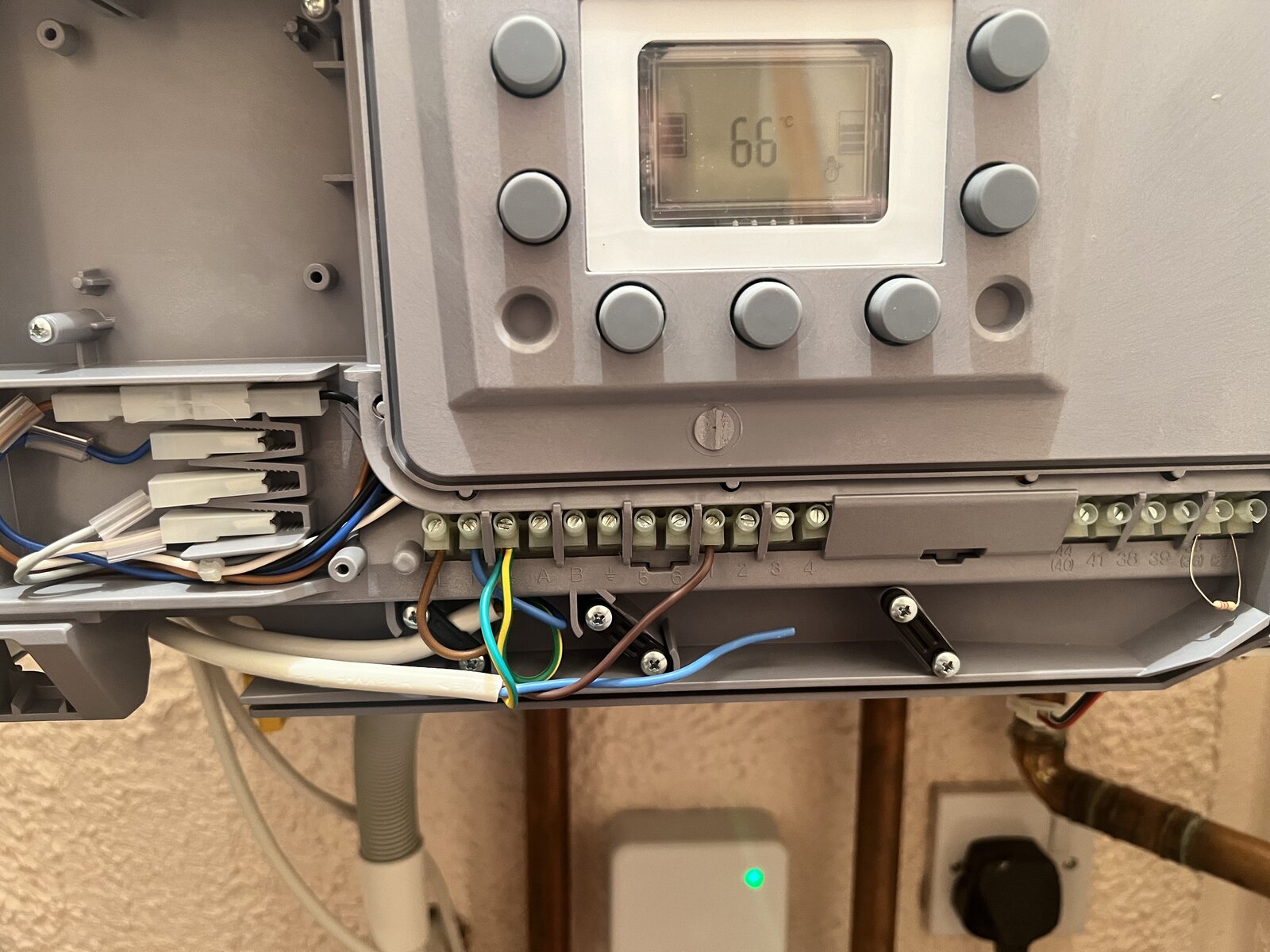

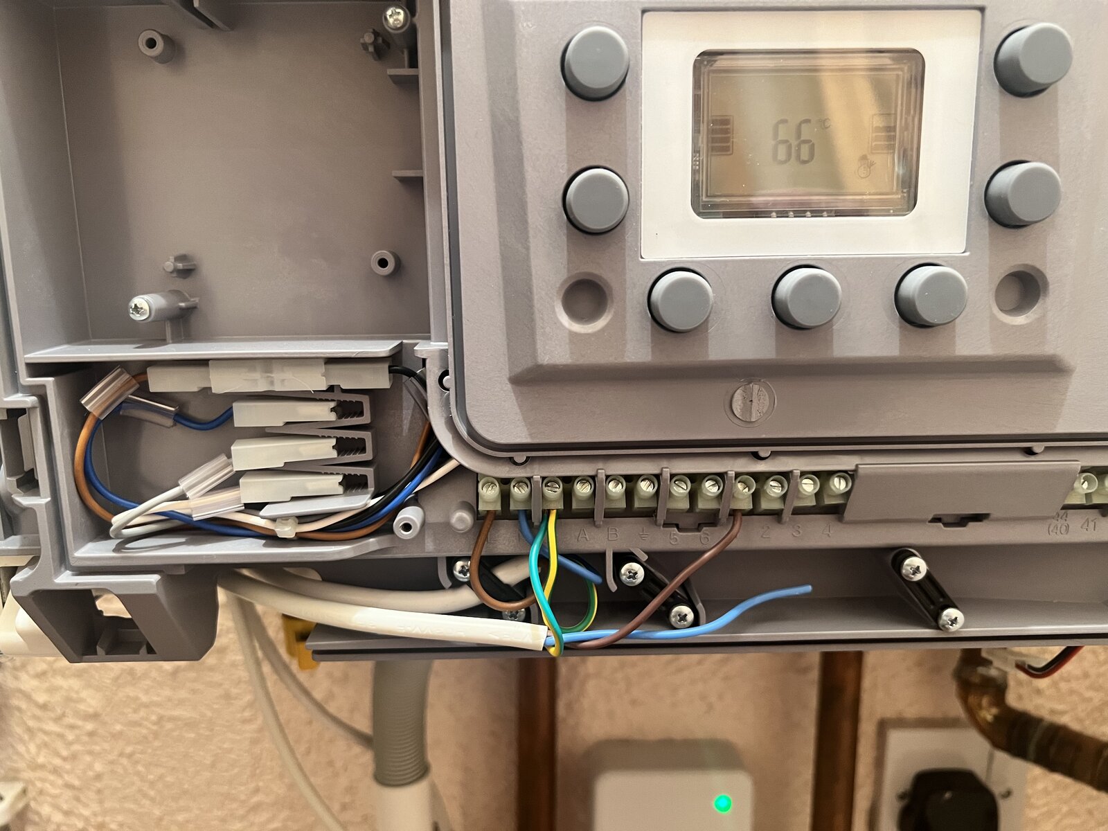

Hi there I have a alpha e-rec 20s boiler and I’m trying to fit a hive dual receiver can someone help me with the wiring there is already two wires coming from the boiler but this fed a old style timer I think the wiring is not connected right can you help please see attached pictures coming from boiler

You have a system boiler, so wiring should be done at previously used programmer or at the wiring center.
So the wiring at the programmer what wire goes where I have I wire from the boiler with one blue one brown and a earth and a second wire with one earth and one brown just a bit confused which wire should go where

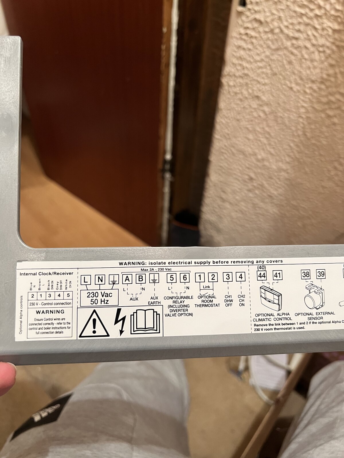

And Looking around all different forums should there not be wires coming from 41 and 44 on the boiler
Looks like it could be the following: (hot water off being used if you have a Y plan)
A to L
B to N
2 to hot water on
3 to hot water off if needed
4 to heating on

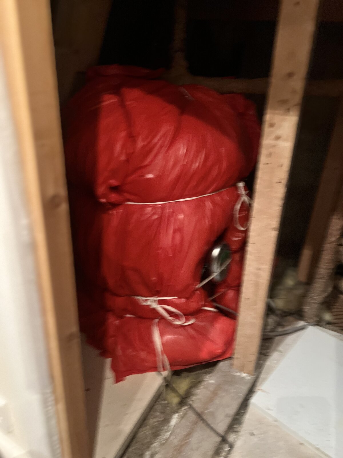

And that’s from the boiler so run a new wire in the order as cover says 2is optional room thermostat just found out that it’s a gravity feed hw
Yes, run some 5 core heat resistant flex and that should get you all you need, unless a Y plan. Are you sure it’s gravity hot water?
Post a photo of cylinder cupboard if unsure
