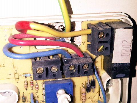

I've bought a Wireless Thermostat to replace the existing Sunvic dial type.
I opted for a Sunvic TLX RFP as I thought the wiring would be simpler between different devices in the same manufacturers range but how wrong could I be.
The manual is confusing and the printed terminal designations on the unit are different as is the diagram on their website so I'm not clear as to which of the existing wires go where!
The unit has a voltage or wired free option.
Here is the wiring on the existing thermostat:
The Neutral is unused. Live and the yellow wires are the switched supply and Blue Neutral, all nice and simple.

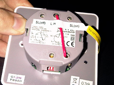

Here is the rear of the TLX:
The red link wire remove for Volt-Free use or left in-situ for mains switching.
Bottom centre is Neutral.
Can anyone advise on which terminals I use?
Thank you for such a fast reply! Just to confirm, the link wire remains in-situ with Live both on same terminal?
the link stays where it is, the red goes in Lin with it..
Yellow to SL (on)
Blue to neutral..

I have had a valliant eco pro 28 kw combi installed with a sunvicTLX RFP Volt Free timer/thermostat. I am fitting timer myself. Can somebody confirm that off the buzz bar, i wire teminal 3 to L in, terminal 4 to SL on and terminal 5 tpo neutral from boiler to stat receiver. thanks
Andy
Andy
Yes thats correct!
Thanks londonboy. That's what I thought. Bloody thing isn't working. Doesn't seem to detect the tranceiver.
You should have started a new thread really.
In the thermostat receiver did you remember to link L and 2? Its a volt free thermostat, so it needs to get its power from 3 ;)
