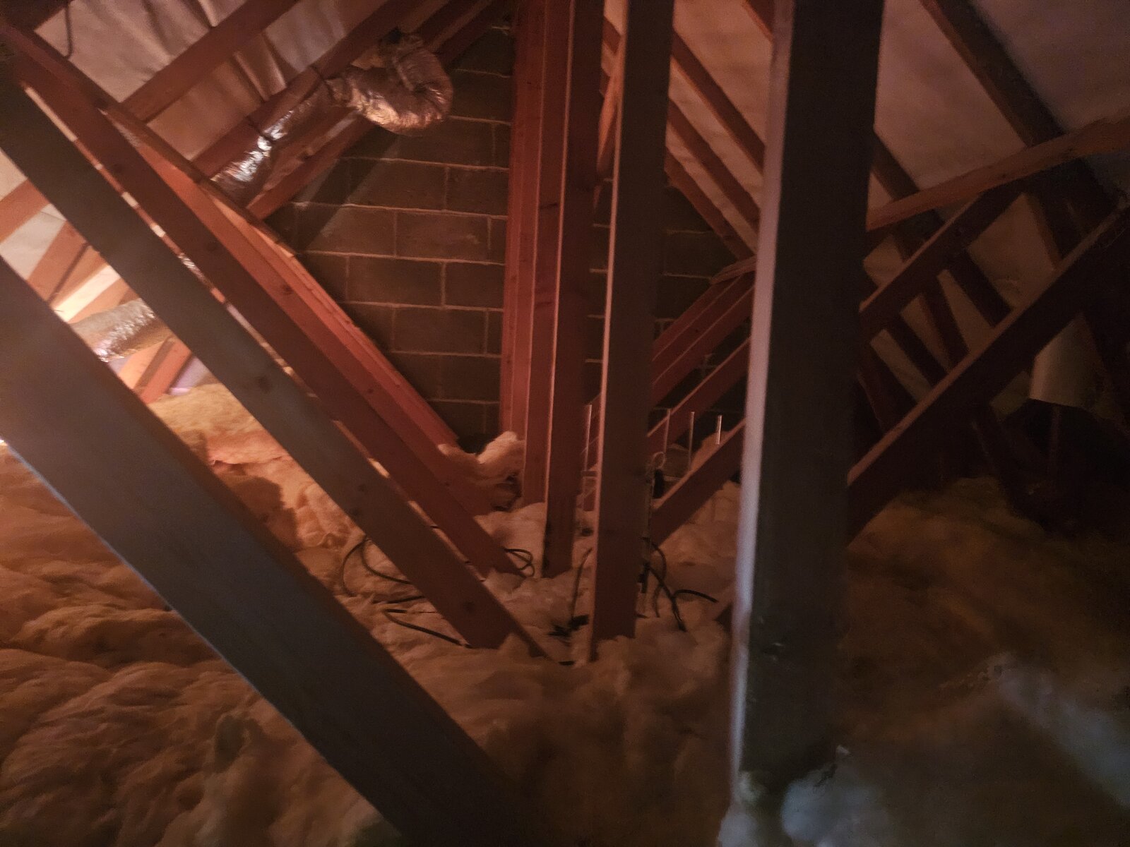

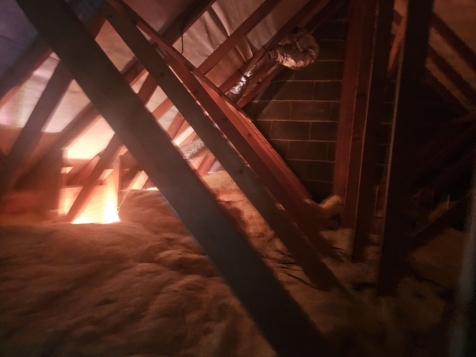

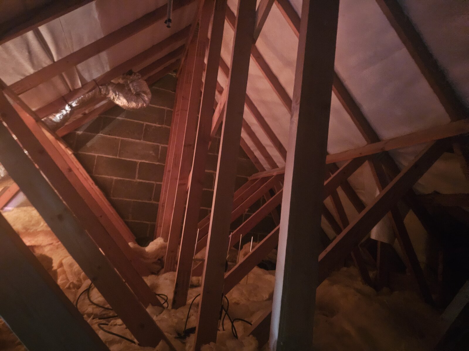

Hi there, I'm looking to board up our loft. There are some diagonal beams which I would potentially like removed to provide better access. I know they are most likely structural and hold up the roof. I'm just wondering if it's possible to get them removed and replaced to open up the area? If so what trades person would I contact? And any ideas of cost if anyone has done the same before! Thank you

You won't be able to remove any of those without spending £1000s. They're per-manufactured trusses, cutting any of the ties out will destroy their integrity.
