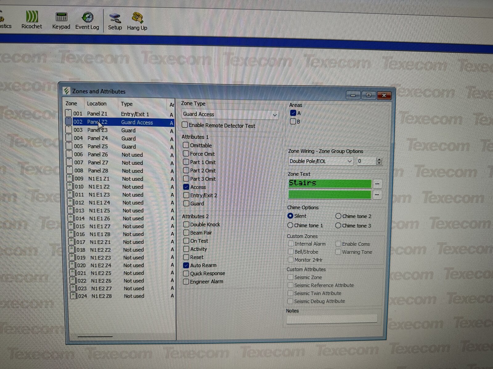

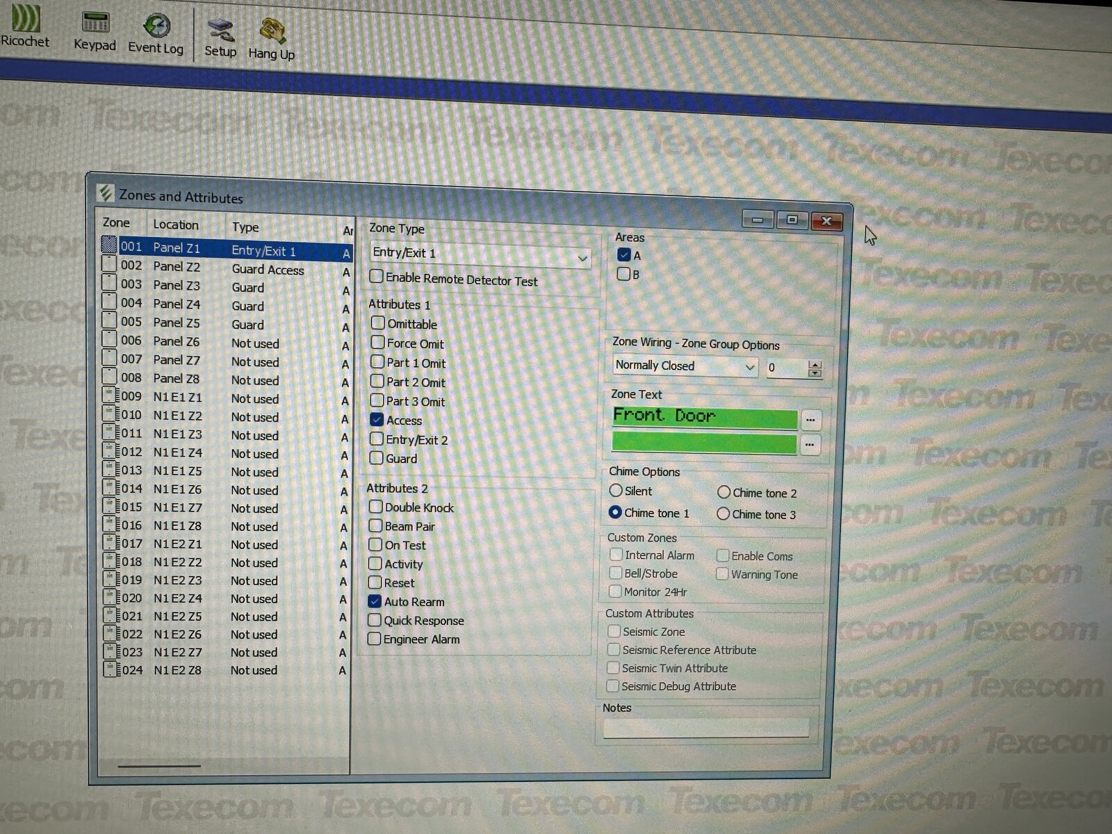

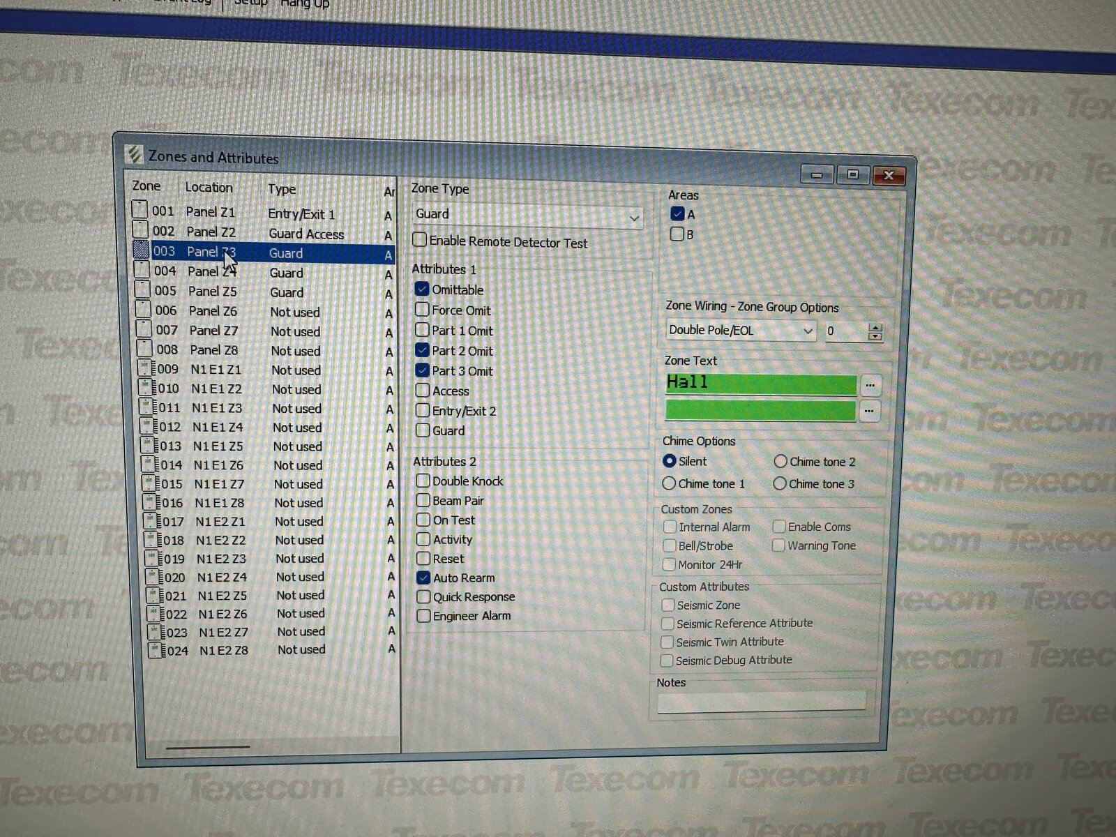

Hi I had this working fine for around a year but had to do a factory reset and now I am lost with part arm. I keep zones 1&2 as access so armed and 3-5 as off but walk test on 3-5 sets alarm off, any help please ?
D7ADF9CB-DD27-4613-8BDA-06A3EFD0D744.jpegD39E647F-B7F2-49FA-8C81-E57A7B169D53.jpeg9236FC66-6494-414A-98A3-3B19F697CDE6.jpeg
I dont follow walk test they will always work (if they are programmed as anything other than not used).
if zones 3,4,5 neede to be omitted in part set 1 option on and not 2 and 3, if they need to be omitted in all 3 parts then 1,2 and 3 need to be ticked
Sorry when I say walk test I part arm and walk into the zones to test and the alarm goes off. All I want is in part arm is zones 1 & 2 to arm and 3,4,& 5 to not arm.
if zones 3,4,5 need to be omitted in part set, part set 1 option on (currently you have 2 and 3 on)
Thank you for taking the time to answer this, so i had it in my mind the opposite from what it should have been. i have changed the settings and it seems to be working and have made sure to have a back up of this as i lost my original files.
