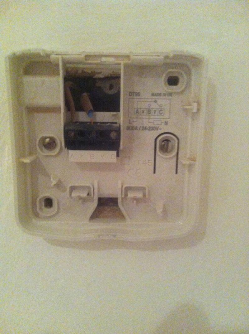

There's also a Honeywell DT90E Digital Thermostat on the wall a few rooms away from the boiler unit. This has just 2 wires coming to it - connected to A (live) and B (neutral) terminals. The odd thing is that the diagram on the unit shows them to be live and neutral connections, and are the opposite way round to those I can find in the online manuals. The colours on the wires appear to be brown (live) and blue (neutral), which would match up with the diagram printed on the Honeywell chassis
Following the Nest instructions, I should be able to connect the Nest Heat Link via the (2) and (3) connections to the two supplied wires. However, the diagrams all show a Live -> Live circuit with a 3A fuse connected to this loop, which doesn't seem like what I've got.
Am I over thinking this and is it right that I just connect up what was A -> (2) and B -> (3) on the Nest Heat Link?

Here's my Honeywell with the fascia removed
I hope that will establish how this thing is wired up and at least so I know what to say to a professional tomorrow to save some time
Thanks again!
You don't need to tell a professional anything tomorrow. He'll work it out in about 30 seconds.
How that backplate is wired up is largely irrelevant as the two wires can only do one thing with Nest.

right that makes more sense as to what you are trying to achieve but it wont work. the wires at your hwell stat are a switch live in and live out .not live and neutral to have the heat link where you suggest you would need 3 cores a permanent live a neutral and a switch live.
