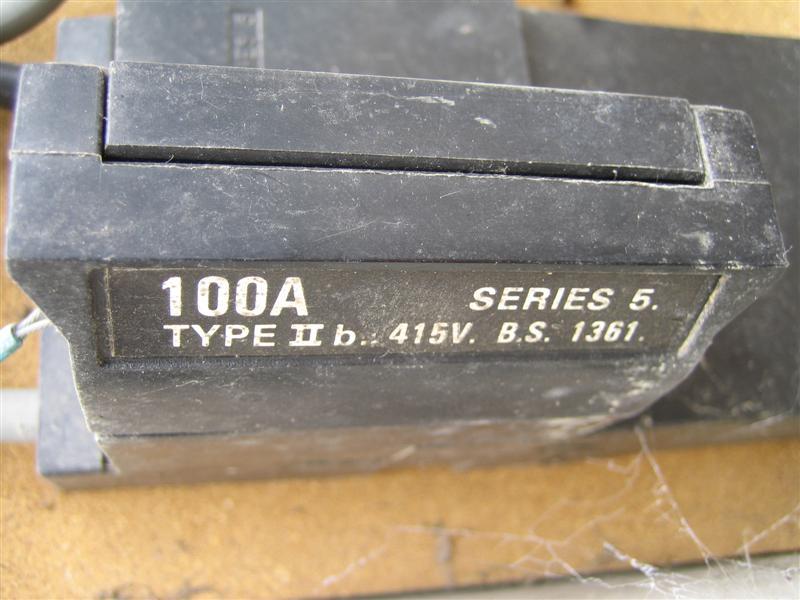

Cutout is rated at 100AMPS.

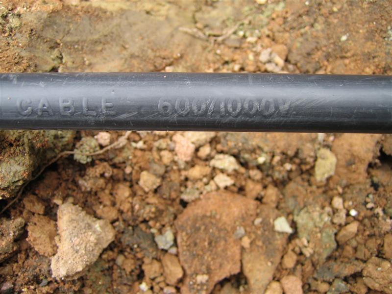

Thanks for the link. I wasn't aware of this type of supply cable. The cable has writing embossed on the outer sheath. I think it says 600/1000v but will double check.

It's not really your worry, mate. If you have a 100A fuse in the cut-out, that should be sufficient.

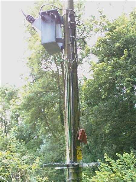

The overhead cables which the underground one is connected to has 3 overhead lines. The pole which has our transformer on it has the name of our property on it and only serves our property. We our in a rural location and have no near neighbours.

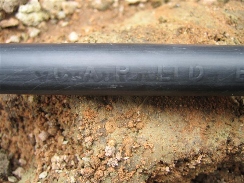

The cable connecting to our meter has C.A.P. Ltd on it along with 600/1000v.

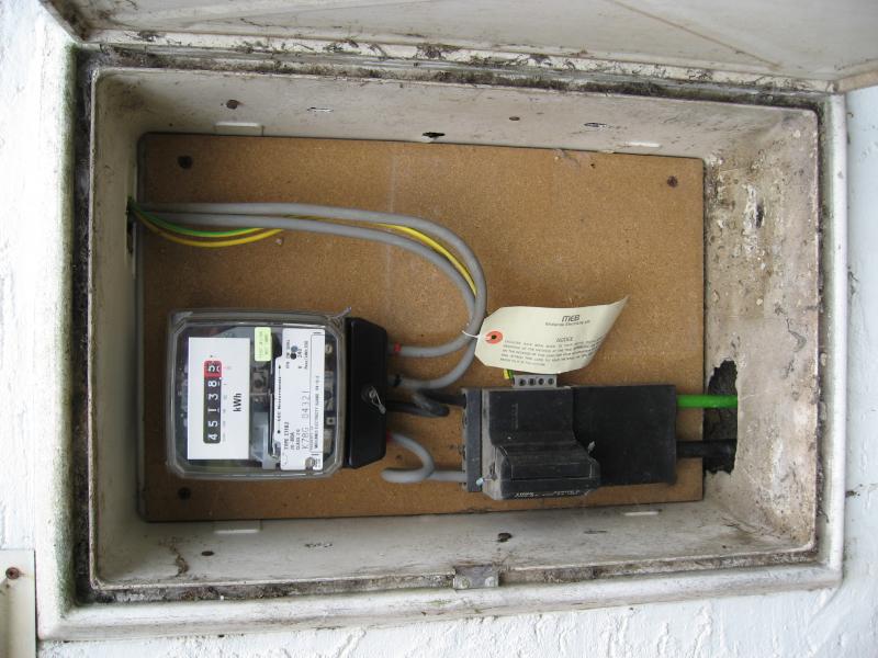

Here's a few photos of the setup. Hopefully these will help someone identify the cable type and size.
All looks fine for 100A, and yes that is split concentric cable. If your demand is more than that, you'll be needing a new transformer too, but this is all the DNO's concern (except the bill they'll be posting to you :))
