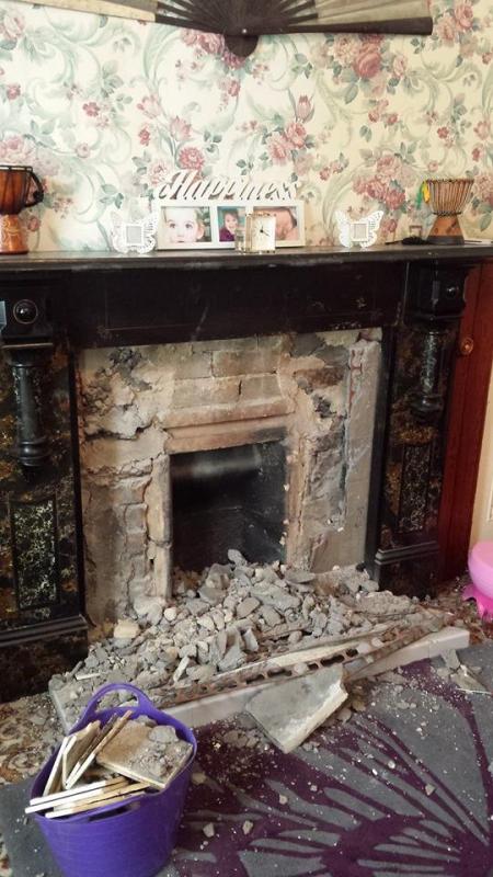

Hi there.
I am hoping to install a new wood burining stove over the next few weeks.
I have kncoked the old 1960's tiles and plaster off the bricked up fireplace to reveal this......is this just "infill"..?
Im wondering if there will be a brick arch further up...? Im fairly certain the surround is original and that it was pieced together on installation rather than being a single solid unit so Im thinking I may have to carefully dismantle the suround and replace it afterwards.
I'm not a builder so my main worry is that if i just knock this infil out that there might not be an arch or a lintle, I mean based on the fact that the surround is original, why would they have put a brick arch way further up if they planned to put a small coal fire in...?
any advice on how to proceed or what to expect much apprechiated. Thanks for reading.

Dont do anything else until you have the stove Mfr's installation instructions in hand, they will give you the dimensions to work to. If you have the Mfr's Inst's then call a HETAS tech and work with the HETAS from now on - you might save yourself a bit of grief.

I was on the phone with a HECAS engineer for a while yesterday who advised that there "should" be a lintle in place, Im just after seeing if anybody on here has any experience with a fire like this as at first glance its looking like the apperture is possibly larger than the surround.

If you take the plaster off you should find an arch probably about a foot (or two even) above the level of the current mantelpiece. I haven't got any pictures on me but that is exactly how mine was set out.

I would certainly try to save the surround (It looks like it may be timber painted black, if so it could be stripped back and repainted). As for the opening, the shaped fire back can be removed and the rubble behind cleared back to the builders opening. The grooved lintel above the fire is the front part of the flue support, it will dovetail into the rear flue support. You should not remove this until you are certain there is a lintel or arch above. The stove spec will give dimensions but it is almost certain that you will have to open up the hole to at least the inner face of the surround, and this will probably require a longer lintel installing. But what is actually required depends on the advice of your HETAS man and possible Building Control if there is structural work involved.
Mine had already been replaced with a horrid gas fire so I opened it all up right the way up to the arch and then had a stove installed in the new recess.
