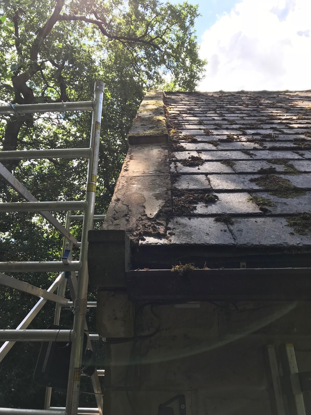

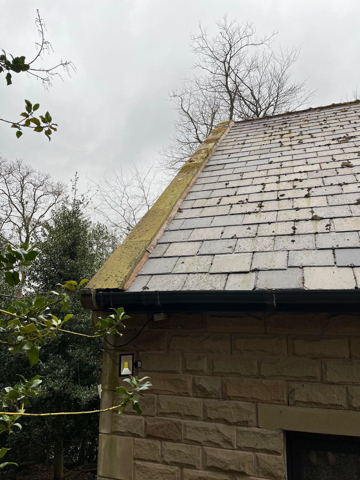

Dear All
I have a gable end which has coping stones and slates. The house is a timber framed house with stone outer leaf. It wasn't built very well so am always fixing the original poor construction issues.
I am getting a leak underneath the coping stones and have a roofer to come and look at this week. He has previously repointed the joint with the slates and coping stones, and the gaps between the coping stones a while back. Water is still getting in. The water drips onto some of the timber frame so I urgently need to sort it, but luckily I can access the area from some eaves to monitor. I am hoping to get some advice on what I should be wanting him to do to improve the design and not just bodge it up hoping that pointing mortar will fix it.

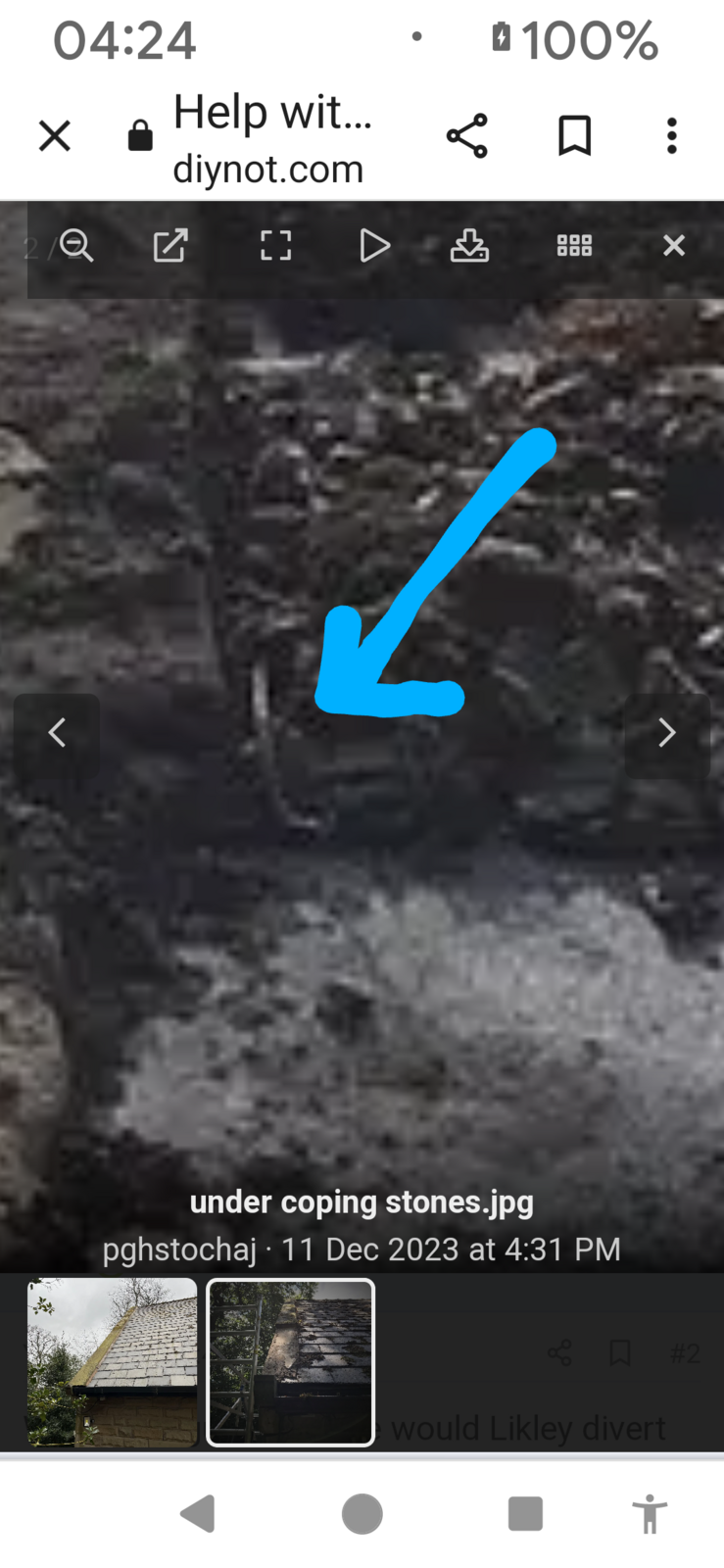

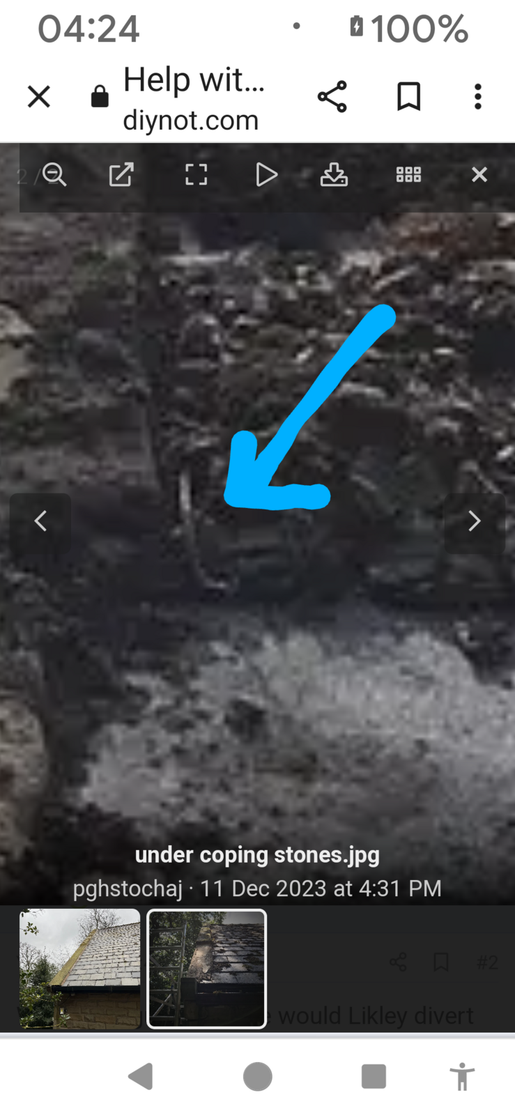

A while back, one of the coping stones got knocked down during tree work so I have a photograph showing the make up under the coping stones. There is a stone wall outer leaf, the slates abut the wall (you can just about make out the line of slates in the photograph I think) and I think the roofing felt is then run up to the outer leaf. This is then covered by a bed of mortar which the coping stones should have sat on.
I suspect that water is getting under the coping stones and then getting through the mortar under the coping stones where it sits on the felt (which has a small hole in it) and then it drips onto the inner wall.
What would people advise to sort this out properly please? I am not a roofer but the things I have read up/thought about include:
- Soakers versus pointing (the pointing never sticks well to the coping stones). Is there anyway to put some soakers in.
- Capping over the coping stones with lead (but noting the lack of a soaker, would this even work.
- Just remove the mortar bed, refit the coping stones on a fresh bed (after repairing the felt) and point the gap between the coping stones (or will this always just fail with time anyway).
- Any product better than mortar for filling the coping stones gap such as a resin (the mortar does not really adhere with the coping stones).
- I have a small scaffold that means I can easily access the first two stones, going beyond those I would need a built scaffolding.
Thanks very much, I very much appreciate any help that somebody can provide.

What your guy has done would Likley divert water where you don't need it.
I can see a soaker with small upstand .
I'd be inclined to take those soakers out make some wider ones that extend over the masonry. And then re bed the copings .
Easy enough .
Hi, thanks for the reply. Maybe it’s a terminology issue but where do you see a soaker? I can only see the bed of mortar that the coping stones originally sat on. Thanks
Imo if you simply cap the copings in lead you could still get an issue . The existing soakers have a very short upstand . (they are there)
Thanks both, I can see those in the picture now. What product do you think I should be asking for and should they go all the way to the outer leaf? Should I get the roofer to strip back the mortar, install new soakers and then just re-bed the coping stones? Does anybody have a better solution for filling in the gaps between the coping stones please, I keep finding that the mortar doesn't stick so it quickly allows water in.
Thanks again.
Thanks, but I have not properly understood, what would you suggest is the correct detail for this please?
Remove existing lead soaker . It's upstand is to small .
Replace with a lead soaker wide enough to go under the slate and extend across the parapet .
Do this from top to bottom . Then replace copings .any ties can come from between soakers which will secure the copings.
