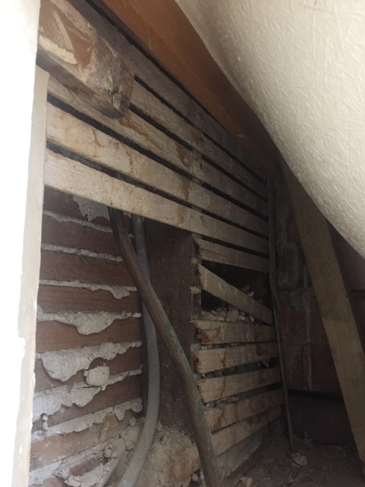

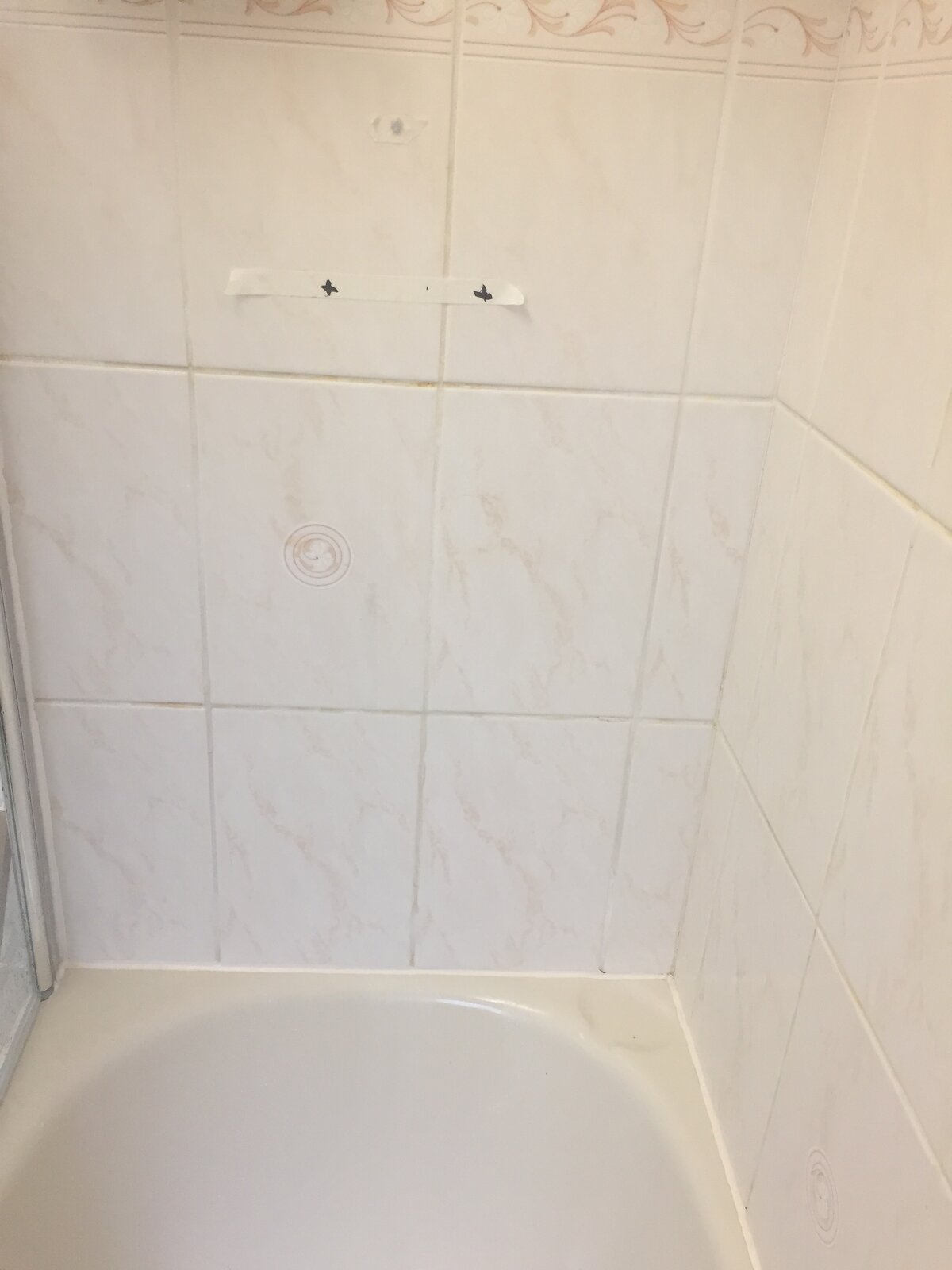

I want to install a mixer shower ( mira atom) I need advice on the best way to tackle it see photos I dont really want to remove any tiles if possible because they are stuck onto lath and plaster I have some room under the bath as can be seen but which way to route the hot and cold (n) any advice please

I can't think of any way you'll do that with out removing tiles. The pipe work needs to be accurately sited at 150mm centres.
How would you get a bent piece of piece up there or a straight piece and then solder an elbow onto it?
Thanks .Just helped me decide I have some spare tiles I will take a couple off and patch up as needed after getting pipes in Never thought of going through the other side but to be honest that would be a job as well to finish off with what would be needed
