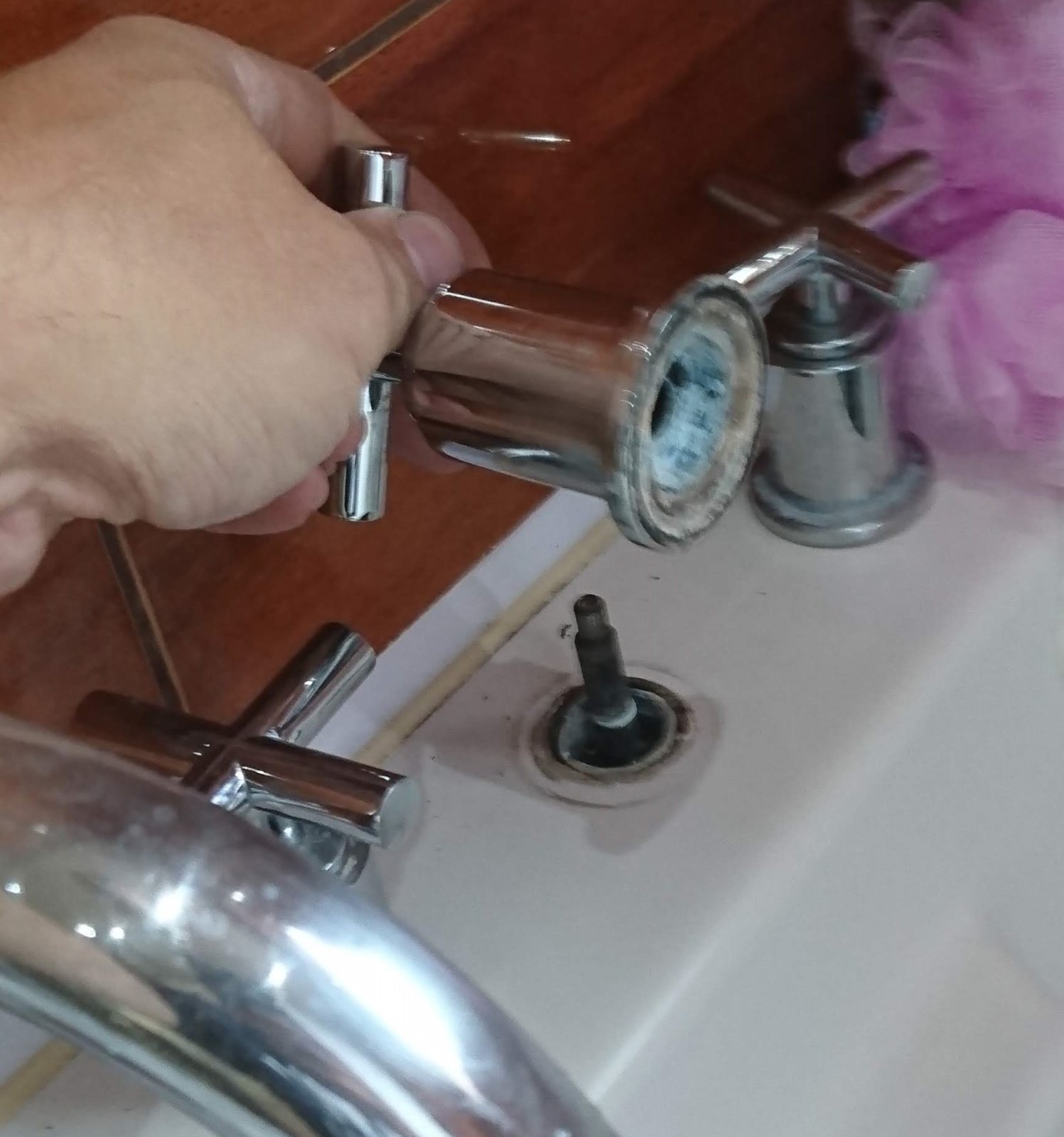

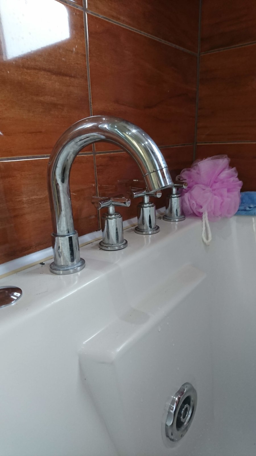

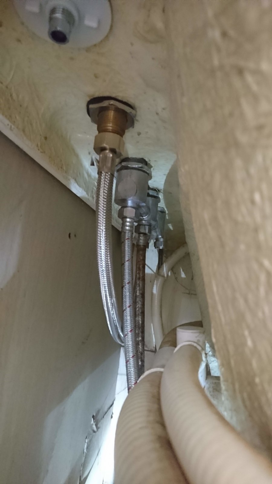

Hi,
While doing some jobs at a house i was asked to investegate a leak which turned out to be a valve leaking but the taps are not sealed at all the whole part of the tap body sits over the valve that comes through the bath just attached with a grub screw at the side
I cannot see how this can be a water tight seal i have attached some pictures hopefully will show what i mean
Anyone with experance with this type fitting give me some idea how its water tight?
You cant really see from picture where i have it in my hand but there is a gap through bath where tap base comes through
cheers

I had a similar situation not the exact same taps I took them off put a ring of silicone round and put back on. That stopped the leaking.
Thanks ,
so you put silcone underneath? just seems odd there is a gap where tap valve comes through like should be some kinda gasket or something
The whole of that part in my hand is one solid piece
Your right there probably should be a gasket. You could look to buy one or use silicone both should achieve a similar outcome which is no more leaks.
