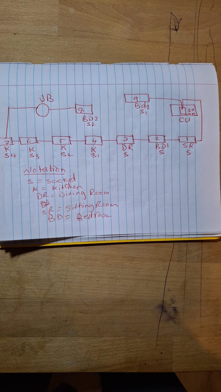

Just acquired 2 bed property which has the old fuses with wire consumer unit. My electrician will replace the consumer unit with new one and issue DOMESTIC ELECTRICAL INSTALLATION CONDITION REPORT. However, I have inspected the wiring of the property today so that I can sort out/ rectify any issues before his visit. The below has been found and would be very grateful if I can get help;
1. All the house power sockets (including the kitchen) are on one ring circuit. However, there are 2 sockets in the second bedroom are connected to one wire. All others are connected to 25mm twin wire with earth. How would that be possible? Does this mean that there is a junction box somewhere under the floor broad where one wire was branched out to those sockets. If so, is that legal? The total number of socket are 10
2. There is 6mm wire connected to consumer unit at one end (30am fuse) and terminated in a single socket in the kitchen for the extractor. Another single socket connected to this single socket (below it) to operate the oven (2.5mm wire). And the oven socket is also connected to another single socket via 2.5mm wire to operate the washing machine. In other word, 3 single sockets are connected in series the first one is fed by 6mm wire and the other 2 via 2.5mm. is this allowed?
3. I am hoping to separate the kitchen, upstairs bedrooms, dining and sitting room each on different power circuits. Do I need to rewire the whole house or can I modify the exiting wiring?

1) You mean all sockets have two T&E cables and those two only have one each? That would likely suggest that they‘re unfused spurs and there’s junction boxes under the floor. They should be replaced with maintenance-free junction boxes.
2) This could probably be rectified by running 6 mm2 from the extractor socket to the oven, so only the washing machine socket is on 2.5.
I managed take off the floor board and chase the wires for the power circuit and to my surprise it is all radial on 2.5. wires, see attached pictures. It is not what i initially thought (on ring circus).
what is the best solution to create as much ring circuits as I can? all the wires are in very good conditions.

If that sketch is correct it’s a bodge
Best you get it tested properly to confirm this first before you do anything
I was thinking to run 4 mm2 from the extractor socked to the oven (it is 13 am oven) and another 4mm2 from the oven socked to the washing Machine
