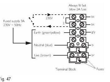

I am looking for a little help with a wiring centre and the wiring formation for a system boiler. I have no problem wiring a conventional system with external pump and 3 port valve, but the fact that the pump is internal is tending to concern me, due to the feed being from the boiler. What happens to the pump terminals in the wiring centre ?. The live feed to the boiler, no problem, the live out and switched live to and from the wiring centre respectively, but which terminals ? The boiler by the way is a Baxi Megaflo system boiler.

The pump is incorporated in the boiler and wired internally, so you just ignore the pump connections in your wiring centre, just provide the switched live [usually terminal 8] from WC to boiler.
Ideally the power to the wiring centre should come from the boiler. This ensures that turning off the power to the boiler also turns it off to the wiring centre, motorized valves etc.
Is your timer built into the boiler or external, connected to the wiring centre?
All external wiring is to/from 1 & 2 in the boiler, after you remove the link, and must be suitable for 240v switching.

Thanks for the 2 replies. I understand the permanent live feed from the fused spur goes to the boiler, the feed to the wiring centre comes from terminal 1 at the boiler to ( I assume) the live supply terminal in the wc. The time clock is external as the megaflo does not have an integral 2 channel clock. This would be wired into the wc. The bit that I can't get my head around is where does the switched live come back to the boiler from (position 2 on the boiler), is it the live that should go to the pump ?

Live out from boiler actually terminal 2 going to terminal 1 in the wiring centre (live supply)
Terminal 1 in the boiler is the switched live back to the boiler.

I have just checked all the Megaflow manuals and all but one show 2 as the Live and 1 as the switched Live. I must have read up the manual with the exception!

You just need a connection from WC terminal 7 in the wiring centre back to the boiler's Switched Live connection, terminal 1.

The Baxi Megaflow uses switched 230v as in this diagram from the installation manual:
Terminal 2 is live and terminal 1 is switched live.

Which is why I said the power to the wiring centre should come from the boiler. When power is turned off to or at the boiler, the wiring centre and everything attached to it will be made safe. The last thing anyone should do is have the isolator for the boil separate from that for the controls.
