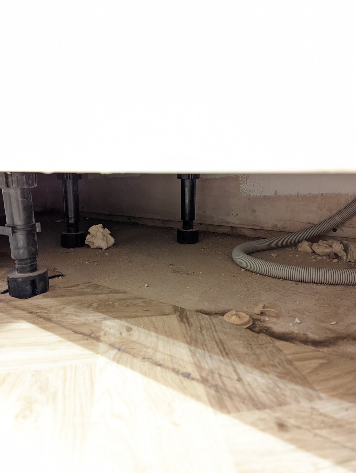

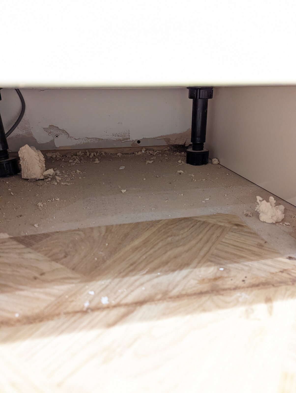

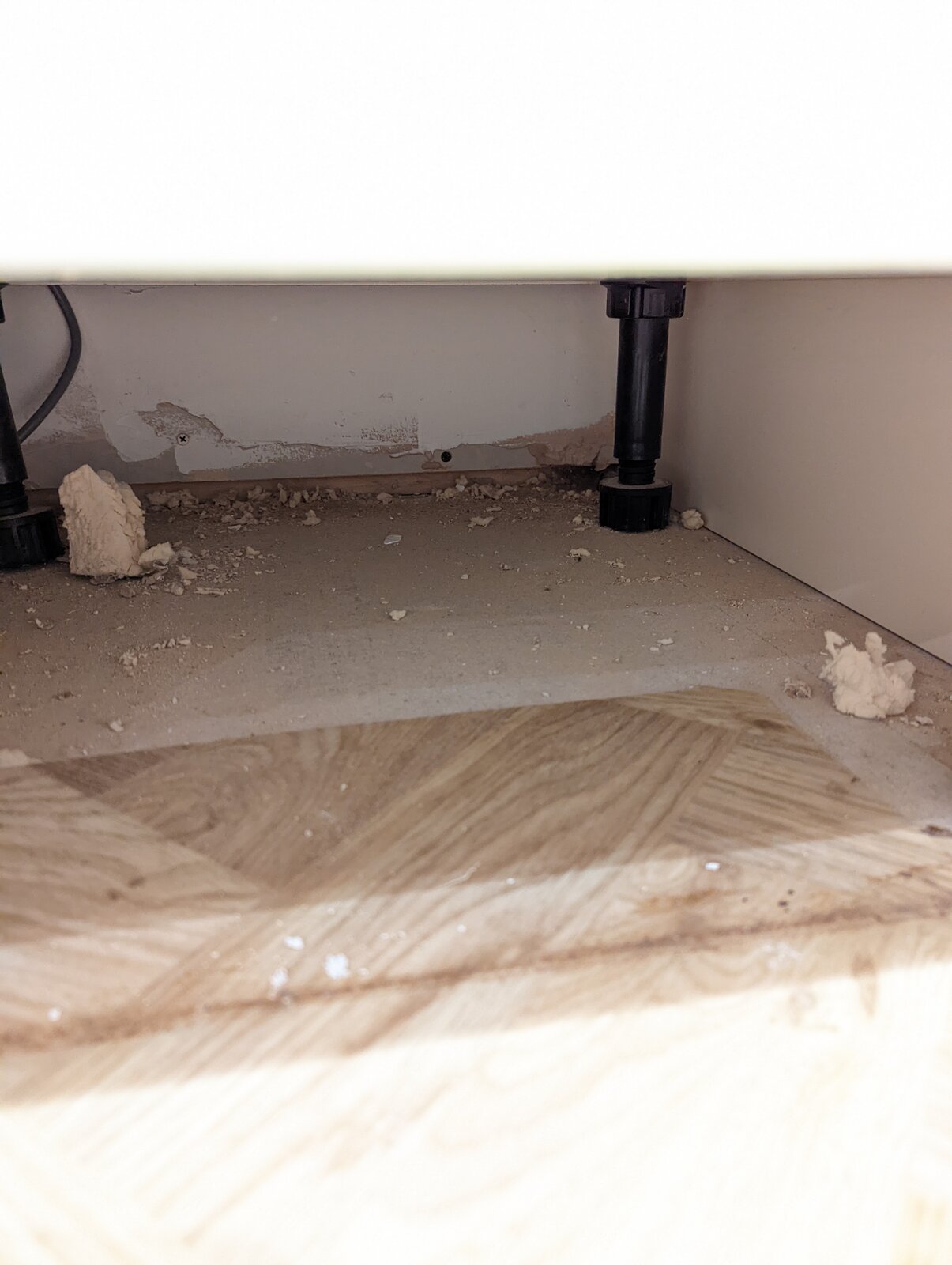

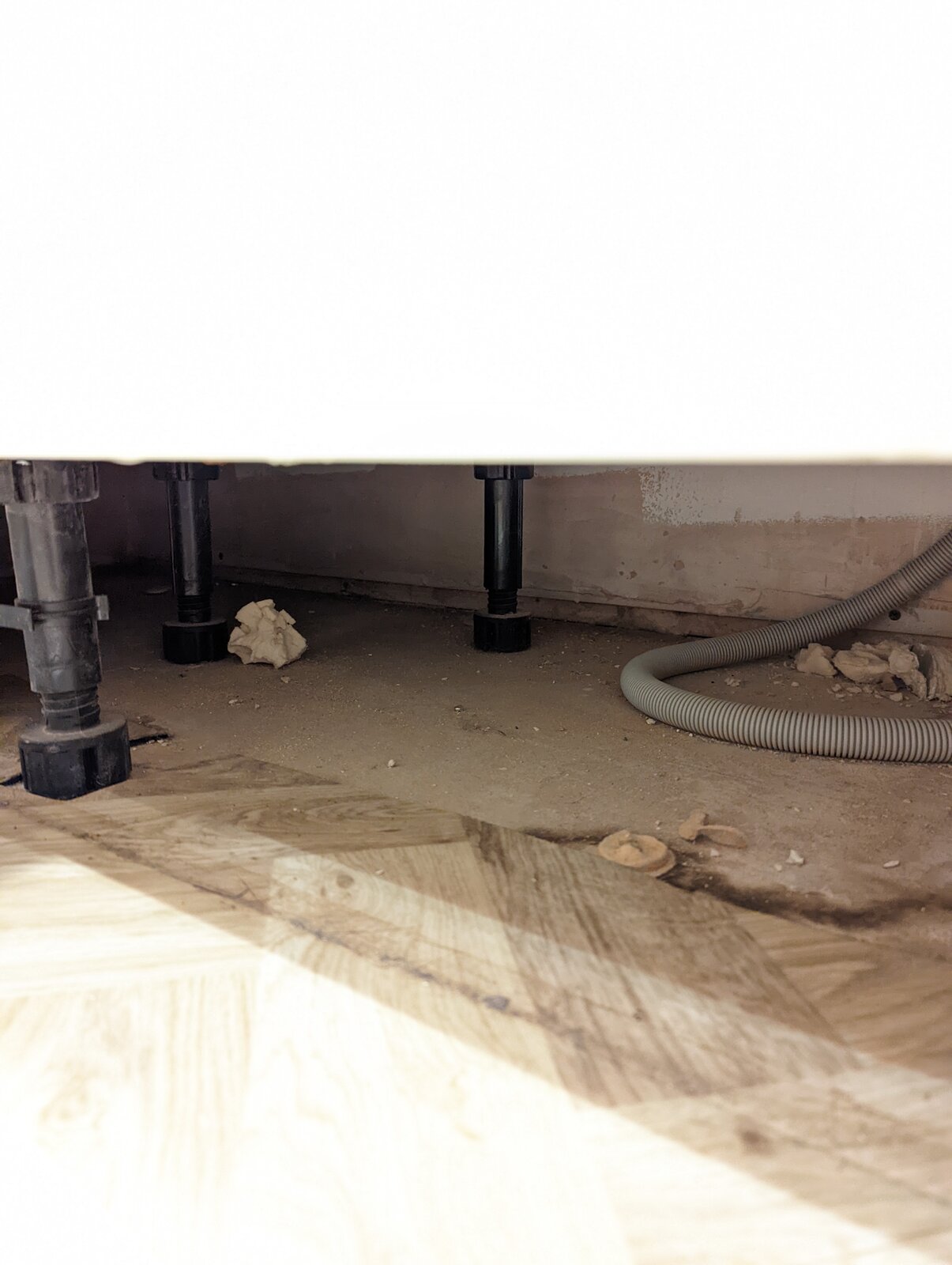

It's lacquered. Looking under the cabinets I can see it looks like it's a plywood floor underneath the laminate that is currently there.

Looks like chipboard. You will need to plywood it if it is to glue the wood down.
