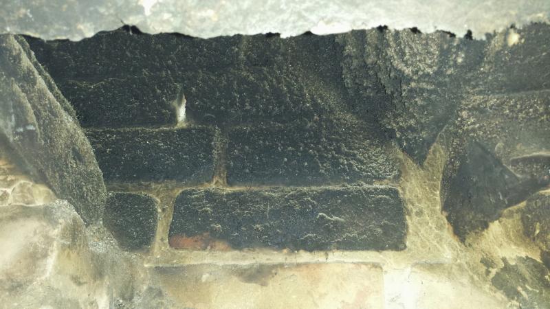

We were under the impression when we bought the property that there was a cast liner in the chimney (see attached HETAS Cert image) but when I took out the register plate there seemed to be a definite lack of any flue?! (see more images)
To be honest im a bit confused, I can see ill have to invest in a new flue, but is there a possibility the HETAS engineer is referencing something else in the certificate that im not seeing?
