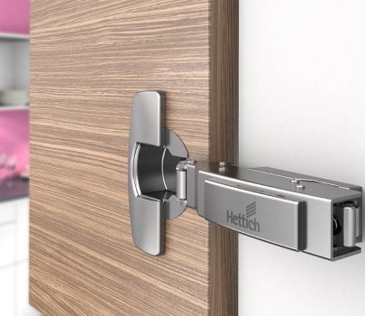

That type of restrictor is for the Hettich Sensys style of hinges, like this one:
These are a specific type of hinge, most with a self-closing feature (hence the need for a stay). Your hinge is not a Sensys-type hinge, so probably isn't compatible.

Yes. As I said, the clips are specific to the Sensys hinges. They may or may not work with other hinges - but probably not as hinge components tend to not be interchangeable between ranges

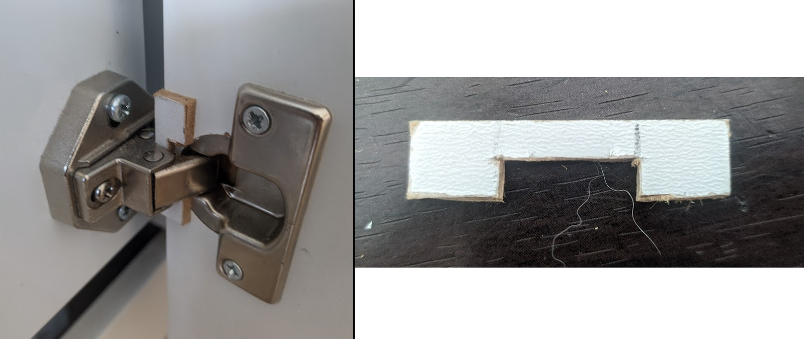

I have exactly the same hinges. I solved it in a much less aesthetic way. I cut these shapes out of a 3mm HDF sheet because I had it at hand. I put them under the hinges and it sticks without screwing or gluing.
I have exactly the same hinges. I solved it in a much less aesthetic way. I cut these shapes out of a 3mm HDF sheet because I had it at hand. I put them under the hinges and it sticks without screwing or gluing.View attachment 278430
Thanks for that my door has slowly gone back to opening fully so I might give this ago.
