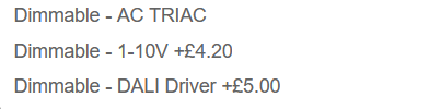

The LED tubes I bought had switch mode power supplies built in so it would auto compensate for any volt drop across a wire wound ballast (choke) so any attempt at dimming would not work. The one you have linked to is however designed for a HF ballast not a wire wound, and it does say "Dimmable Yes – Check ballast compatibility" it also says
and says
So it seems down to the ballast, and we have no details about that, as @flameport says the DC may be for dimming control, or it could be as I thought for emergency use, but I would not be trying to use a ballast designed for fluorescent with a LED tube unless I had some thing like a theatre with loads of dimming fluorescents already fitted. It is clearly a special tube, and it may work, but not really worth the hassle unless you already have loads fitted.

I did check this compatibility sheet (p35) to ensure this ballast “HF-R 158 TLD EII” would work and the diagram in the first post was its wiring diagram. It is specified as the only compatible dimmable ballast for that tube and specified as AC input. Which is the reason for my confusion and my question/post here. I guess the DC input is for emergency power as it can be used for emergency lighting, I am hoping it’s not a DC control input for dimming otherwise it’s return time….

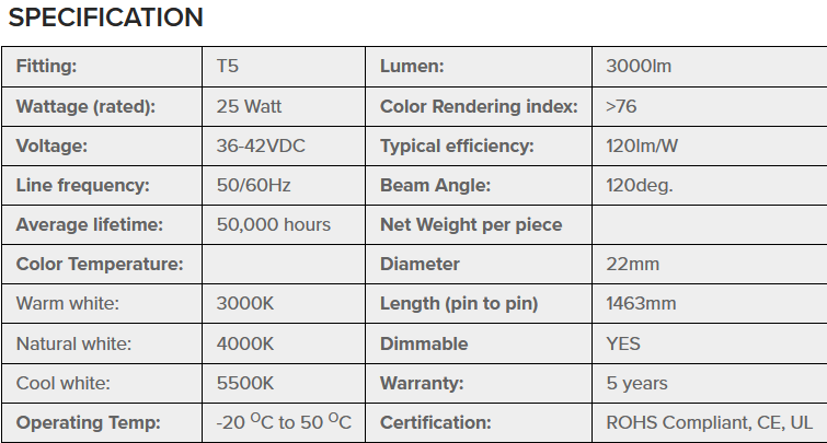

Some thing seems wrong
how can the voltage be 36-42 volt DC when the line frequency is 50/60 Hz? I note one has to select options, so maybe 3 different tubes
but I hope some one can work it all out, maybe @flameport can, but it looks like double Dutch to me.
