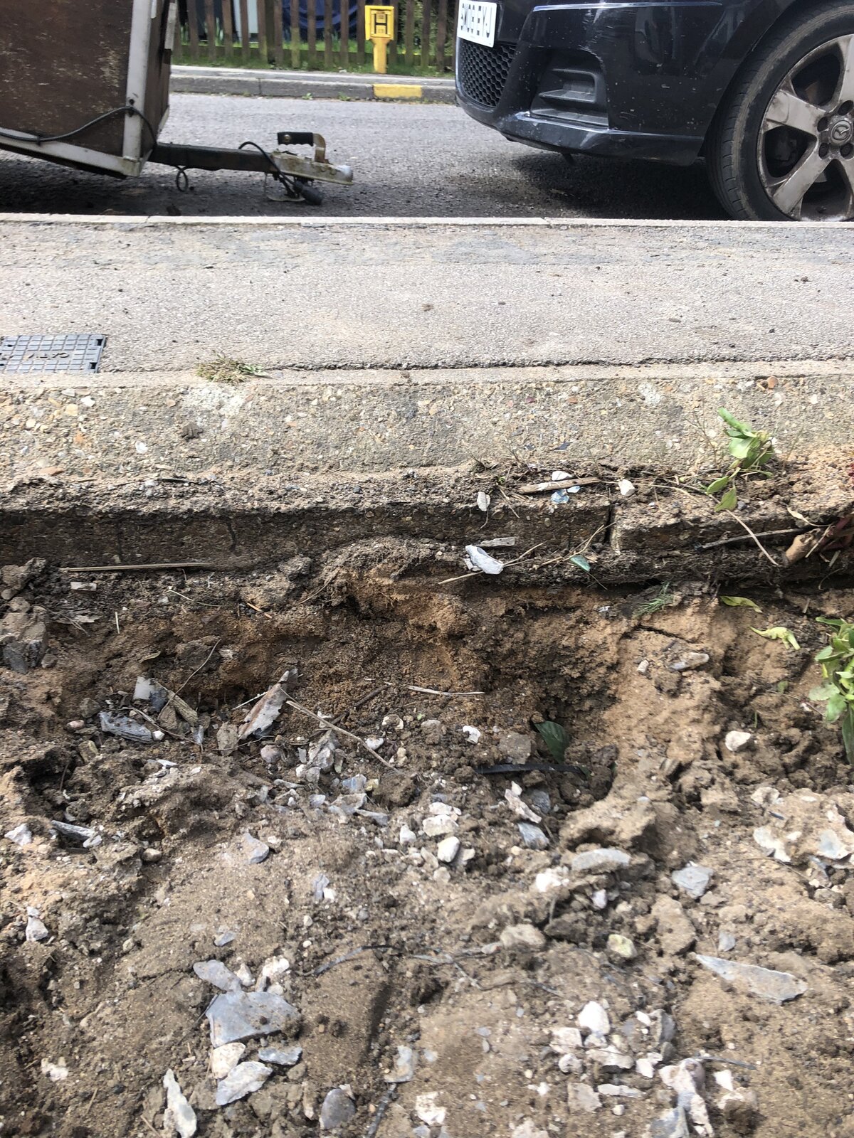

the pic is the level of my garden with no digging lol I would like the end level at least somewhere near to the pavement level

just dig down till you hit solid, hard ground - it should be clear the difference between top soil and load bearing ground
watch out for services - they could be at 500mm down
If you have to go down a long way, you should concrete fill the trench as high as possible - when it comes to free standing walls their height is measured from the top of the foundation, not the ground level. If you had to excavate 700mm and build off a 200mm strip you'll effectively have a 1.5m high wall.
If you find decent ground around 5-600mm and your trench is 450mm wide you should find that 1m³ of ready mixed (generally the minimum volume that most barrow mix companies will supply) will fill it perfectly. And you won't need to be laying in the trench, which is hard work!

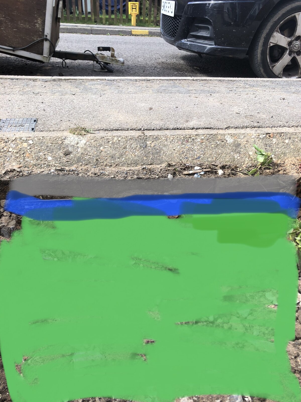

thanks for that, I was thinking about mixing it myself and trench filling it and even putting some shutter boards above ground to bring it just below the path height… the section of where it would be shuttered would be filled on the other side with type 1 and sand anyway… would that be ok to do that ?
I don’t suppose you know how many ton bags ballast and cement I would likely need?
On the pic
The blue
Line would be the shutter board and the grey where concrete foundation would come up to

Lols. Total length of the trench (in metres) x width of the trench x peg depth. For example a 6m long trench at 0.45m wide and say 0.3m deep concrete (pegs) would give you the volume at 0.81 cubic metres. This would equate to 1.5 tonne bags of ballast and about 11 x 25kg bags of cement.

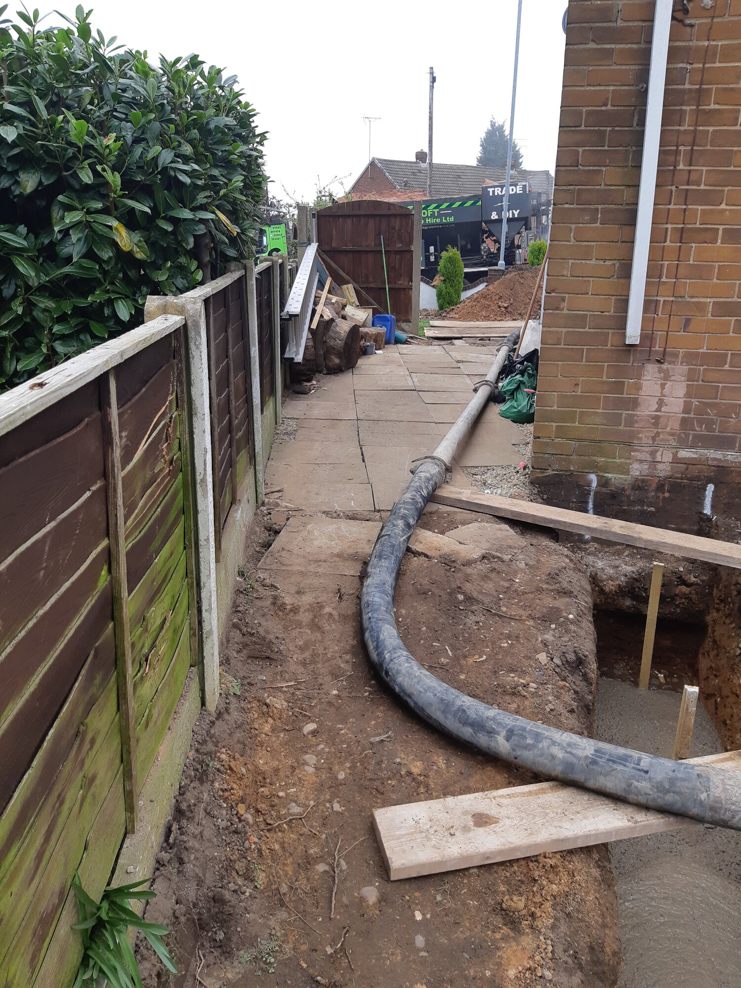

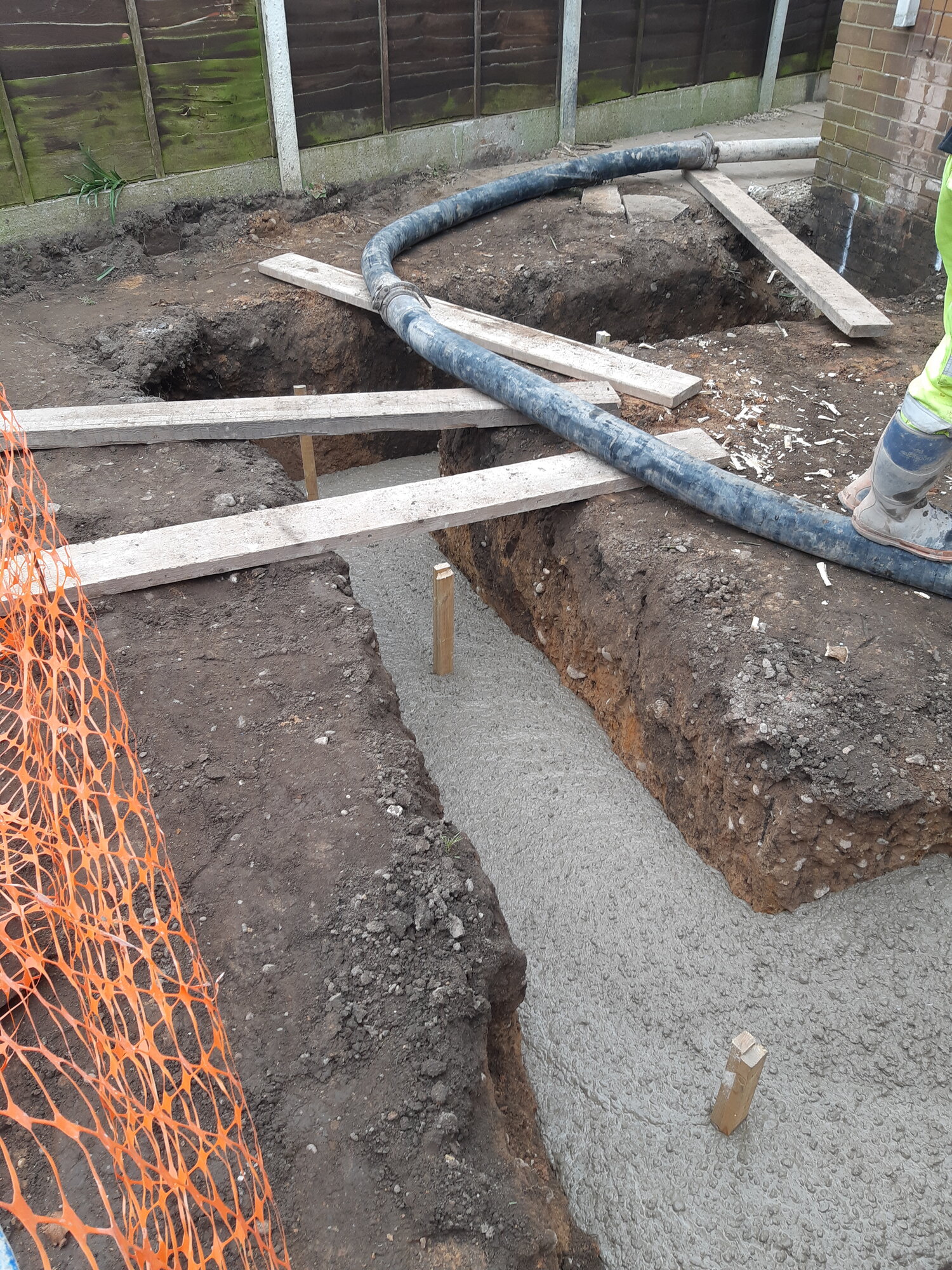

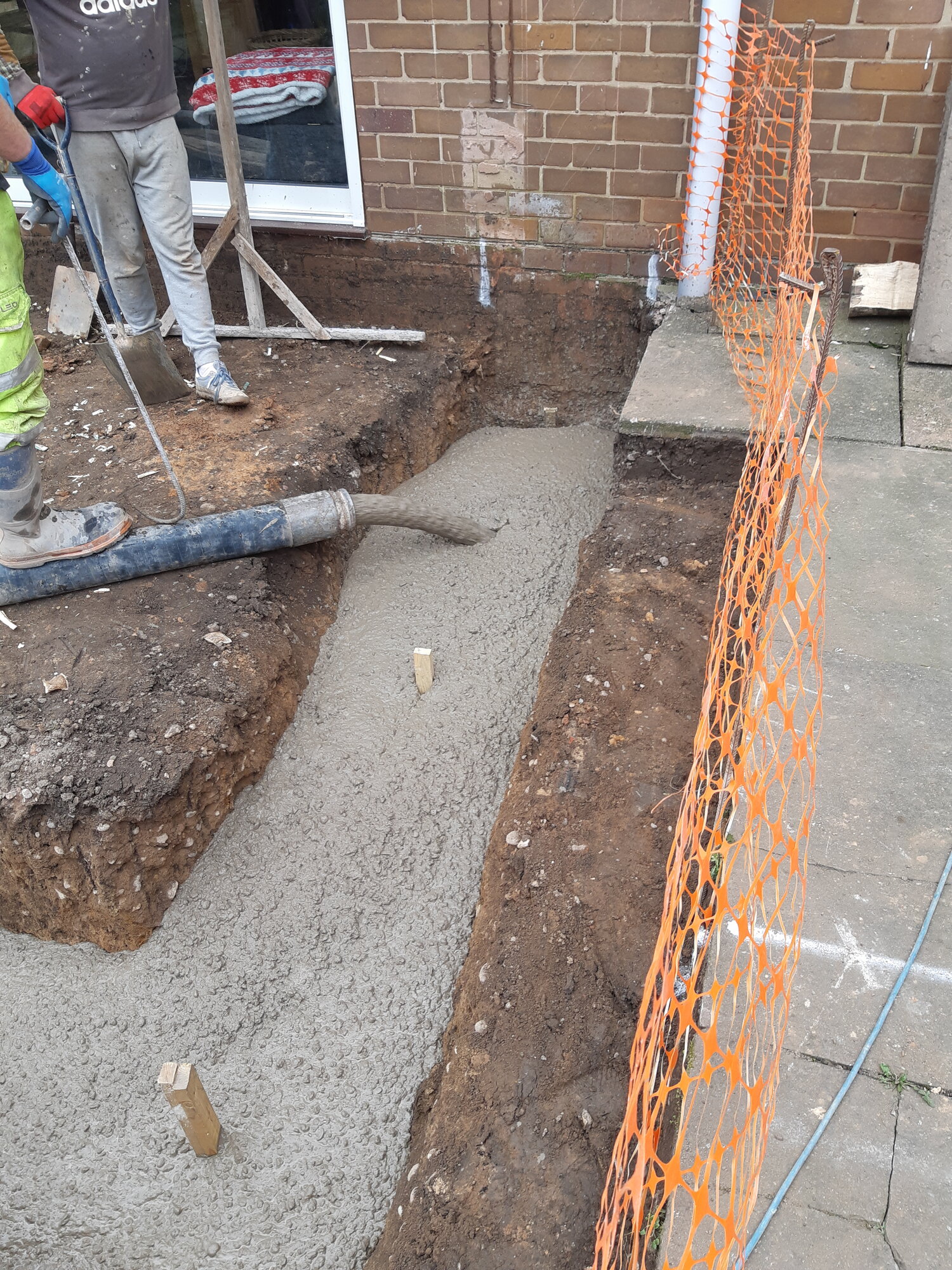

We only ever use volumetric AND a pump. Our latest wee extension...
It makes a lot of business sense for a builder. With a pump, you only need one guy on site and it’s all done in under an hour. Otherwise it means 3 or 4 guys barrowing, then clean up. The frustration I would get is when the concrete delivery got delayed for hours - often meaning guys on a site with nothing else do - theres bugger all to get on with on a site with open trenches
I used to pay about £350+vat for the pump, although mixermate have a volumetric truck with pump built in - that’s the way forward, all one machine.
