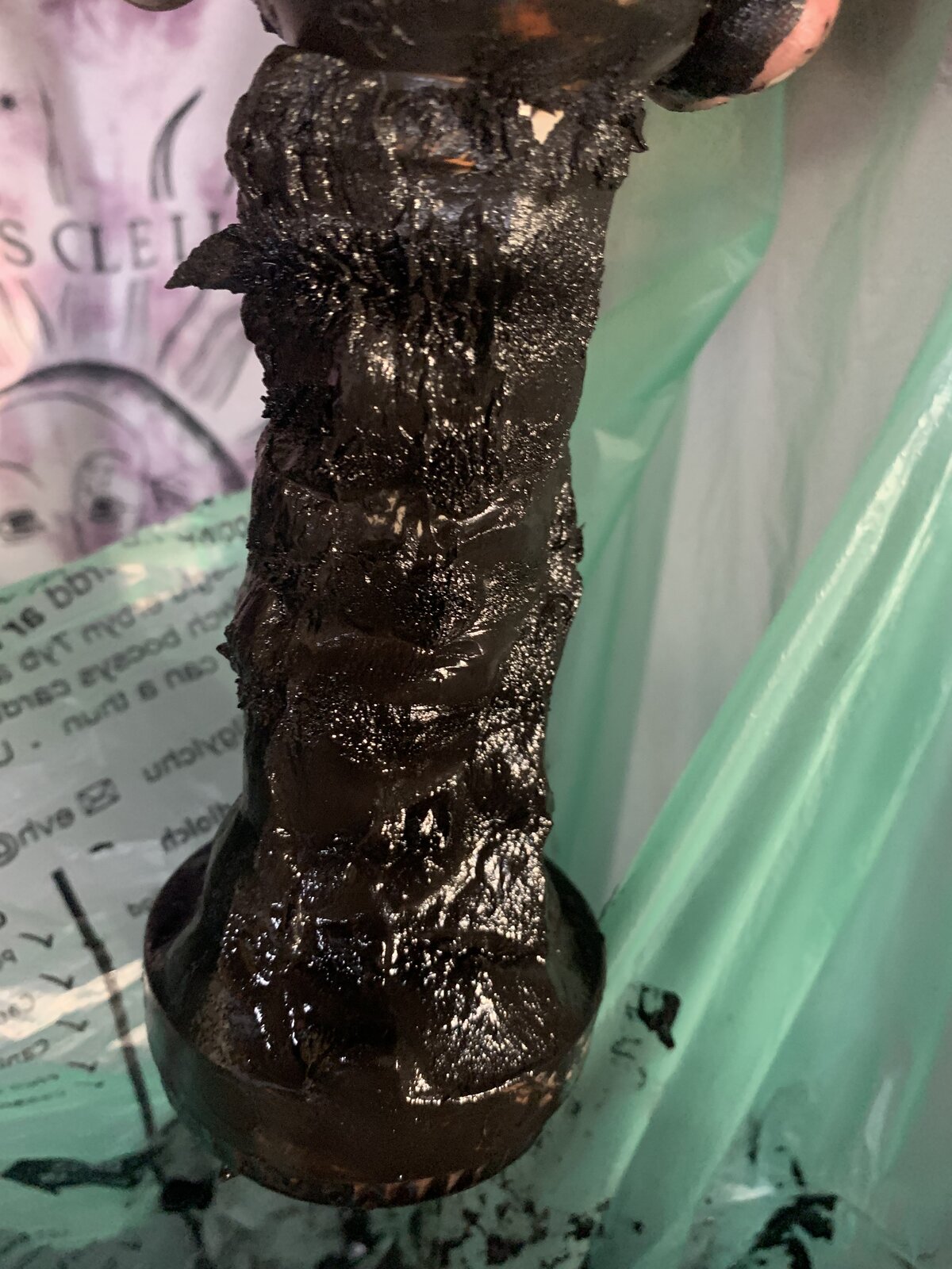

Reason I mentioned IG a Plumber recommended it to me had problems with current vaillant heat exchanger blocked had system power flushed and then it blocked the second heat exchanger. I have 10 mm micro bore to rads been told to use magna-cleanse on system I have a magna clean filter fitted now, system is blocked now my rads are Luke warm B G look after it on contract engineer told me need a new thermostat yet it turns heating on and off but luke warm top of rads

Sounds like the powerflush wasn't done correctly if you're still getting blockages. Thermal stores run too hot for modern boilers to be efficient so a combi would be cheaper, but you need to get that system properly cleaned out before you contemplate fitting a new boiler to it. Ideally the Boilermate should be drained, isolated, and bypassed to do this as they tend to be full of sludge and are very difficult to flush. There's a reason thermal stores are often known as sludge buckets

I would instal a megnaclean (Adey). This filter is by far the best one for catching muck
With the Boilermate, check the boiler connections to it. Are these hot? The cylinder controls the boiler. As Muggles says, there will be plenty debris in the Boilermate. I would be tempted to fit a larger Adey filter to intercept the muck moving from the cylinder to the boiler and clean filter every week and take it from there. These mag filters are good- this is from personal experience
I have Adey Magnaclean fitted the muck you can see on it !! I hadn’t cleaned that filter out for sometime as we have B G contract thought that they do that when servicing boiler ? there is now hardly any thing on magnet a week or so later but going to have 2 XP 28 mm fitted the bigger version once I have system sorted and prior to a refit.
