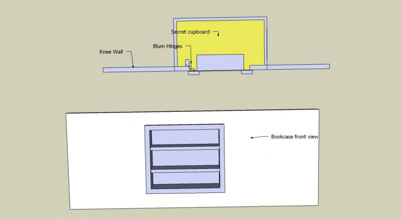

Hi guys,
Ive been asked to make a small shelving cupboard with doors which will be cut into the eave space, this is in a dormer roof space so its already finshed etc
The cupboard is going to house a security system and monitor and the customer wants this to be lockable and and as inconspicuous as possible. He doesnt want mouldings or architrave, so the doors will have to sit flush to the existing walls.
Any ideas on how to create this look?
cheers

The only way I've seen doors hidden (sucessfully) is behind panelling, as the vertical lines of the panels break-up the obvious lines of a door.
Yea, id agree handyman, trouble is the walls around 6m long and the cupboard only needs to be less than a m/2 so would be alot of work and cost.
I was hoping that someone would have a clever Idea ive never seen or heard of :confused:
The problem you will have is hiding the lines of the door, if the rest of the wall is painted with no pattern to disrupt the lines.
If you can't hide the lines of the door, then you'll have to consider covering them. A picture/mirror have been mentioned above, but what about a radiator/cover - something you'd expect to find at that height?
Yes the lines of the door are a problem, also locking these doors is a problem. Ill have to spk with the customer again and maybe something like a radiator cover will cover up what will then be an easy job.

After a little more thought, a further option - but this is dependant on the available depth of the cupboard.
Create a double door cupboard (not hidden), and create a false back to this that opens to provide access to an equipment space. Another version would be to create the cupboard full depth, and have the equipment stored to the side of the cupbaord behind the wall. Access either through a false side wall opening, or a pull-out drawer. Get the owners to fill the cupboard with the usual crap to make it look used.
dressing table with a mirror on the back that full fuctions as in angles on the arms but removes to reveal a wall with push latches
Al the problem with this Idea is its in a hall way and the wall is only about a meter high before the pitch of the roof comes into play.
Thanks for the suggestion tho :)
Cheers Handyman I like this Idea, this could definetley be the one to go with.
