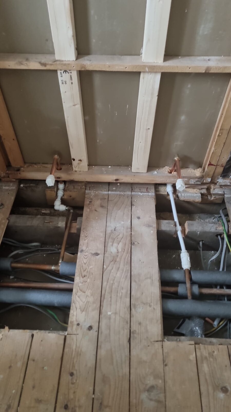

So we got someone out to fit the new pipes for radiator, pipes coming out from cavity.
What do you think of job?
Is this the best way to do it?
Cost was £90 for parts and I think it was about 2 hours.

Unless you specified you wanted it all as soldered copper then it's ok.
Personally as it's gonna be hidden and under a floor I'd have used full soldered copper and had a bend rather than joint in the wall.
Is it pressurised currently? Before you cover it I'd make sure it has water in it and is leak free
As above- burying compression fittings in the wall and pushfits under the floor wouldn't be my first plan. Those notches in the joists are a bit big (but they look quite old so maybe not your handypersons fault).
Have you checked your radiator to see where the brackets go- those studs may or may not be in the right place, consider noggins between them rather than fixing to plasterboard.
I'm sorry but did this person come recommended? JG pushfit is ok and will do the job but looking at the overall quality then whoever did it doesn't seem to be an experienced plumber/heating pro, more a handy man as suggested, either that or they just couldn't be bothered.
It wouldn't have taken much effort to solder all of that. Thought you wanted chrome out the wall into the valve?
I didn't specify what I wanted. I assumed it would all be soldered copper.
Heating is pressured and no leaks.
He fitted the studs and has marked the floor so I assume he's measured it for the radiator bracket. He says to contact him once finished to fit rad.
