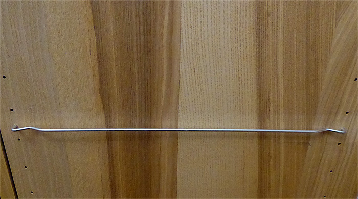

I've been looking for hidden metal shelf side runners as in the photo below.
They are from an Ikea shelving unit, but Ikea don't appear to sell them seperately and I can't seem to find them anywhere else.
Not even sure exactly what to call them, so that may be why I can't find them.
Any help appreciated.
Ok, you did, they look pretty simple to fabricate with wire, pliers and a vice.

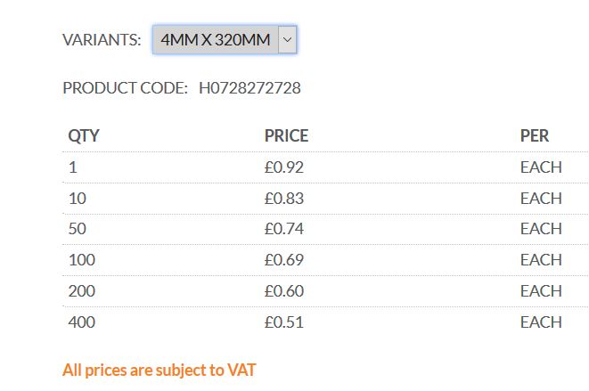

They used to be called "magic wires" or "invisible wires" and the shelf needs to have a stopped groove cut in both ends to accommodate. Woodfit used to be my source of supply. These days try Unico, or in my part of the world (well almost) A C Sissling in Bradford

They are 3mm thick, so thicker than most coat hangers and need to be a precise fit. They aren't that difficult to find if you know what they are called
£10 each! wow.
