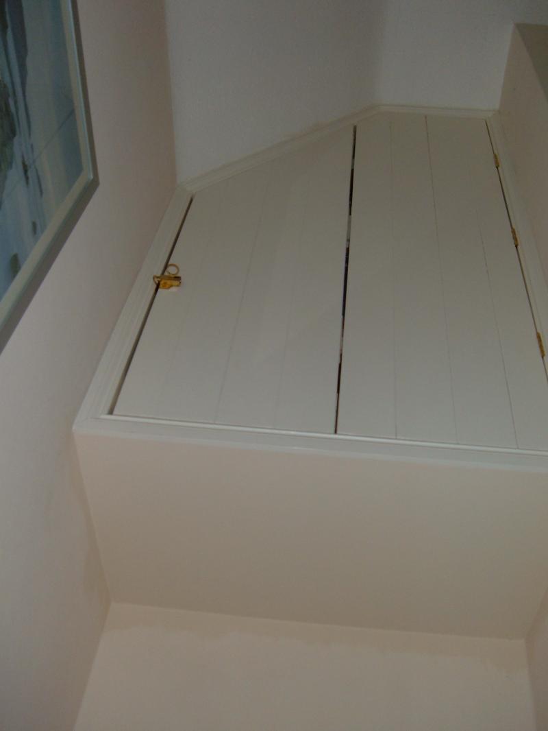

Hi all, hope this is the right section.. was going to put it into plastering but I guess it's building in a sense.
Above the stairs is a huge open ugly space which I want to get rid of, the house next door had this done as can be seen in pictures. I'd like to have a go myself, how would you guys go about it? all I can think of it 2 long runs of wood then plasterboard then skim.. not sure if that would be a good way though?

Did this in my house years ago. As you've suggested I used a long length of wood either side plugged and screwed to the walls and then cross pieces approx every 3ft half jointed to these side timbers. Then plasterboarded and skimmed over after (in my case) adding a layer of insulation above the plasterboard.

Couple of firmly fixed sturdy battens either side as supports and across the back and front then fix 9mm ply on it and trim underneath with thinner ply or plasterboard to hide the supports.
Build a frame and pop on some doors .
I have attached a rather poor shot of the one I built over my stairwell.
Can't get far enough back for a good shot because of a turn on the stairs but it gives an idea.
The one on mine Bi-folds in the centre to allow you to pass when it is open but you would just have a normal door I should think.
As you can see the magnolia paint underneath did not match too well but that job is a long way down the list!
Or if you'd like a lot of space for stuff you don't need to get at very often - Xmas baubles, suitcases etc, build it like the green one, but hinged on the lower end, horizontal battens on the walls level with the top step (which you already have?), make the "door" strong enough to stand on, and put shelves in the cavity.
Looks and sounds great, but not sure it would be used so might be wasted effort. I'll stick to just hiding the large space I think.
