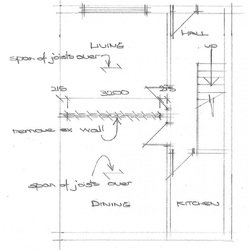

I am knocking through a supporting wall between my living and dining room in my 1930's semi.
The wall only supports the wall above, it does not support the floor joists.
I don't want any visible nibs and I want the beam to sit between the ground and first floor.
My idea was to insert one end of the beam into the party wall but not sure how I can support the other end without having a nib.
How can I knock through and keep the walls seamless and hide the beam?
I called a structural engineer but he would only agree to plan for nibs and wasn't interested in getting involved otherwise. Should I take his word for it? I will spare no expense to have a seamless solution.
I was hoping another beam could be placed in the wall at the opposite end to the party wall and then have that beam support the beam which spans the room.
plans? drawings? anything worth a thousand words?
sorry for the lack of detail in my question. please see plan below...
Rebuild that pier in more suitable bricks or replace it with a column, or span a single beam over both doorways. And I'm not an engineer, FFS.
1. You don't need a pier in the party wall - a simple padstone will do there;
2. As suggested above, a second steel beam (5x3?) across both openings will take some load off the brickwork between the doors, and re-distribute it to the brickwork either side of the doors. Simple, really; the SEs you've spoken to want to think firmly within the box.
