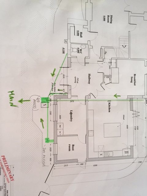

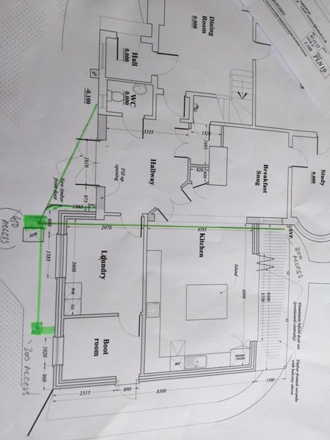

With the above points taken onboard and laying in new pipes for an extension how does the following look?
Happy to consider anything trying to avoid unsightly pipes up the front is my main priority.
Not quite sure which way the drains are running, but I will assume given the angle of the lateral into the chamber from the ground floor WC, the flow is from Right to Left on the drawing. Given that, the soil pipe shown at the rear will likely be the highest point of the system anyway, I'd put the vent there at the rear.
This would remove the need for a vent at the front, (fit an AAV at required height to cap the stack there, and tidy things up). Rainwater I would keep separate to ground level, then connect into the system (assuming this is allowed), via a trapped gulley.
Connecting rainwater to the stack will allow the rainwater outlet to act as a vent, and there is a risk of it filling your loftspace with obnoxious smells. This is why a vent should always terminate above eaves level.

I added the flow arrows to assist.
Regs state the head of the drain should be ventilated, i.e. the highest point, which looking at your drawing, will be the soil pipe at the rear. As long as there is on event on the system, its not too important exactly where it is, as long as the system can breathe at some point.
Thanks Hugh, I think I'm with you now.
I can vent at the rear and have two AAV's at each front bathroom. If I feed the rainwater into the drain at ground level maybe I could add a p trap to avoid smells?
