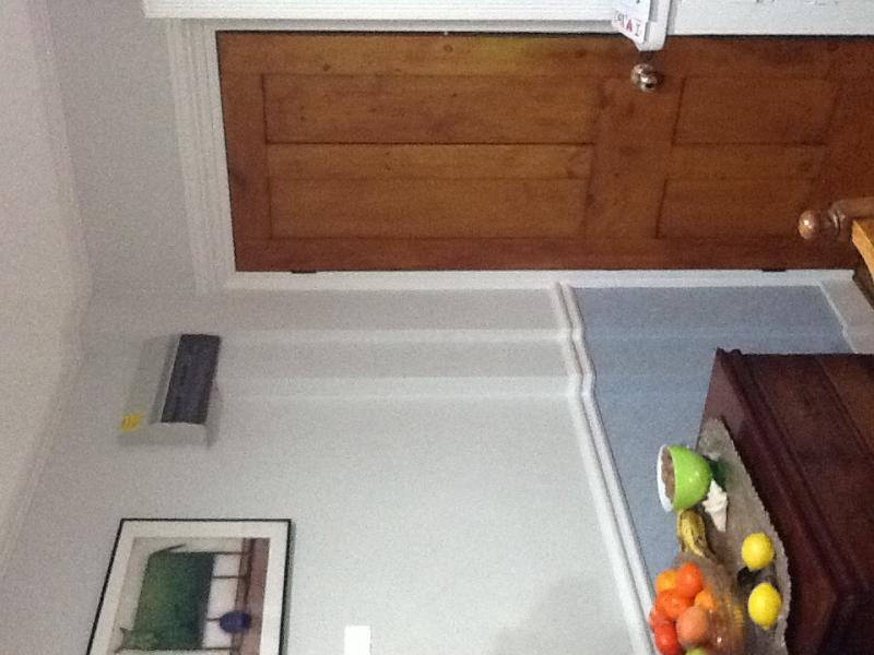

An example of boxing in, there are 3 risers.
Under the cu is electical, and in to the corner is ch / wet services which is sectioned in two for data, BT, and TV distribution.
There are pinned in panels that can be removed along the sections to allow for additions. Although when I do access them I have to spend half an hour giving them another paint coat.
The panels are away from the picture and dado rails, and skirts to make sure they don't have to be mucked about with.
Sorry for some reason the picture has uploaded from the iPad on its side.
And of course, if you didn't want the extra bother of pulling out nails and re-painting, you could fit a dry-line box into the wall, with either a blank plate over it or even an actual working socket, so by loosening two screws and hooking the box out you have instant access.
