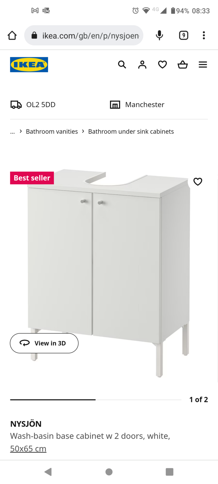

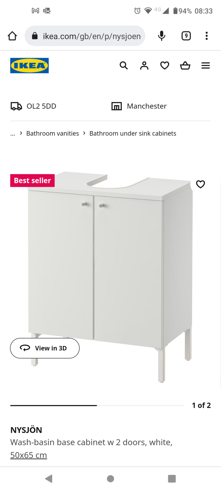

Careful plumbing- so the waste and supply pipes all come up within the base of the plinth, use a compact U bend and don't have a mile of slack on the flexis. Vanity unit is much nicer and makes good use of otherwise dead space.
My gran used to hang a piece of curtain around the pedestal base; maybe you could do something like that?
You can buy some "naff" freestanding units that fit round the pedestal - probably about as naff as sticking bits of plastic round it but cheap and cheerful.
Yep, had one of those and as you say - totally naff. I gave it away.
