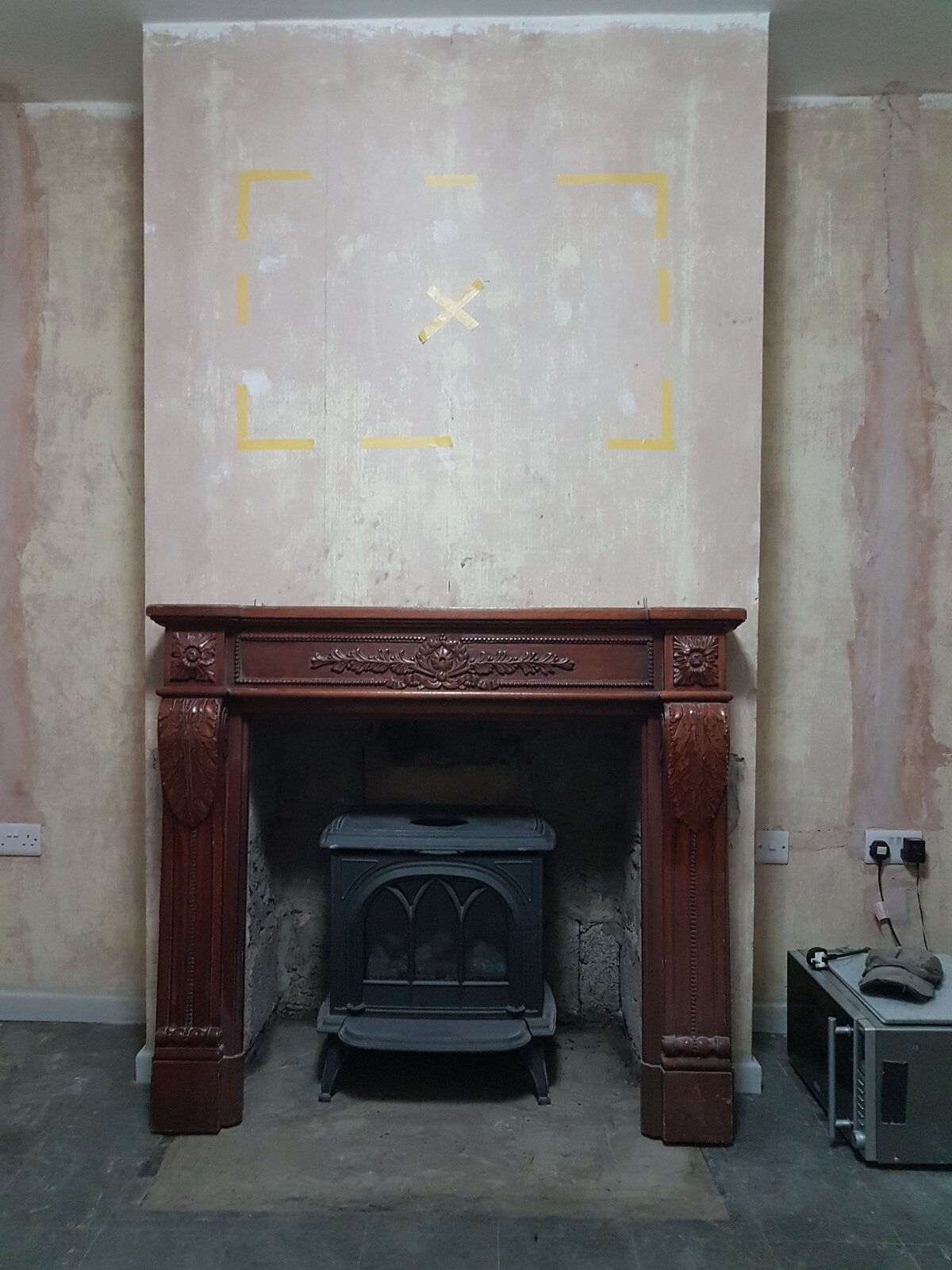

Hi, would appreciate any advice on how to hide wiring for TV mounted on chimney breast, as shown in picture. Virgin/Sky box will be located at side of chimney in cupboard/shelving. Soundbar or speakers possibly either side of chimney??
My thoughts are:
Drill through side of chimney (possibly angled up) for hdmi/ethernet cables in some conduit. Double socket (for fire and TV spurred off from fused spur - is this okay?) hidden at rear of electric fire for tv power cable or behind TV
Or
Batten and plasterboard front of chimney, which would create a cavity to run cables in and again power cable running to either a socket behind electric fire or behind TV
Any suggestions tips would be welcome.
Don't mind chopping out if required but prefer not to

Firstly you'll get neck ache having a TV that high, secondly if you drill in to the chimney, you risk breaching the chimney with your frame fixers etc for the mount and will create a potential fire hazard, thirdly I think your wooden surround might be to close to be compliant, fourthly I think the hearth may be too small.
If you absolutely have to have it there, run it down the side and plasterboard the channel.
For better viewing, I think it is better to have the middle of your telly at the same level as your head when sitting.
If you want a sore neck, stick it above a fireplace.
I suspect that fire surround is pretty much hollow. There's probably a couple of lugs screwing it to the wall.
If it is, have you considered that as a route?

Arounf the centre position of where your tv is going - drill a 25mm hole. Then a hole on the side above or below your plug sockets. Dangle the wires through the front centre hole but cover the connectors in tape etc to keep dust out. Get a metal coat hanger make into hook and hook in hrough the side wall. On the make a little loop on the end you are to catch, drop it down the front of the chimney, hook it on the metal coat hanger and pull it out of the side. Once you have determine the correct lengths, close the hole behind the tv with a bit of foam and plaster as long as you are not putting a gas fire there/etc that is sending up fumes. You closing the bottom of the chimeny hole ie front?
As others have said, that TV would be far better at head/shoulder height. I'd put it on a table or pull-out bracket in the alcove to the right or left. The chimney breast is very often the natural focal point of a room when you walk into it, and you don't want a 50" rectangle staring back at you at that level. I speak from experience.

TV isnt going to be quite that high, it's actually a bit bigger aswell marked it out in a rush last night.
As stated in original post the fire is Electric so no worries over fumes/heat/fire hazard etc and there isn't currently a hearth there
Still have doubts myself about having it on the chimney in terms of sticking out like a thumb, better half is looking at one of those samsung 'the frame' tv's or similar (supposed to look like a painting/picture when not in use?? will leave that with her)

The obvious way would be to cut a chase fit conduit and run the cables in it, the other option is to make a false 'media' wall which seem to be fashionable currently.
Basically get some 3x2's make a frame around the tv, run some more horizontally the width of the fire place and then round the corners, run your cables again in conduit, plasterboard over the 3x2's install some brush plates for the cables, mount the TV in the recessed bit and bobs your uncle, tv mounted, cables hidden, fire place integrity maintained.
