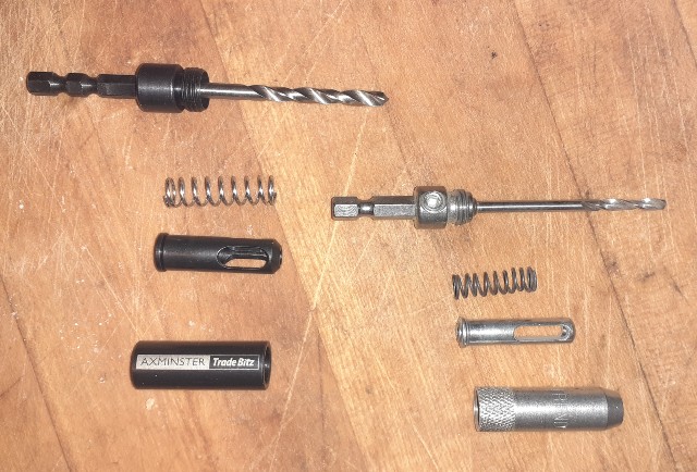

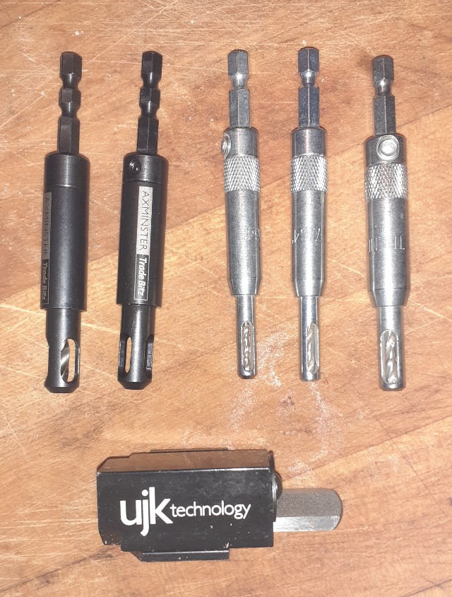

Traditional smaller stamped steel, cast iron and brass butt hinges (2-1/2 and 3in) often used #7 screws. Modern stainless steel fire door hinges are generally fixed in place with 4.5 or 5.0mm screws - the sizes used vary from manufacturer to manufacturer. If it helps the standard sizes for Imperial Vix bits are 5/64in (2mm for #6 or 2.5 or 3mm screws), 7/64in (2.75mm for #8 or 3 and 3.5mm screws), 9/64in (3.5mm for #10 or 4mm screws) and 11/64in (4.4mm for #12 in softwod or #10 in hardwood or 6mm in softwood/5mm in hardwood screws). A set of the smaller 3 sizes with a couple of 50mm driver bits will set you back about £25 on eBay
By now you may be thinking, "Hold on a moment...". Yep, those are the Trend Snappy Vix bits, they do cost more and they are better quality (with spare parts availability) - and those ones are made in the USA by a company called Snappy Tools (the lower cost ones are Far Eastern imports and aren't a patch in quality). Don't know about the cheaper Trend Craftsman ones, but the Screwed-Up ones I had a number of years back were 'orrible. Having got hold of an Axminster one last year (for research, you understand) my advice would be to buy either the Trend Snappy ones or the Axminster ones if you are doing serious work

I think the issue is that the ones I was referring to were the original Snappy range, which have been around for well over 25 years. The cheaper, Chinese- made Craftsman range are a far more recent addition to their range. So sorry if I inadvertently caused any confusion

Above: Left to right - Axminster Trade 4.5mm, Axminster Trade 3.5mm, Trend Snappy 5/64in, 7/64 in and 9/64in bits with UJK square corner chisel below
Below: Axminster Trade 4.5mm (black) and Trend Snappy 9/64in bits stripped down to show components

Traditional smaller stamped steel, cast iron and brass butt hinges (2-1/2 and 3in) often used #7 screws. Modern stainless steel fire door hinges are generally fixed in place with 4.5 or 5.0mm screws - the sizes used vary from manufacturer to manufacturer. If it helps the standard sizes for Imperial Vix bits are 5/64in (2mm for #6 or 2.5 or 3mm screws), 7/64in (2.75mm for #8 or 3 and 3.5mm screws), 9/64in (3.5mm for #10 or 4mm screws) and 11/64in (4.4mm for #12 or 5mm screws). A set of the smaller 3 sizes with a couple of 50mm driver bits will set you back about £25 on eBay
Below: Axminster Trade 4.5mm (black) and Trend Snappy 9/64in bits stripped dow n to show components

I was unaware that Trend do two qualities.
Will follow your advice and either purchase the Axminster ones or the non- Trend ones. I don't hang doors that often but I was taught a long time ago to buy the best tools that you can afford. Neither is particularly expensive, and it had never dawned on me that they would be useful for kitchen cabinet doors until you mentioned it a couple of days ago.

Having taken one apart, it seems that the spring has too many windings, by that I mean that once it compresses only a tiny part of the drill bit pokes out. I still plan to take them back for a refund... but I haven't had a chance to pick up better quality ones yet.
