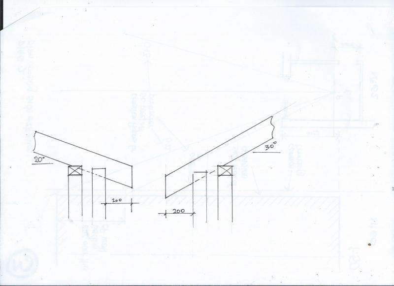

To show diagrammatically the nature of your problem at the eaves, see attached sketch.
With a level wall plate, equal eaves projection and differing angles on adjacent slopes, you can see that the fascias will be at different heights, so what would you do at the base of the hip where the two slopes met?
As ree, the problem can be overcome but it would need forethought and considerable skill - probably beyond diy competence.
And as for the problems with the rafter/hip angles, I personally wouldn't know where to begin :LOL:
