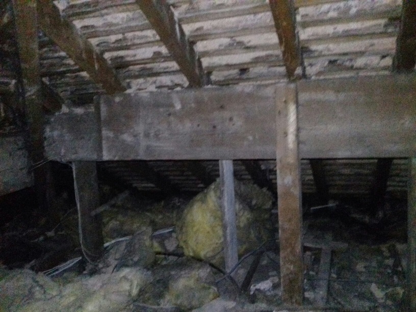

I have a hip roof where purlins are fixed into a wall but the other end has some supports which seem to be supported from an upright which sits on the upstairs joists.

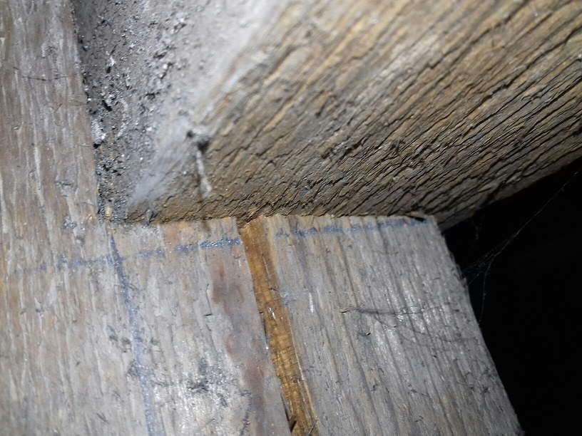

Split under purlin (only one side has split)
Upright

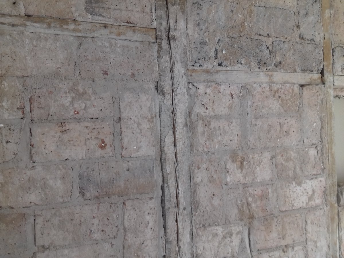

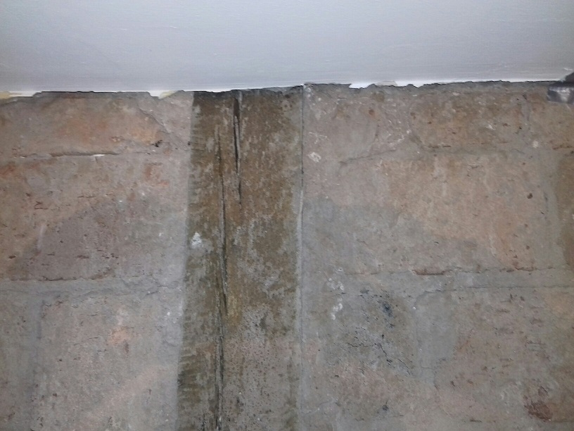

Ceiling from other side

I'm not sure I would do anything about it, a 10mm bolt with large washers
will stop it from splitting anymore.
I did also look at that, with the addition of fresh timber either side but was concerned that the bricks lower down somehow provide support for the upright - even if it stops it bowing.
I couldn't see any other reason for bricks in what looks like a stud wall.
I wouldn't worry about that unless the wall below shows signs of movement.
Ours is very similar, we took the wall either side of the support down and it didn't affect it. It was 4x3 and very strong.
No, not like yours has.
I removed it to put an RSJ below it, built a block wall ontop of that then fixed a new shorter prop on top of the wall.
Spilts or natural shakes along the grain and in the direction of load, are not that significant. You can bolt it or strap it if you want to ease your mind
Its not really a job for a builder though.

1 last thing - anyone know why they use to fill the gap with bricks?
They look more like block paving on their edge.
I have no idea why, probably something they did between lat and plaster going out of fashion and plasterboard being invented.
