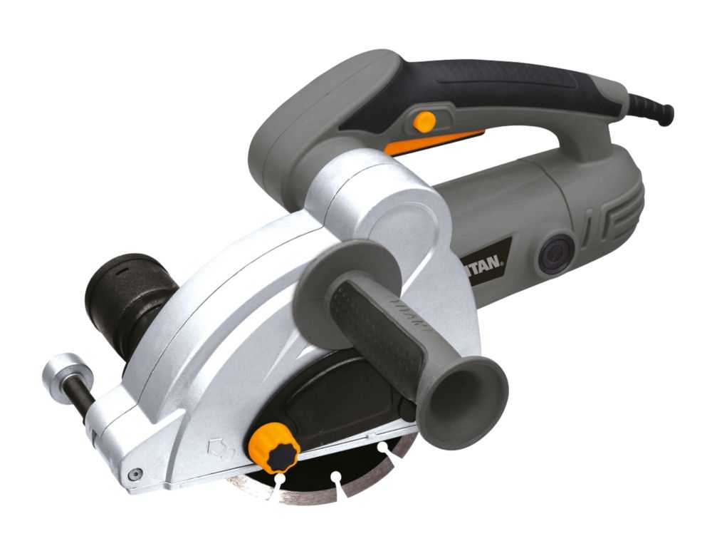

I need to chase 2 plastered brick walls in order to run some 8-core CQR cable.
I'm a DIYer so don't have all the professional gear. Previously I have used an angle grinder for chases and the dust was horrendous. It's a 1930s property and the bricks were super hard.
I still have the angle grinder but I also have an SDS with a chasing bit.
My question is would it be worthwhile hiring a hilti chaser with dust extractor from the hire shop? Probably around £160 for the weekend - I don't know if they'll make me buy blades on top of that cost.
In terms of value I'm interested in the time to complete the chases and how little dust this method would create compared with my alternatives.

I’m not suggesting you should buy this machine, but the reviews certainly indicate wall chasing machines don’t produce much dust
You may not be 'suggesting' that but, if it can do the job satisfactorily ( don't know), then £140 to buy one (and have it for ever) as compared with the OP's suggestion of paying £160 to hire one for a just a weekend would sound like a bit of a 'no brainer'!

Of course the hire one would include a vacuum cleaner. Still I don't regret buying mine.
The vacuum cleaner is an essential part of the dust suppression. You need an appropriate one..the filters on my Dyson clog up very quickly with brickdust, my cheap old Moulinex thing (which needs disposable bags) keeps going for much longer .
Have a look at Machine Mart (especially their Returns corner)- think my chaser cost £40.

I have that particular machine, when connected to my dust extractor, you get a bit of dust on the initial plunge. I am only guessing, but I would say that airborne dust is reduced by about 80-90%.
It is quite heavy though and it doesn't move up the wall as smoothly as some others.
That said, it is cheap and functions well.
It has spacers on the shaft that you can move around to change the gap between the two blades.
Prior to buying one, I built a "dust extraction" box for my angle grinder. I soon regretted not having purchased a wall chaser. With one you end up with two groves at a constant depth and width.
The Titan is even supplied with a flat chisel that you can insert in to the grove and snap away the stuff in the chase.
It is a while since I last used mine, but I would recommend a chaser over an angle grinder.
Longevity wise... I have only done less then 100m. That includes plaster over render
