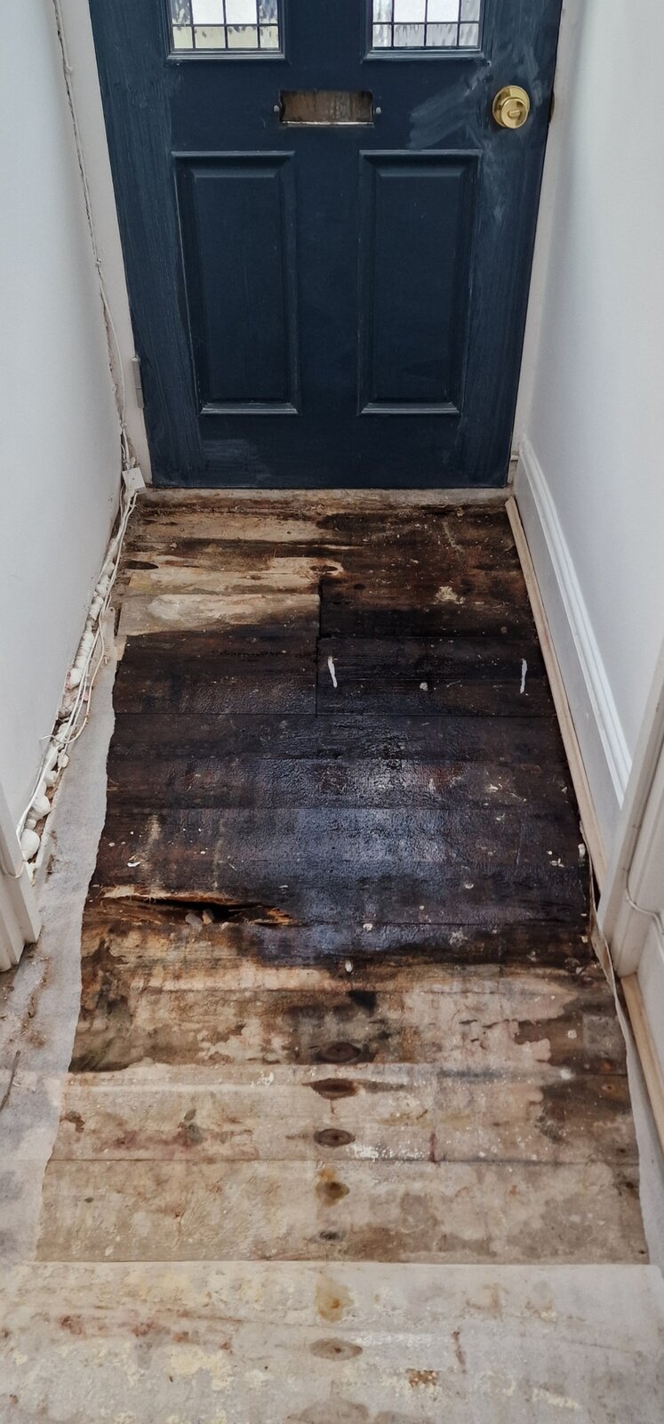

I moved into a house that had a hidden leak. I stopped the leak and replaced the affected floor joists and boards.
Months later the smell remains, but there are no visible signs of concern.
Is this normal? Do I need to treat surrounding wood to prevent smell?
What's going on?

Water supply into the house was under there. It had a pin hole leak that had been spraying up at the boards for... well... a long time I guess.
Just to add more to the riddle, it's the room next to this that smells. I have taken the floor up and there is nothing going on. Concrete foundations, suspended timber floor with no damp or mould anywhere. I've scrutinised under all the boards.
The room is unfurnished
You think it's the wood that smells?

Question. You've replaced wood. What's the picture of then? Looks black and terrible.
Smell could be in sub floor then. Treat that
I can only then the smell is in the wood. The picture was of the before problem. I thought adding a picture might prompt people to reply.
